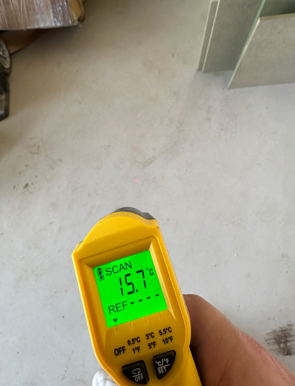

Dave Jones Posted May 9, 2024 Share Posted May 9, 2024 As its actually nice today, tried out running the heatpump in reverse to cool the house. To keep above dewpoint (home assistant takes care of this) set at 16C, had the slab down to 16 within 4 hours and the house is noticeably cooler when walking inside. Have 5 panasonic fancoil units in the bedrooms which will test once the painters are done. 4 Link to comment Share on other sites More sharing options...
