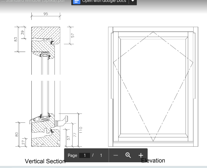

Novice Becky Posted May 8 Share Posted May 8 @craig or anyone. Can anyone suggest a supplier for Illbruck TP654 88mm/6-15 all-in-one tape? Sealants online are out of stock for 4-6 weeks (I need it in 5 weeks). Dortech don't stock 88mm (just 58 and 66mm). Nothing else comes up on a search. I need deep tape as the timber windows are 95mm thick. Thanks Link to comment Share on other sites More sharing options...

Tosh Posted May 8 Share Posted May 8 36 minutes ago, Novice Becky said: I need deep tape as the timber windows are 95mm thick. Couldn't you use a narrower compriband tape and make the difference up with air tight expanding foam? Both more readily available......and possibly cheaper. 1 Link to comment Share on other sites More sharing options...
Novice Becky Posted May 8 Author Share Posted May 8 Thanks @Tosh. You're right - TP654 does look pricey on the surface. I'm going to use TP600/FM330/ME508 on a door but because of the roll lengths it actually works out about the same price to use TP654 on 2 windows - and sounds like a much quicker job and less making good after (this is a retrofit). Good to try something new! If I can't get the TP654 then I'll use Compriband. Link to comment Share on other sites More sharing options...
Tosh Posted May 8 Share Posted May 8 55 minutes ago, Novice Becky said: Thanks @Tosh. You're right - TP654 does look pricey on the surface. I'm going to use TP600/FM330/ME508 on a door but because of the roll lengths it actually works out about the same price to use TP654 on 2 windows - and sounds like a much quicker job and less making good after (this is a retrofit). Good to try something new! If I can't get the TP654 then I'll use Compriband. The expanding tape is amazing stuff, often with a price to match! By the time we're finished I wouldn't be surprsied if we've spent £5-600 on compriband, foam, etc around our doors/windows. How will you apply this very wide tape into a small gap and press it onto the frame? We had mostly 10mm gaps and I found even a 20mm deep tape to be quite fiddly to install, but then the reveals on ours are very deep which didn't help. I found a scrap piece of thin, soft metal that I bent to shape to help press it home against the frame. Link to comment Share on other sites More sharing options...
Novice Becky Posted May 8 Author Share Posted May 8 You apply the TP654 to the window frame immediately before lifting the window into place. And you don't need the ME508 airtightness tape on the inside. https://www.illbruck.com/en-gb/products-systems/product-finder/tp654-illmod-trio-1050/ Installation video see 1m50s I thought I read somewhere that you could also apply the Compriband before installation? I've definitely read that it can be fiddly! But hopefully worth it for airtight windows. Link to comment Share on other sites More sharing options...

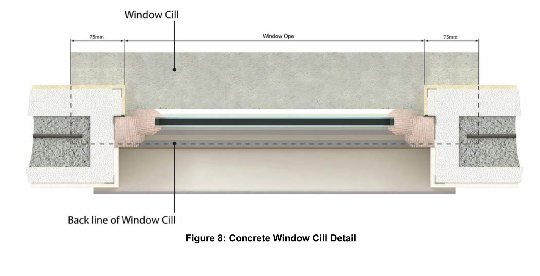

Nick Laslett Posted September 24 Share Posted September 24 (edited) My wife and I did our window installations ourselves using some Illbruck products. We used TP651 Trio expanding tape, which is 35mm depth on 47mm depth window frames. We used the FM330 Pro Foam Air Seal expanding foam to fill the gap left behind the tape. I really rate the FM330 expanding foam. We then used Siga Fentrim IS20 airtightness tape, 10mm on the window frame, connecting across the foam to the ICF EPS reveal. Siga are one of the few airtightness brands that explicitly state their tape will bond with EPS. This was probably overkill, but we wanted to be sure that the windows were airtight. The Thermohouse ICF window blocks have a “Check Reveal”, which means the edge of the window frame is protected by 100mm of EPS. This is another layer of insulation and weather protection. Our renderer then fitted on the outside of the frame a window reveal bead, with a rubber seal. https://ewistore.co.uk/shop/external-wall-insulation/anthracite-window-reveal-bead-with-mesh/ I doubt any of this additional work will be reflected in our SAP score, but I am pretty confident that we have detailed the junction between the window frame and the rough opening in a way to provide us with a lot of long term benefits. Edited September 24 by Nick Laslett 2 Link to comment Share on other sites More sharing options...
