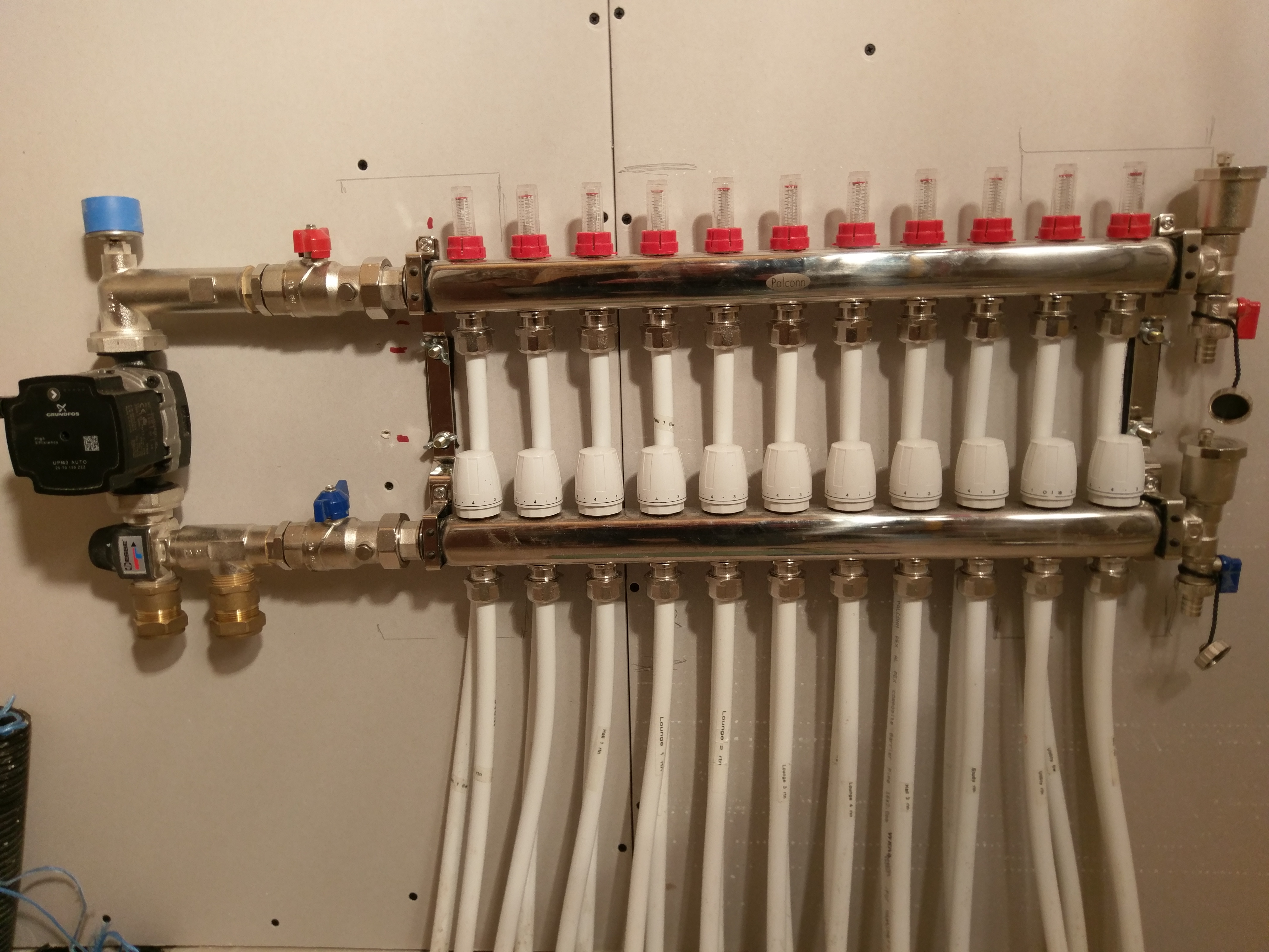

Nickfromwales Posted October 12, 2017 Posted October 12, 2017 On 10 October 2017 at 18:51, dogman said: Interesting as i am currently talking to them as well. Spent a good hour today at their office chatting to Nick and he fully understands the concept of a passive MBC timber frame and heating the groundfloor only. In fact he has responded to the need for a low temp blender valve and can now supply this:- I am taking a slightly different view on upstairs and just picked up 3 fan coil rads from them as i want to be able to cool the upstairs in the summer. How much for that pump and blender set please?
