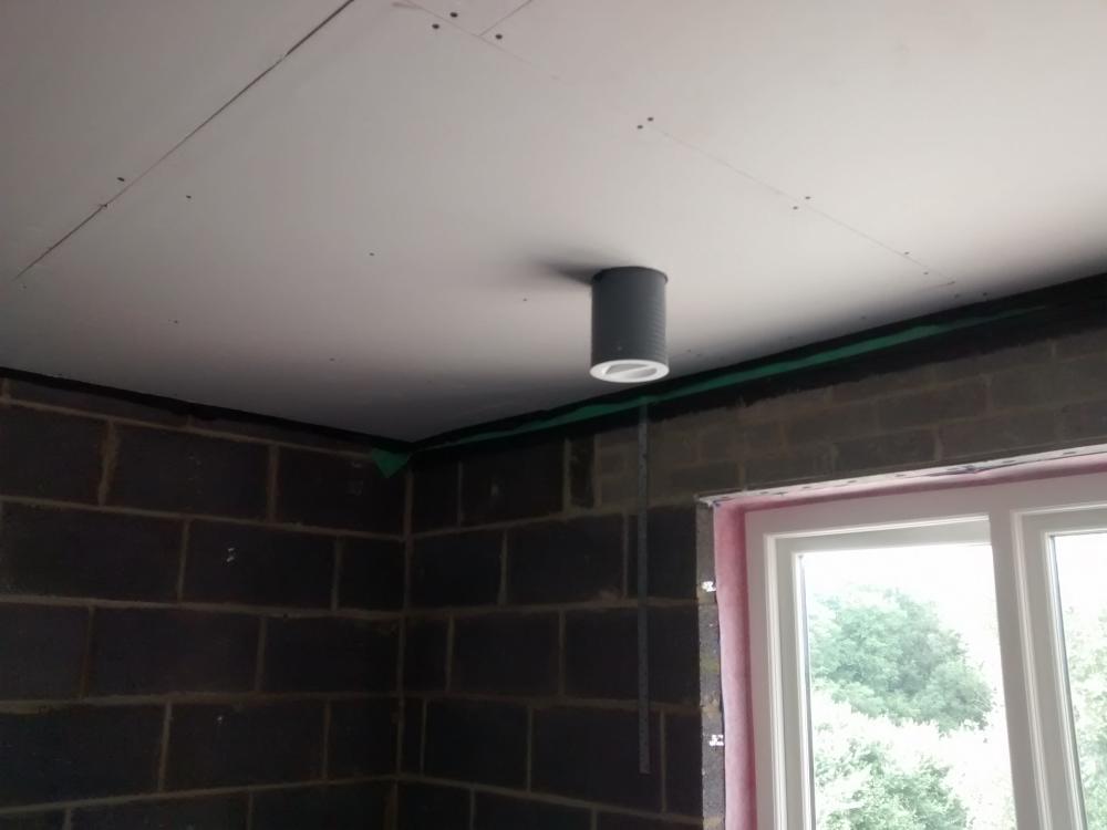

Frogeye Posted July 4, 2016 Share Posted July 4, 2016 I'm not sure if I'm supposed to be joining the end of this pasted topic, but.... When have people trimmed the excess of the plenum off? Some where on the old forum I seem to remember someone suggesting they cut it flush with a dremmel before decorating, yet I've got a recollection of BPC telling me to trim it off after the plasterboard goes on but before the skim coat - which is where I am this evening! Any input would be handy. Thanks. Link to comment Share on other sites More sharing options...
Jeremy Harris Posted July 4, 2016 Share Posted July 4, 2016 I trimmed all mine to length before the plasterboard went up. I just allowed enough for the end of the terminal tube to be around 3mm short of the plaster skim finish. This meant sawing the threaded terminal tubes approximately to length, then screwing them into the threaded mounting plates to get them to be about flush with where the ceiling surface of the plasterboard would end up. Mine came with red plastic caps that fitted inside them and I left these in place when the ceilings were plaster boarded and skimmed. When the decorating was done I went around pushing the terminals into the tubes. There's probably 10 to 15mm tolerance on the push-in terminal fittings, so there's no need to be super-accurate with trimming the end of the pipes. Link to comment Share on other sites More sharing options...

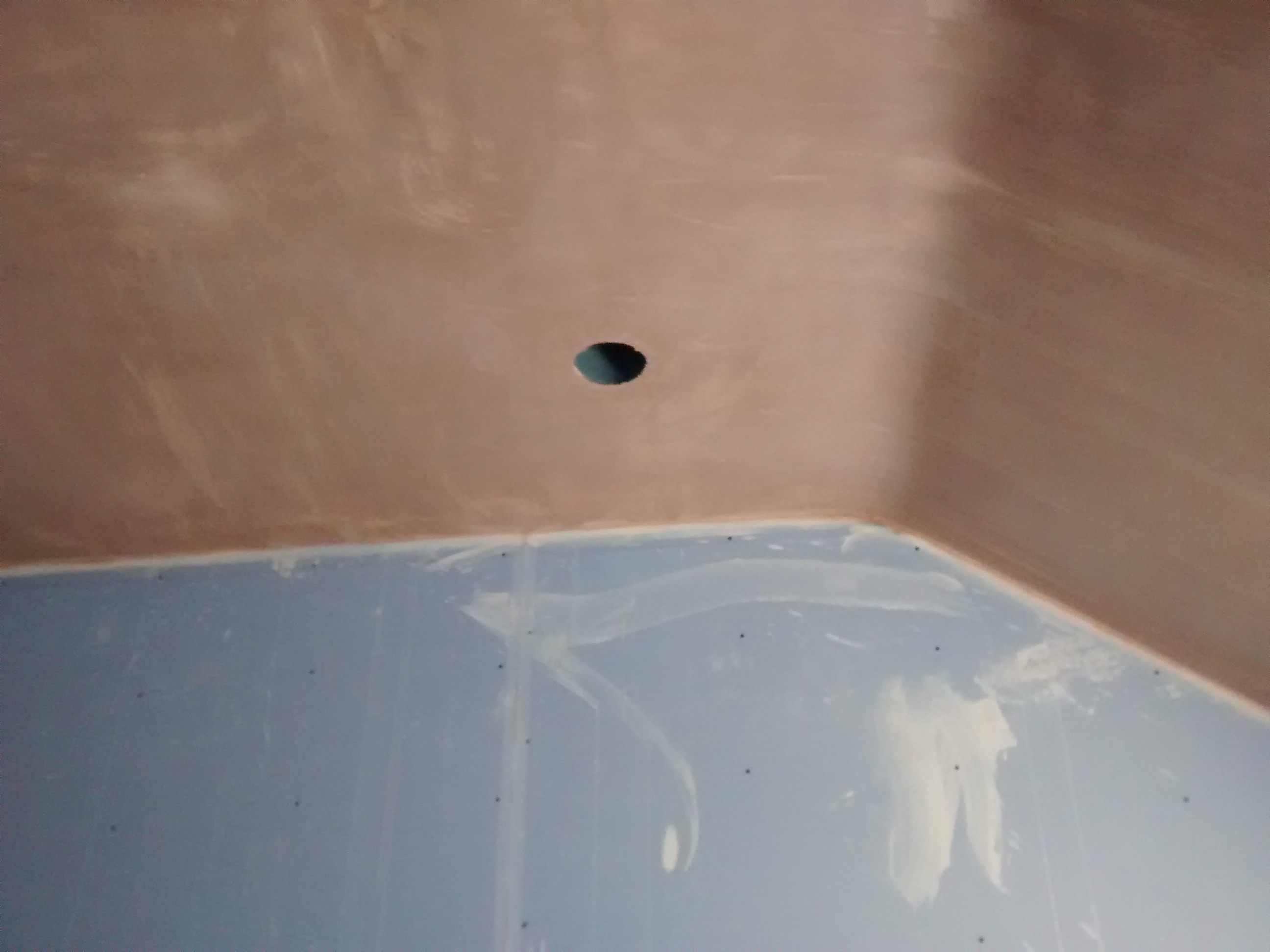

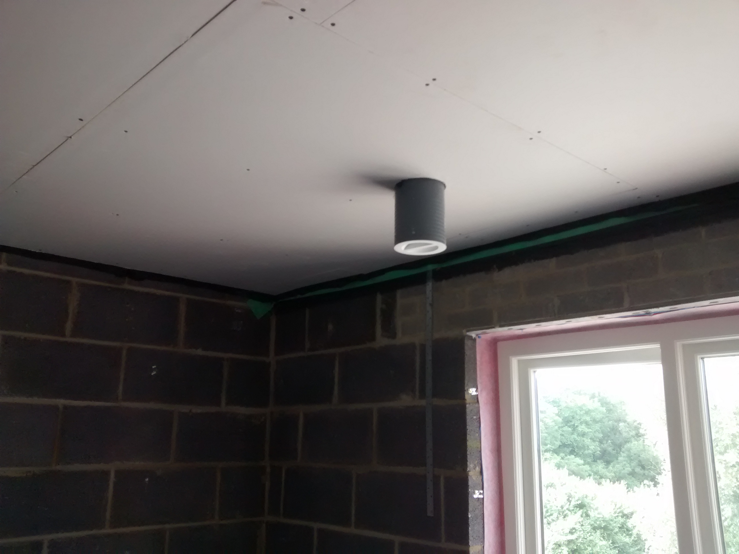

Frogeye Posted July 6, 2016 Share Posted July 6, 2016 I ended up cutting the plenum excess off flush with the plasterboard prior to the skim coat going on (well on the first three done so far at least), I figured this would give me one less tedious job to do down the line. I used a flexible pull saw bought at screwfix (http://www.screwfix.com/p/irwin-pull-saw-14tpi-12-305mm/42618), which made a fairly easy job of it. I noticed that the plasterers had run a lap of scrim around the opening as well (after I had cut it off), which I guess will help, although on the third one (today) I did run a lap of fortax 6400 (sealant) around the edge of the cutout for good measure. A couple of before and after photos (but different rooms!) 1 Link to comment Share on other sites More sharing options...
