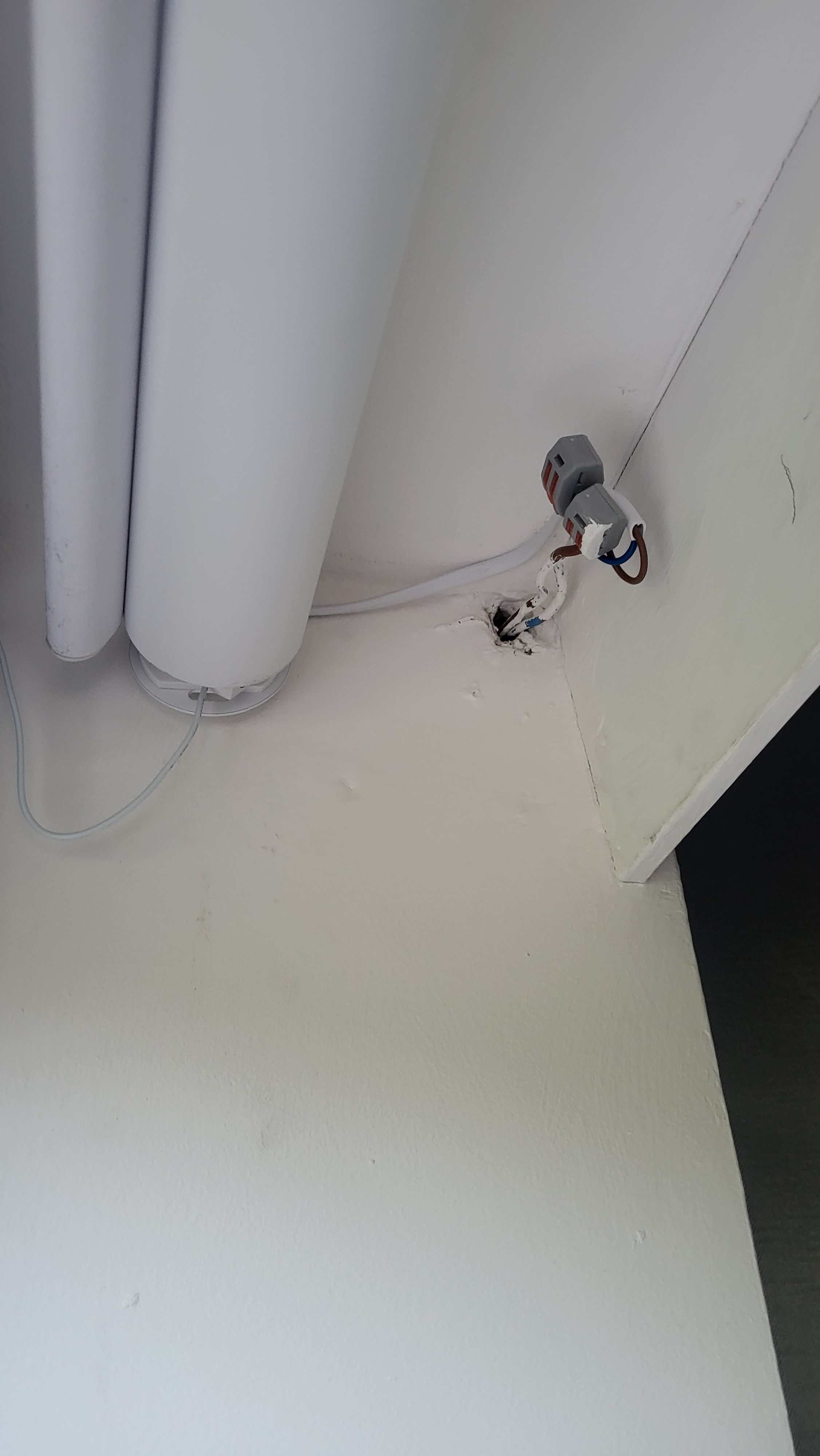

Andehh Posted May 28, 2025 Posted May 28, 2025 Yep, we hardwired all our blinds... No regrets! Just need to tidy it up a bit.... 2 core all that was required. Even if rechargeable is easier having several blinds would quickly be annoying! 2

Andehh Posted June 18, 2025 Posted June 18, 2025 (edited) And yes, we had a fused spur fitted, we installed it near the light switch, but would possibly install it nearer the window next time? It is switched, so it does mean when we are away we can just disable each of the blinds to keep them perm open/closed, so that is a very small benefit? Kitchen we have 4 switches in place of a 4 way fused spur as we couldn't find a fused spur at the time , so the 'temp' solution remains... Edited June 18, 2025 by Andehh
