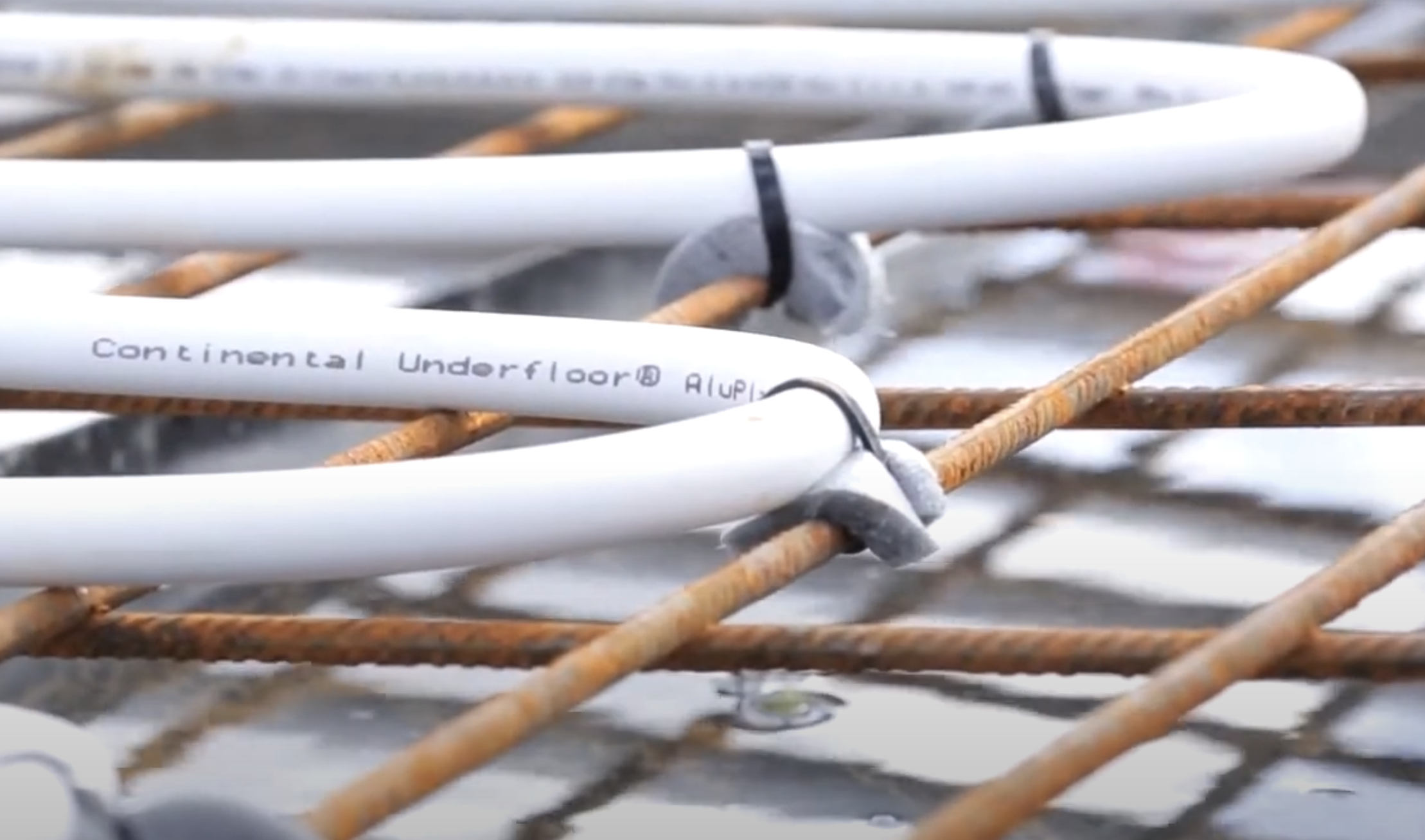

Duncan62 Posted May 24 Author Share Posted May 24 Questions: Installation time. Lay/connect the pipe loops to rebar. Install manifold to 3x loops. Then connect garden hose to pressurise the system? Will pressurising the pipe work (16mm pert-al) mean I can walk on the pipes without damaging them against the rebar? If not, how on earth do I protect the pipes when the concrete contractors trample all over it?! Link to comment Share on other sites More sharing options...
garrymartin Posted May 24 Share Posted May 24 5 hours ago, Duncan62 said: If not, how on earth do I protect the pipes when the concrete contractors trample all over it?! The pipes are pretty bulletproof and shouldn't be damaged during the pour under normal circumstances. There were some questions in other threads about abrasion against the mesh as people are walking on the pipes. I saw the below use of pipe lagging in a Youtube video and initially thought it was a great idea, but then wondered whether it would cause any issues with such a low compressive strength of the pipe insulation in the slab itself... Link to comment Share on other sites More sharing options...
saveasteading Posted May 24 Share Posted May 24 Repeated friction could wear the plastic coating off. The screeders shouldn't need to walk directly on it and the concrete or screed should flow ahead of them. If in doubt then put a plank down to spread the load. Once concrete is in, even the wet stuff will spread the load and form some cushion between pipe and rod. The use of the foam in the picture effectively forms a void in the concrete, which isn't ideal for a few reasons. 1 Link to comment Share on other sites More sharing options...

Nick Laslett Posted May 25 Share Posted May 25 (edited) 20 hours ago, Duncan62 said: Questions: Installation time. Will pressurising the pipe work (16mm pert-al) mean I can walk on the pipes without damaging them against the rebar? If not, how on earth do I protect the pipes when the concrete contractors trample all over it?! This was my main concern. There is a post somewhere from @Nickfromwales in one of the insulated slab threads where he talks about how robust these pipes can be. I tried to find a UFH pipe where they specifically said it could be tied to rebar in a concrete slab, but was not very successful. Even the question “is pert more robust than pex?”, or the other way round is very difficult to find an answer to. I believe the HDPE outer layer of the Wundatrade pipe is why they claim it is okay to go in screed. Another outfit, Optimum Underfloor Heating which uses PEX(b) pipe, in their installation instructions has an install in concrete slab. Page 4 of their installation guide. https://www.optimumunderfloor.co.uk/s/Optimum-Installation-Guide.pdf This is not to say that PERT-Al-PERT is not good for this requirement. I’m sure it is excellent and will do a good job. It would just be reassuring to have a manufacture confirm this specific use case, without having to scour the internet with a fine tooth comb. It might just be as a homeowner, I don’t need to see this info and the installers have a handle on which is the best pipe. Unless I have missed the particular thread in question, I don’t believe on BuildHub anyone has shed any greater light on this specific use case, but I could be mistaken. Very happy to be corrected as this question comes up a lot, and things like ease of installation and pipe memory, are secondary in this particular use case, where robustness is the biggest concern. *Edits Here is a good discussion from the early days of BuildHub about the robustness of various UFH pipe. Here is the post I was thinking of from Nick. Quote If they use proper Pex-Al-Pex pipe then you'll only seriously damage it if you take a hammer to it. My screeders regularly run barrow-fulls of screed over the pipes and then one of them will up-end the barrow on partially visible pipes but still with no ill effect. The stones in the concrete are of absolutely zero concern I assure you ( and I've been here more than once over the last 23 years ). Edited May 25 by Nick Laslett Link to comment Share on other sites More sharing options...
garrymartin Posted May 25 Share Posted May 25 13 minutes ago, Nick Laslett said: I tried to find a UFH pipe where they specifically said it could be tied to rebar in a concrete slab, but was not very successful. I'm pretty sure most would be fine tied to rebar in a concrete slab, but if you want an absolute guarantee that that's OK from a manufacturer, here's at least one. WarmUp Forte Grid System - https://www.warmup.co.uk/underfloor-heating/water/forte-grid-system https://www.warmup.co.uk/wp-content/uploads/Warmup-TS-Forte-2016-09-29.pdf https://www.warmup.co.uk/wp-content/uploads/Warmup-TS-AL-PE-RT-v1.0-2016-09-29.pdf 1 2 Link to comment Share on other sites More sharing options...
Nick Laslett Posted May 25 Share Posted May 25 5 minutes ago, garrymartin said: I'm pretty sure most would be fine tied to rebar in a concrete slab, but if you want an absolute guarantee that that's OK from a manufacturer, here's at least one. WarmUp Forte Grid System - https://www.warmup.co.uk/underfloor-heating/water/forte-grid-system https://www.warmup.co.uk/wp-content/uploads/Warmup-TS-Forte-2016-09-29.pdf https://www.warmup.co.uk/wp-content/uploads/Warmup-TS-AL-PE-RT-v1.0-2016-09-29.pdf That is a great find. Bit annoyed all my searching in 2019 didn’t unearth this. I did look at Warmup, but must have not looked hard enough. 1 Link to comment Share on other sites More sharing options...
