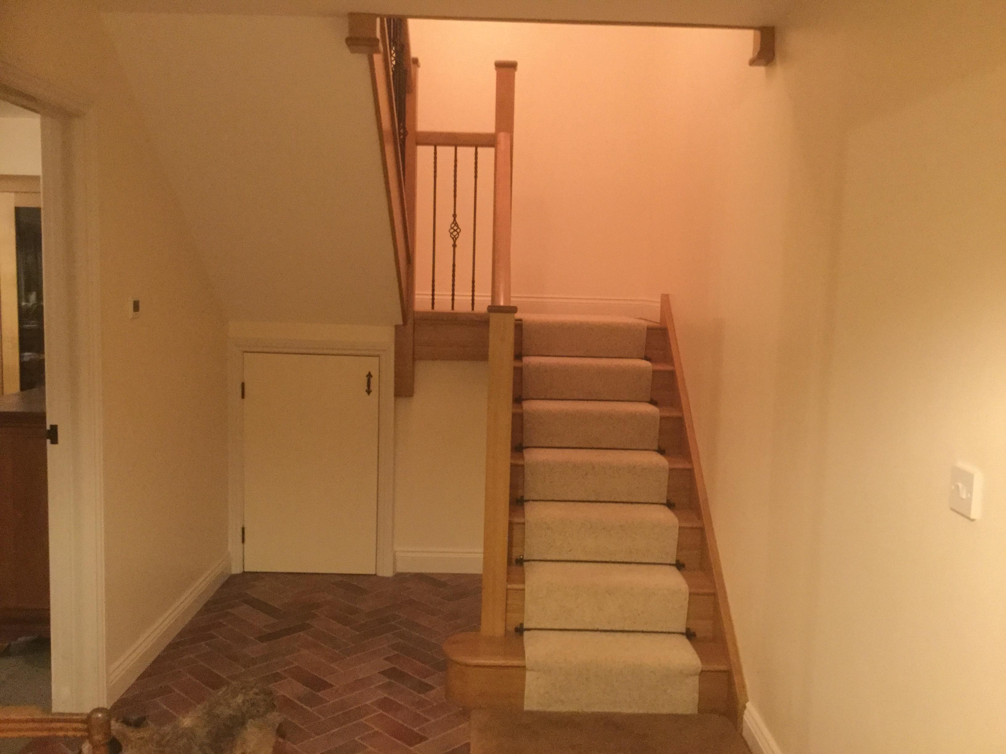

SimonD Posted May 20, 2024 Share Posted May 20, 2024 On 25/03/2024 at 06:51, Iceverge said: Pit ours in before spray painting. Bit of a PITA masking it. Pine and painted and carpeted. Oak handrails and popular spindles. Pleased with the carpet. Would do the same again. Oak is fine. Maybe a lighter wood would be nicer. Where did you get those long spindles? I want some of those for our staircase too 😊 Link to comment Share on other sites More sharing options...
Iceverge Posted May 20, 2024 Share Posted May 20, 2024 50mm popular battens is all they are. I would round the edges of them had i the time again. Beware using the pigs ear hand rails, they're not particularly grippy. 1 Link to comment Share on other sites More sharing options...

crispy_wafer Posted May 21, 2024 Share Posted May 21, 2024 Question to those with oak. Is it noisy, I mean when walking up/down it? A local manufacturer to me warned me off as it could be a bit boomy. Suggested oak for everything else but the treads? - Just curious as I've not committed either way yet. Link to comment Share on other sites More sharing options...
joe90 Posted May 21, 2024 Share Posted May 21, 2024 (edited) 29 minutes ago, crispy_wafer said: Question to those with oak. Is it noisy, I mean when walking up/down it? A local manufacturer to me warned me off as it could be a bit boomy. Suggested oak for everything else but the treads? - Just curious as I've not committed either way yet. I compromised…best of both worlds plus I find wood treads slippery. Edited May 21, 2024 by joe90 Link to comment Share on other sites More sharing options...
Adsibob Posted May 21, 2024 Share Posted May 21, 2024 14 hours ago, crispy_wafer said: Question to those with oak. Is it noisy, I mean when walking up/down it? A local manufacturer to me warned me off as it could be a bit boomy. Suggested oak for everything else but the treads? - Just curious as I've not committed either way yet. In what sense? Our oak staircase is very quiet, only real noise is that there are a couple of treads which creak a little bit, but nothing major. Link to comment Share on other sites More sharing options...
Dave Jones Posted May 22, 2024 Share Posted May 22, 2024 23 hours ago, crispy_wafer said: Question to those with oak. Is it noisy, I mean when walking up/down it? A local manufacturer to me warned me off as it could be a bit boomy. Suggested oak for everything else but the treads? - Just curious as I've not committed either way yet. we packed the underside of the stairs with leftover loftroll before boarding, made a massive difference to the sound. 1 Link to comment Share on other sites More sharing options...
