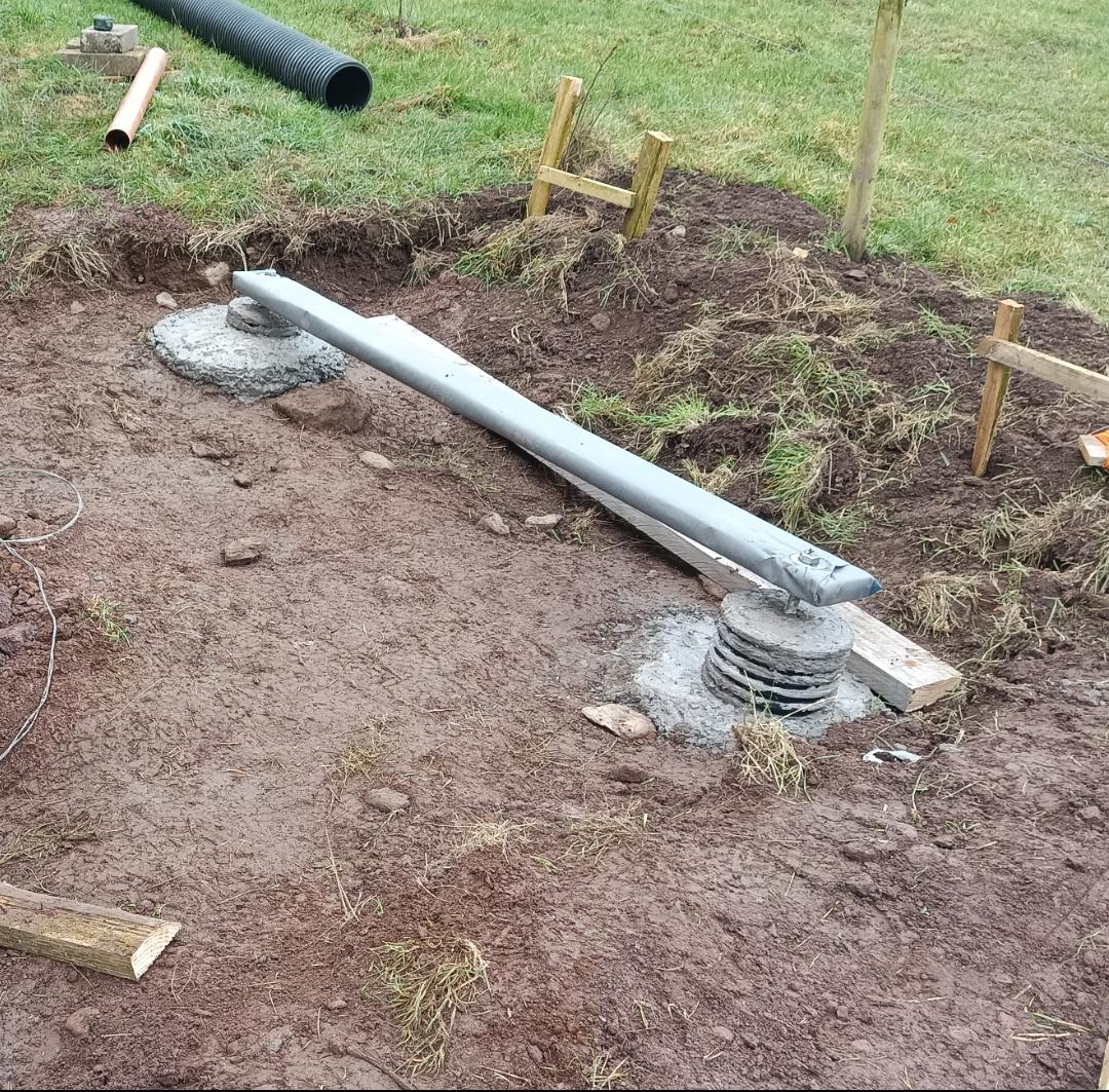

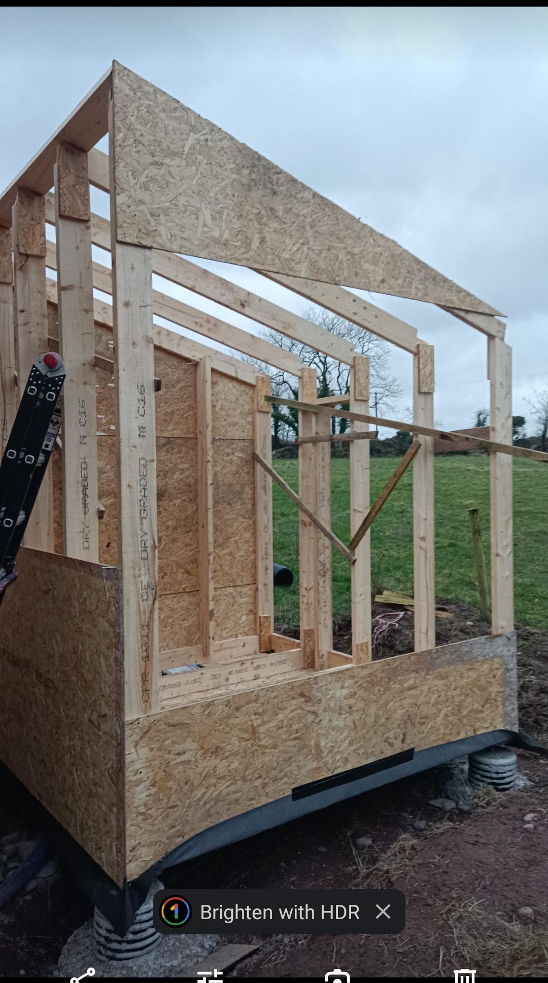

Iceverge Posted March 25, 2024 Posted March 25, 2024 If you want to have a durable low profile foundation you are stuck with masonry of some description. I built a small pumphouse by burying tyres in the ground and using them as the formwork foundations for piers that eventually held some M24 threaded bar to hold a suspended timber floor. The whole thing ended up very high up though. 1
