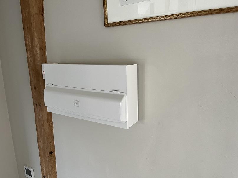

A surface mounted CU doesn't look bad IMHO, here's ours in the hallway (and a lot less faff):
Edited by Alan Ambrose
That one actually doesn’t look too bad, what make / model is it? All the ones I’ve looked at have been a bit cack looking
