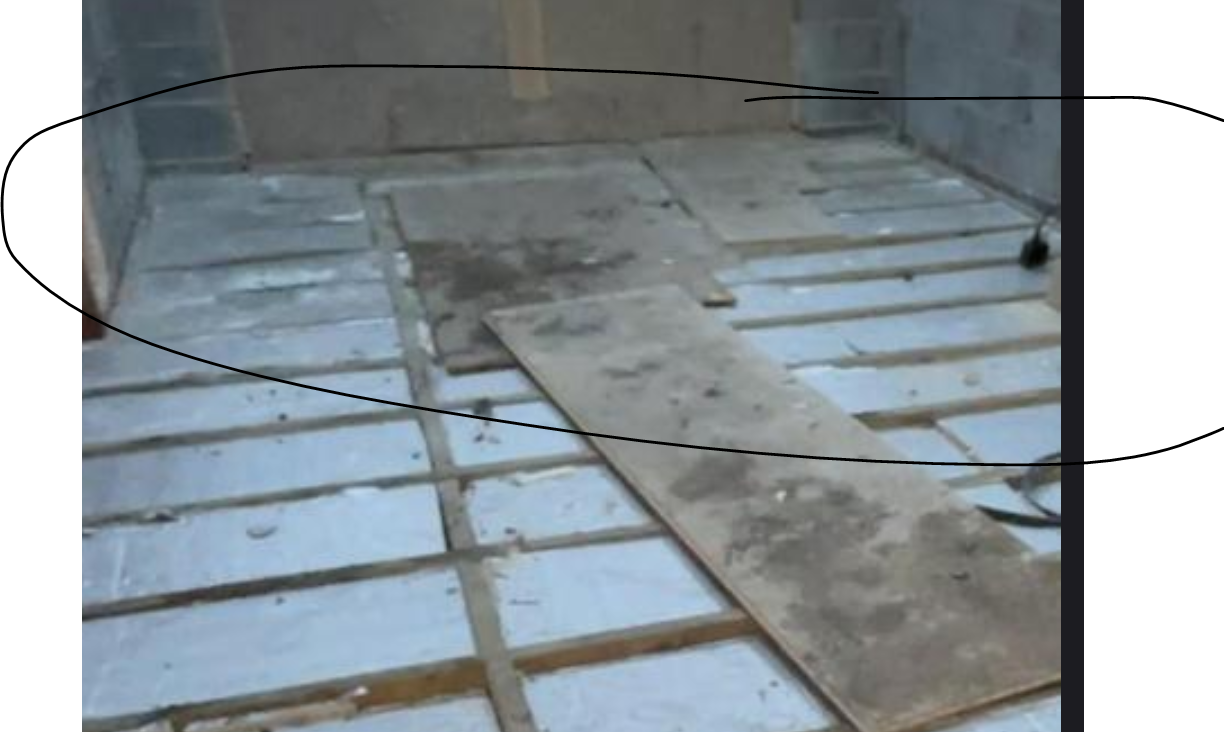

TonyT Posted March 18 Share Posted March 18 Not a good job. can you get access underneath? Link to comment Share on other sites More sharing options...
Lesley72 Posted March 18 Author Share Posted March 18 @bassanclan no idea about hangers.,but there is plenty of insulation I hope ripping the tiles up isn’t going to damage the sub floor as the underfloor heating is in it. There is a crackmat down so not sure if that needs to come up. Or if self leveller will be able to go down on top of it? I don’t think the builder will be back as we paid him his final payment last year and have been working with the tilers to try to get the cracked tiles sorted. When I asked the builder about the joist and floor he just said it was built to the architects spec 🤷🏻♀️ I would love to rip it all up and start again but with the new kitchen in and underfloor heating in, we can’t take everything up so are going to have to do the best fix possible. Whatever that is and try and get some flooring down that isn’t going to crack Link to comment Share on other sites More sharing options...

bassanclan Posted March 19 Share Posted March 19 You can put self levelling on the ant crack mat, but it will crack because the subfloor is moving too much! LVT is bonded to the floor, it shouldn't crack, but with the floor moving so much i wouldn't be sure, if it doesn't crack gaps will open up between the tiles. Don't take up the whole floor, just enough to prove that the floor is not fixed properly, then ask for the builders public liability insurance details! 1 Link to comment Share on other sites More sharing options...
nod Posted March 19 Share Posted March 19 Loads of answers So probably repeating advise As a tiling contractor The problem is in the first sentence 6 mil ply is your problem It should have been at least 12.5 The matting will make little difference Link to comment Share on other sites More sharing options...

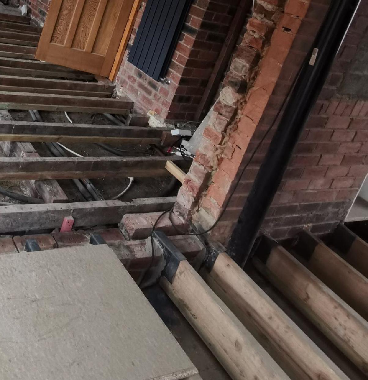

Super_Paulie Posted March 19 Share Posted March 19 (edited) i hope they foamed and taped that PIR as well, seems very gappy. One of the reasons i put my own PIR in as the only person i would trust to do a good job was myself... If you have any more photos of the build around the joists it might help. Id imagine the gable side are in pockets in the wall and the nearside are resting on the now removed cavity wall? this is the setup that my builder did and the nearside in the cavity was sketchy at best, i built-up inbetween them to keep them true and had to use various bits of slate to keep them from bouncing and bring them totally level. Id imagine any remedial work now the UFH is in will be quite painful. Was it pug/biscuit mix youve got inbetween the joists? Actually just saw you used TorFloor. That in itself is pretty much half-routed through from the off. Id whack a 6mm over the top of that to bring the total of ply to 12mm if it was me, maybe even up to 18. Edited March 19 by Super_Paulie Link to comment Share on other sites More sharing options...

saveasteading Posted March 19 Share Posted March 19 Is the ceiling beneath finished? Link to comment Share on other sites More sharing options...
Dave Jones Posted March 19 Share Posted March 19 looks like a design feck up. Who provided the height datums for the floors ? from this picture it looks like nowhere near enough space left for a 22mm floor , ufh on top then 6mm backer board and 10mm (?) tiles? ) Link to comment Share on other sites More sharing options...
Lesley72 Posted March 19 Author Share Posted March 19 @Dave Jones the 22mm board is routed to fit the ufh heating in and so are the 6mm ply that went ontop. We had the option to put 12mm ply but the tiler says it would be fine with 6mm and the crackmat.. wish we’d gone with the 12mm ply. 🤬🤬🤬 1 Link to comment Share on other sites More sharing options...
