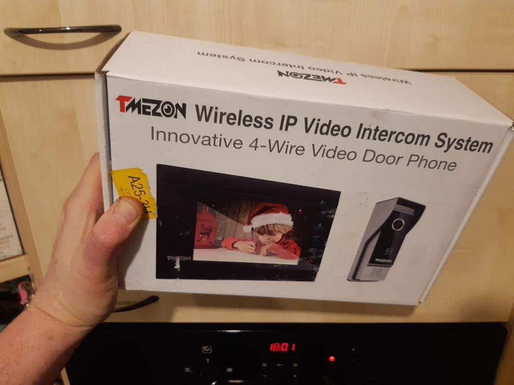

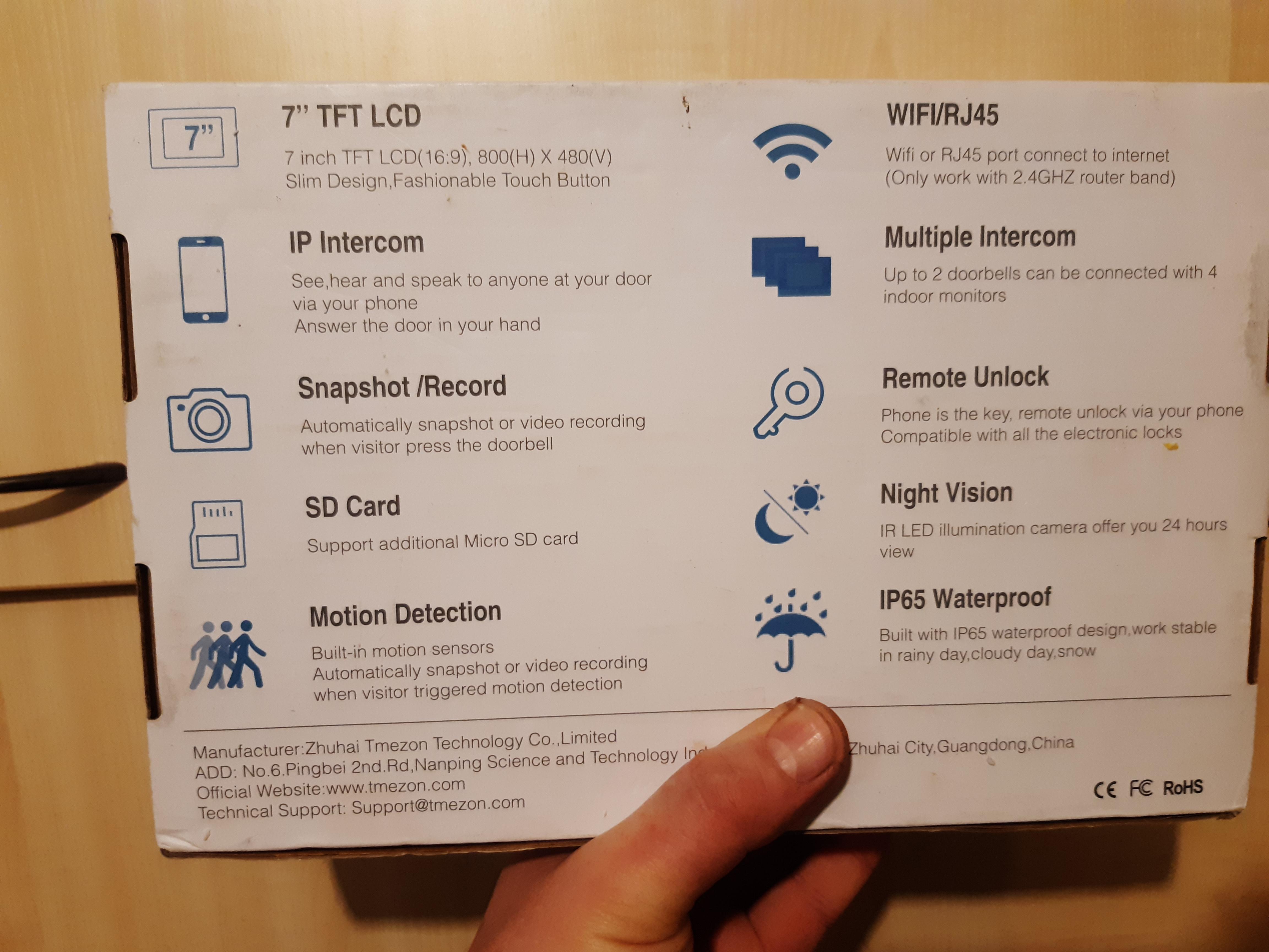

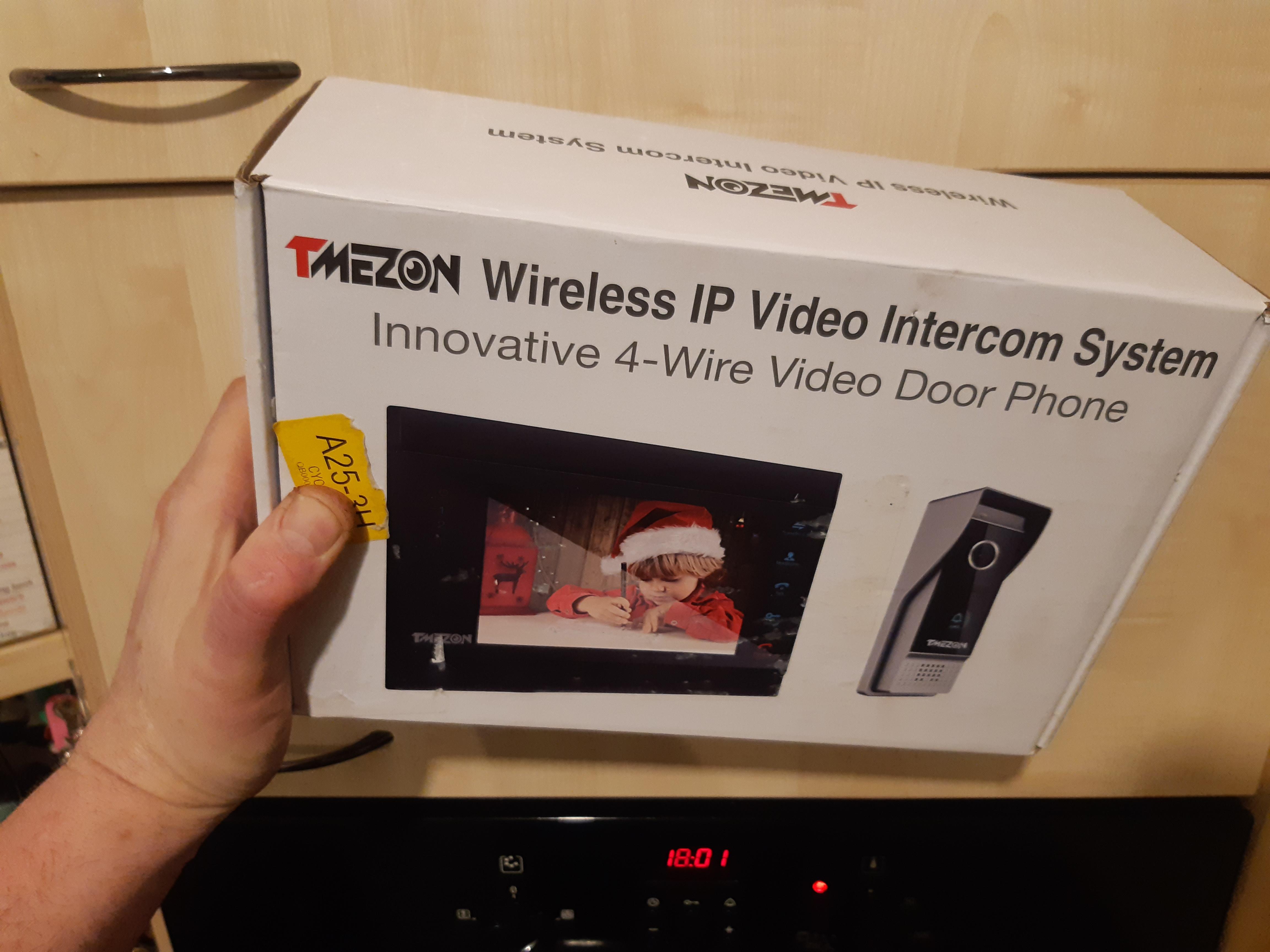

Onoff Posted March 19, 2024 Posted March 19, 2024 This is my one: This I think: https://www.ebay.co.uk/itm/284650164954 1
