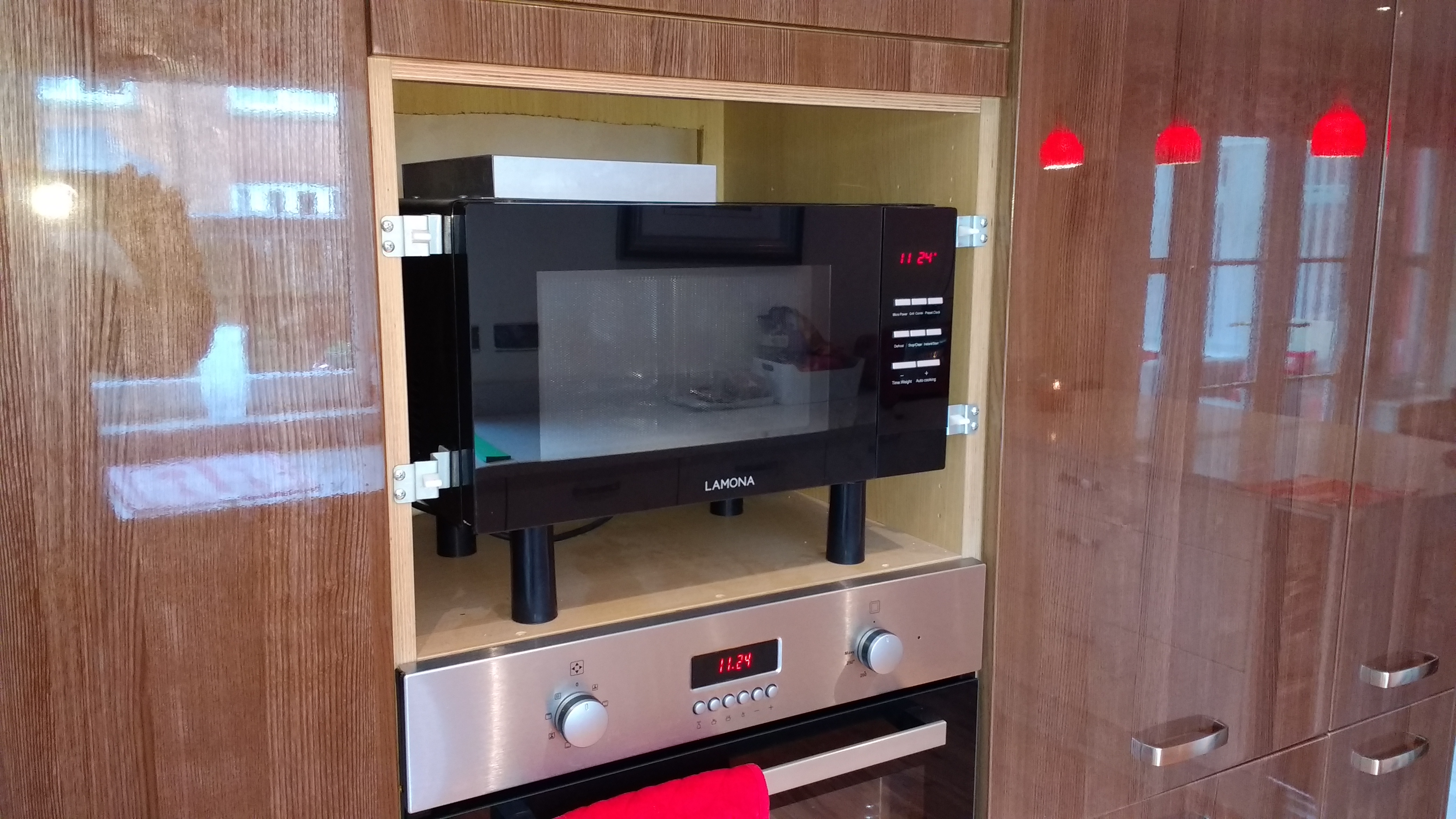

Can anyone help with finding a microwave to fit in this Howdens space?
Dimensions are cabinet 590x455 internal and the existing Lamona unit is 480x255.
As you can see there is a snap on trim.
Can't source the doors anywhere, glendevon oak, discontinued. Ditto Lamona ovens...?

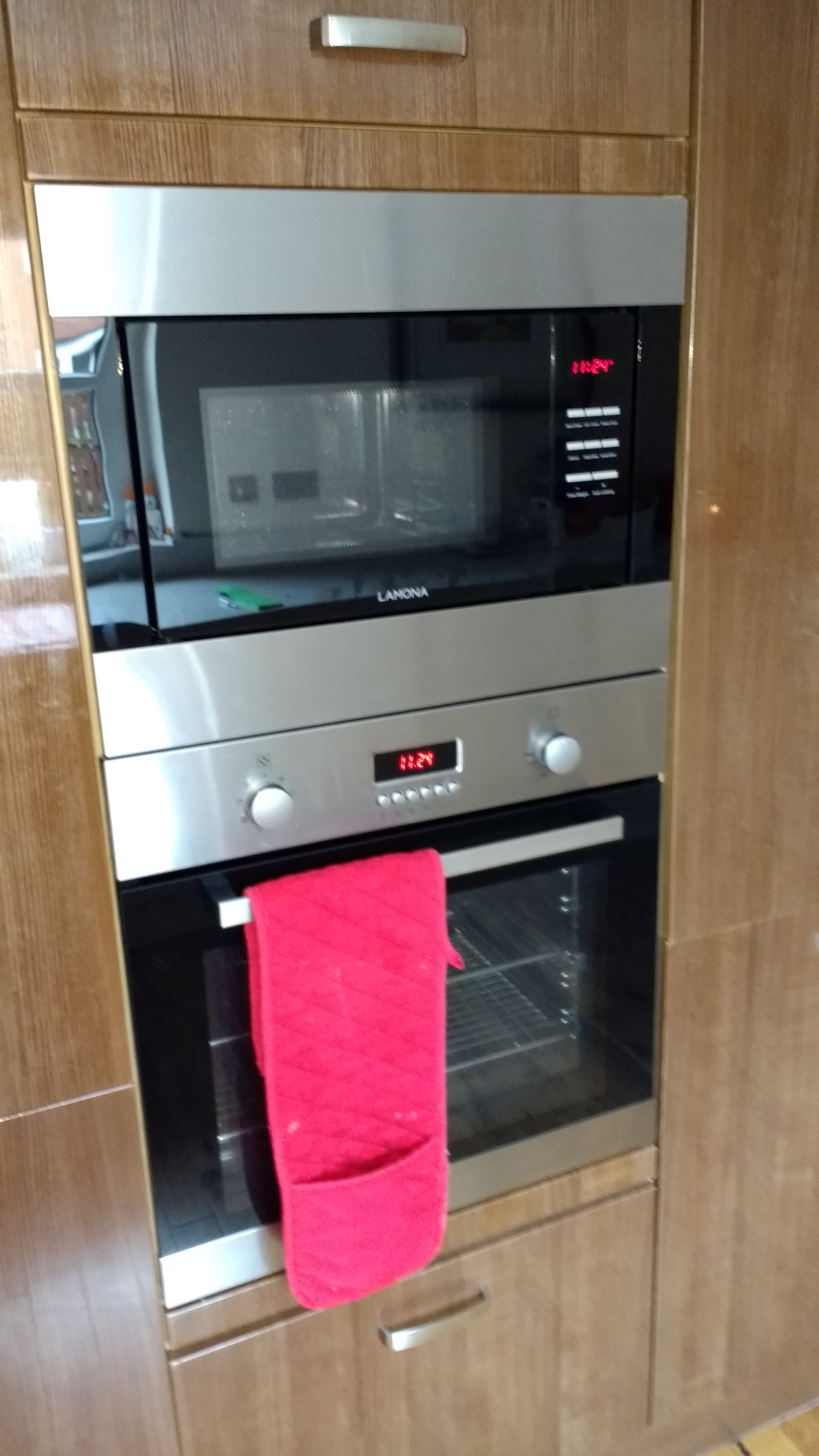

It's not the one with the black sides, but here is a stainless steel Lamona trim
http://www.ebay.co.uk/itm/Integrated-Microwave-Frame-Kit-Lamona-/142519546723

I think that 590x455 is a standard (plus or minus a few mm) size - my built in microwave with a warming draw beneath is in exactly such a hole. And minor adjustments (say +10mm in height or -5mm each side in width should be allowable for (eg trim the wooden top panel and paint the edge or fix a couple of strips of dark timber down the edges). So
1 - My previous setup was microwave mounted on rail kit on the shelf with cosmetic alu or stainless surround panel. I found one sufficiently the right size to fit the existing panel and even the mounts by taking some measurements and taking the surround panel and a tape measure into my local Curry's and measuring all the freestanding microwaves until I found an acceptable one that fitted closely enough. I might have had to move one mounting rail 10mm but that was about it.
2 - Equally you may find that if you talk to the shop or manufacturer they may well have panels to fit all of their built-in microwaves that match your standard size hole for £10 or £25.
3 - It is quite fruitful putting "built-in microwave 590mm 455mm" into Google.

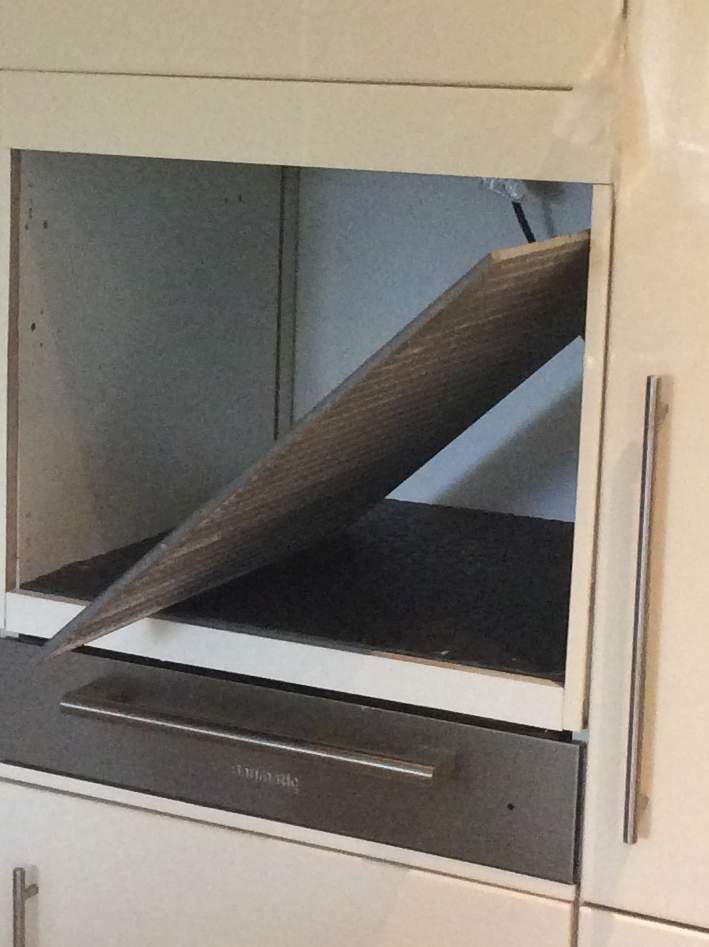

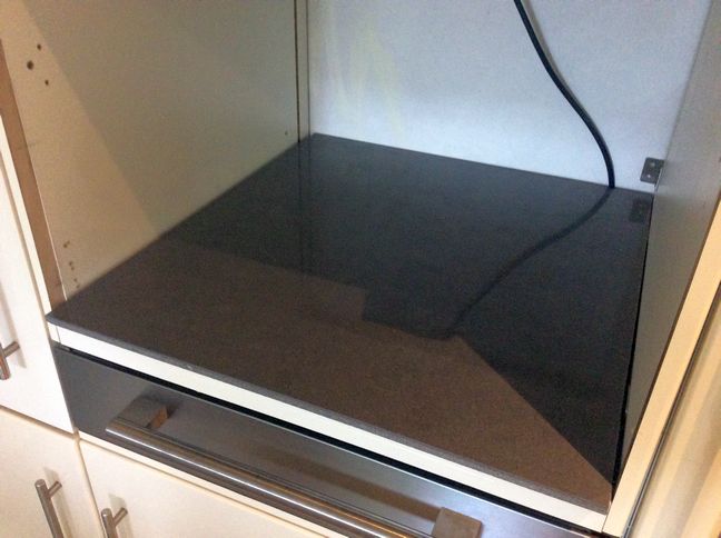

As an alternative, my microwave has now come out onto the worktop, and the hole is being turned into a 600x600 worktop space using a single porcelain mottled-grey big floor tile trimmed on one side.
Seems to work OK, and will have painted MDF liner inserted.

Totally misread it, I thought you had somehow lost the trim.
This appears to fit
http://ao.com/product/uim600-newworld-microwave-stainless-steel-26817-50.aspx
