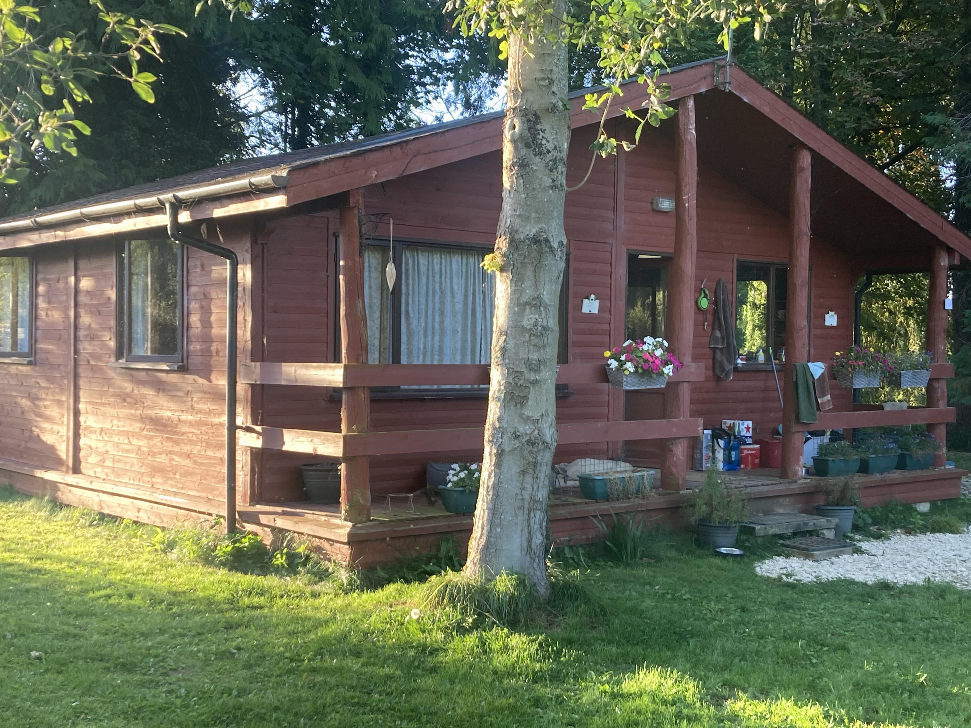

Russell griffiths Posted March 14, 2024 Posted March 14, 2024 6x6 split 50-50 front and back so 6x3 kitchen open plan living room then 6x3 at the back with 2 small bedrooms and a tiny bathroom, we only use one bedroom the other one is a dressing room clothes hanging and drying space. bedroom is tight, double bed against one wall with 600mm at the bottom of the bed and 1m to the side of the bed. we have lived in it for two years and it’s very comfortable, the only downside is no storage. my wardrobe consists of a stack n store box with 2 pairs of good jeans and 3 pairs of work trousers, a few t shirts and that’s it, everything else in storage. 1 hour ago, mjc55 said: Is that a cabin that will stay there permanently? How is it divided between living/sleeping/sanitary functionality? (if you don't mind me asking) 1
