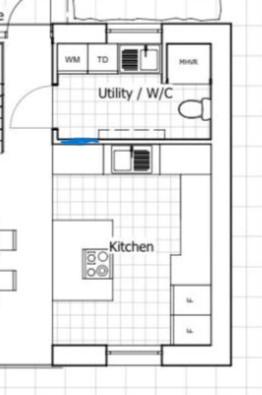

Nic Posted March 13, 2024 Author Share Posted March 13, 2024 Something like this, not set in stone on utility room layout ( probably stack washer and dryer , move toilet and MVHR as ASHP will be on the external wall where to toilet currently is located Link to comment Share on other sites More sharing options...

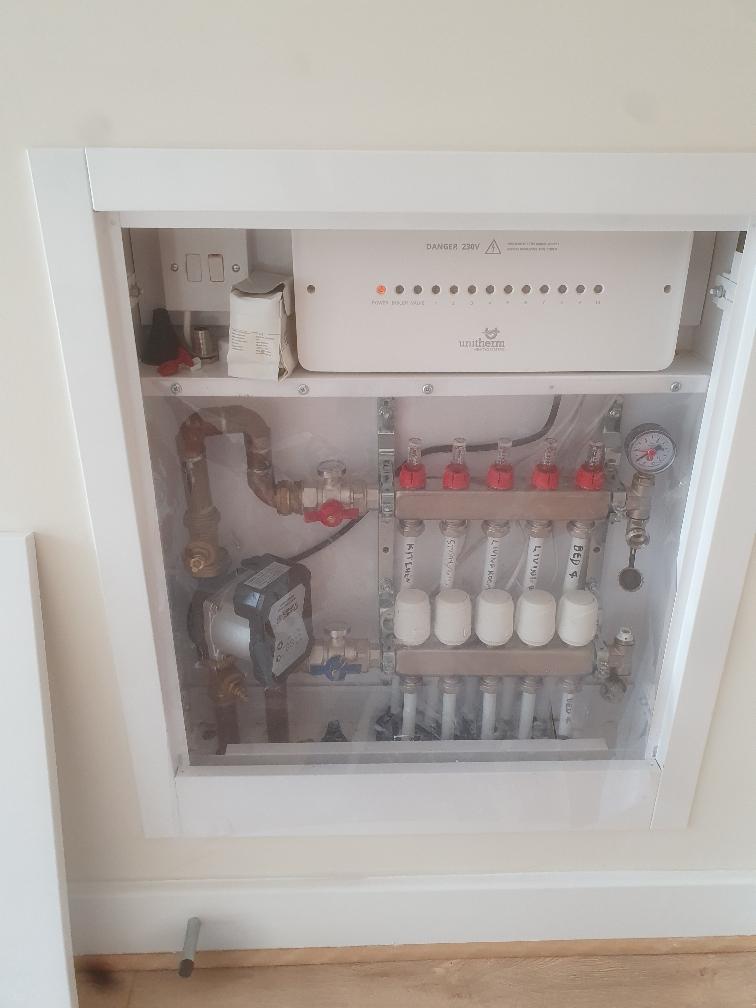

Moonshine Posted March 13, 2024 Share Posted March 13, 2024 i would stay you best bet is to out the UFH stuff in a recessed cabinet between the WC and kitchen about here, opening into the WC. However this timber stud work wall has to be thicker to accommodate it so you will loose some floor area https://www.wundatrade.co.uk/shop/home/underfloor-heating-manifolds-and-pump-sets/underfloor-heating-manifolds/medium-recessed-waterproof-manifold-cabinet/ 1 Link to comment Share on other sites More sharing options...
SteamyTea Posted March 13, 2024 Share Posted March 13, 2024 @Nic Are the grid squares 0.5m? Link to comment Share on other sites More sharing options...
ProDave Posted March 13, 2024 Share Posted March 13, 2024 15 minutes ago, Moonshine said: i would stay you best bet is to out the UFH stuff in a recessed cabinet between the WC and kitchen about here, opening into the WC. However this timber stud work wall has to be thicker to accommodate it so you will loose some floor area https://www.wundatrade.co.uk/shop/home/underfloor-heating-manifolds-and-pump-sets/underfloor-heating-manifolds/medium-recessed-waterproof-manifold-cabinet/ I fitted the UFH manifold in my bathroom into a 100mm space. I had to turn the pump in it's side and remove the knob from the blending valve. You can usually borrow 50mm space behind the kitchen cabinets as well. 1 Link to comment Share on other sites More sharing options...

Moonshine Posted March 13, 2024 Share Posted March 13, 2024 17 minutes ago, SteamyTea said: @Nic Are the grid squares 0.5m? the external patio grid is 0.6m Link to comment Share on other sites More sharing options...
Nic Posted March 13, 2024 Author Share Posted March 13, 2024 1 hour ago, SteamyTea said: @Nic Are the grid squares 0.5m? Not sure but internally the space is 9300mm x 6000mm Link to comment Share on other sites More sharing options...
Nic Posted March 13, 2024 Author Share Posted March 13, 2024 1 hour ago, ProDave said: How are you achieving means of escape windows in the bedrooms? Good question, architect has not mentioned that so I suspect that will need to be addressed Link to comment Share on other sites More sharing options...
Moonshine Posted March 13, 2024 Share Posted March 13, 2024 (edited) 29 minutes ago, Nic said: Not sure but internally the space is 9300mm x 6000mm From my finger in the air calcs, if UFH pipe spacing is 150mm in the screed (usual for an ASHP), you are looking about 6.7 linear metres of pipe per m2. 56m2 will be 372 linear metre of pipe at least. So you are looking at 4 circuits (being <100m), maybe 5 depending on zoning. As @SteamyTea noted all these circuits can be in one zone and controlled by one thermostat, which may be apt as its open plan on the ground floor, but i would probably go for a separate zone and circuit in the WC / Utility. Edited March 13, 2024 by Moonshine 1 Link to comment Share on other sites More sharing options...
JohnMo Posted March 13, 2024 Share Posted March 13, 2024 8 minutes ago, Moonshine said: i would probably go for a separate zone and circuit in the WC / Utility. I really wouldn't install loops in these rooms, your manifold will be in this room and all the pipes having to go through the doorway. Big curve through that room with the pipes will provide more than enough heat. Then just do it all a single zone Link to comment Share on other sites More sharing options...
Moonshine Posted March 13, 2024 Share Posted March 13, 2024 Just now, JohnMo said: I really wouldn't install loops in these rooms, your manifold will be in this room and all the pipes having to go through the doorway. Big curve through that room with the pipes will provide more than enough heat. Then just do it all a single zone i respectfully disagree 😉. The pipes won't need to go through the WC and its doorway, if they are coming up out of the screed into a timber stud wall / recessed cabinet, they can go 'south' into the kitchen (maybe 3 circuits) and spread out, with one circuit going 'north' into WC. This way the heat requirement of the WC is separate to the main living areas and it won't over heat in the WC. 1 Link to comment Share on other sites More sharing options...
