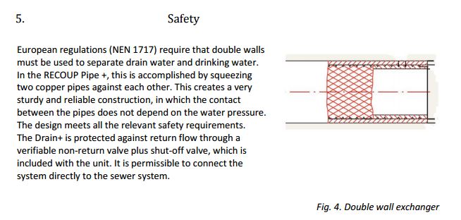

PeterW Posted June 11, 2016 Posted June 11, 2016 On 11/06/2016 at 13:05, JSHarris said: There has to be an air gap. The regs prevent you from having what amounts to a single wall between a pipe containing potable water and a waste water pipe, so brazing or soldering the cold water pipe to the waste water pipe would be a breach of the regs. It's why the efficiency of the commercial units is rarely better than 50% or so; they have to comply with the regs and leave a tiny air gap and also provide a visible indication that either pipe has failed, by means of drips coming out through that air gap drain space. Expand Thanks - I am struggling to see how the Recoup+ units work to achieve that as they definitely seem to use a "composite" pipe that has no apparent air gap, but also has no drain point to show of any leaks..? That would indicate that a mechanical linkage (ie contact) is fine, but a soldered joint is not. In reality, neither is likely to fail, and the high pressure to low pressure route is more likely to occur.
Jeremy Harris Posted June 11, 2016 Posted June 11, 2016 The Recoup units don't have smooth walls where they are pressed together, there are longitudinal grooves so that any leakage can flow down,escape from the lower vent and be seen, which slightly reduces the contact area, but allows compliance with the regs. There used to be a cross-section graphic showing this, but I've had a look and cannot find it, it may have been taken down because others were copying it. I agree that a failure is both unlikely and even less likely to result in contamination, but then the regs were not designed to be flexible enough to cover waste water heat recovery, and haven't been amended.
PeterW Posted June 11, 2016 Posted June 11, 2016 So in essence if you were to use a solid coil of copper at 4mm to wrap a 42mm pipe, put that inside a 50mm pipe and then put a water jacket on that, you could meet the regs... Just seems very odd..!
Jeremy Harris Posted June 11, 2016 Posted June 11, 2016 It is odd, but I looked into it, to the extent of making up a prototype short version, using just an annular water jacket, before I discovered the quirks in the regs. IIRC I may have partially documented it on the GBF, as it was several years ago. I bought short lengths of pipe from ebay and brazed the thing up. The bit I had to play around with was getting the tangential inlet to work. It's essential that there is a lot of swirl in the waste water, so that it both contacts the side of the waste pipe and to slow it down, vertically. There was a bit of playing around to get the water to swirl enough that it would stay stuck to the inside face of the waste pipe. Just dumping waste water down the thing meant it barely touched the sides, and heat transfer efficiency was pretty low.

Jeremy Harris Posted June 11, 2016 Posted June 11, 2016 I think the general definition (although I've not seen it written down) is that waste water only becomes waste after the trap. If this is the case, then there is scope for making a single-walled version. It may well be how the Heat Squirrel ( http://esavep.com/index.php/air-source-products/waste-water-heat-recovery.html ) got away with it, as that definitely did not have a twin wall pipe system when I looked at the cutaway drawing that they had on a stand at a show years ago. It was just a tank to hold waste water with a conventional coiled pipe heat exchanger in it that the incoming cold feed went through. Maybe it was also a big trap, and worked by not having a trap on the feed to it. I discussed it with the ESP people a few years ago, as I was very interested in it (and in their Ecocent and the other Chinese ASHPs they were selling), and they assured me that it was legal, even though I couldn't see how on earth it could be. Then again, very nice and helpful people as they are, I'm not at all convinced that ESP are really that ethical; one look at their use of images and diagrams taken directly from the Genvex manual, and the use of a photo of a Genvex in their advert for their Chinese-made copy of a similar unit, has left me wondering a bit about whether they are overly concerned with the fine detail of laws and regulations.
ProDave Posted June 11, 2016 Posted June 11, 2016 Interesting thread. If I were DIYing a heat recovery system, I would not get bothered about the regs. All you have in essence is a cold water supply pipe running next to a waste pipe, nothing against that in the regs. the fact you [cough] solder the cold water pipe [/cough] to the waste pipe makes it no more likely that waste water will contaminate the cold flow. My thoughts, It would surely work much better in a long horizontal run at a shallow fall, feed the cold water in at the outlet end and take the warmed water out of the end nearest the shower trap. On the basis the water will flow along the bottom of the pipe, just a couple of heat collector pipes in a straight line following say the bottom 1/3 of the pipe rather than wrapped around it. Now I can see this working for a shower, to pre heat the "cold" feed a little bit. and having an individual heat recovery unit for each shower, feeding the cold feed to that shower. But what about a bath? A bath uses a lot more water. It lets it all go qickly when you pull the plug, and even if you had a heat recovery system where is the warmed water going to feed? So it seems only a viable idea for a shower then? for a bath you need somewhere to store the heat and a heat pump to extract the heat from it. I know, why not just leave the water in the bath after you have finished until it has gone cold (wared the room) before pulling the plug?
