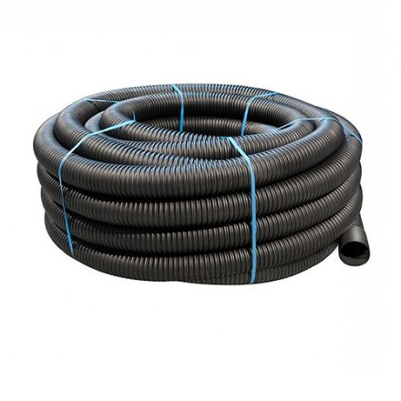

It is on a hill so rain runs away. Can you put in a trench or swale or french drain to hold the water?
And divert roof rain towards the tree, using a land drain or soakaway detail to encourage all the water into the ground.
Or a pond.

The tree needs water but won't mind where it comes from. Clay takes a long time to recover from summer drying, and water has to very gradually migrate downwards. So if you can catch it and give it every opportunity to go down over a large area then this could work.
A trench along the contour with a perforated land drain pipe and gravel or rubble surround is probably easiest, cheapest and best.
Thank you so much 🙂
