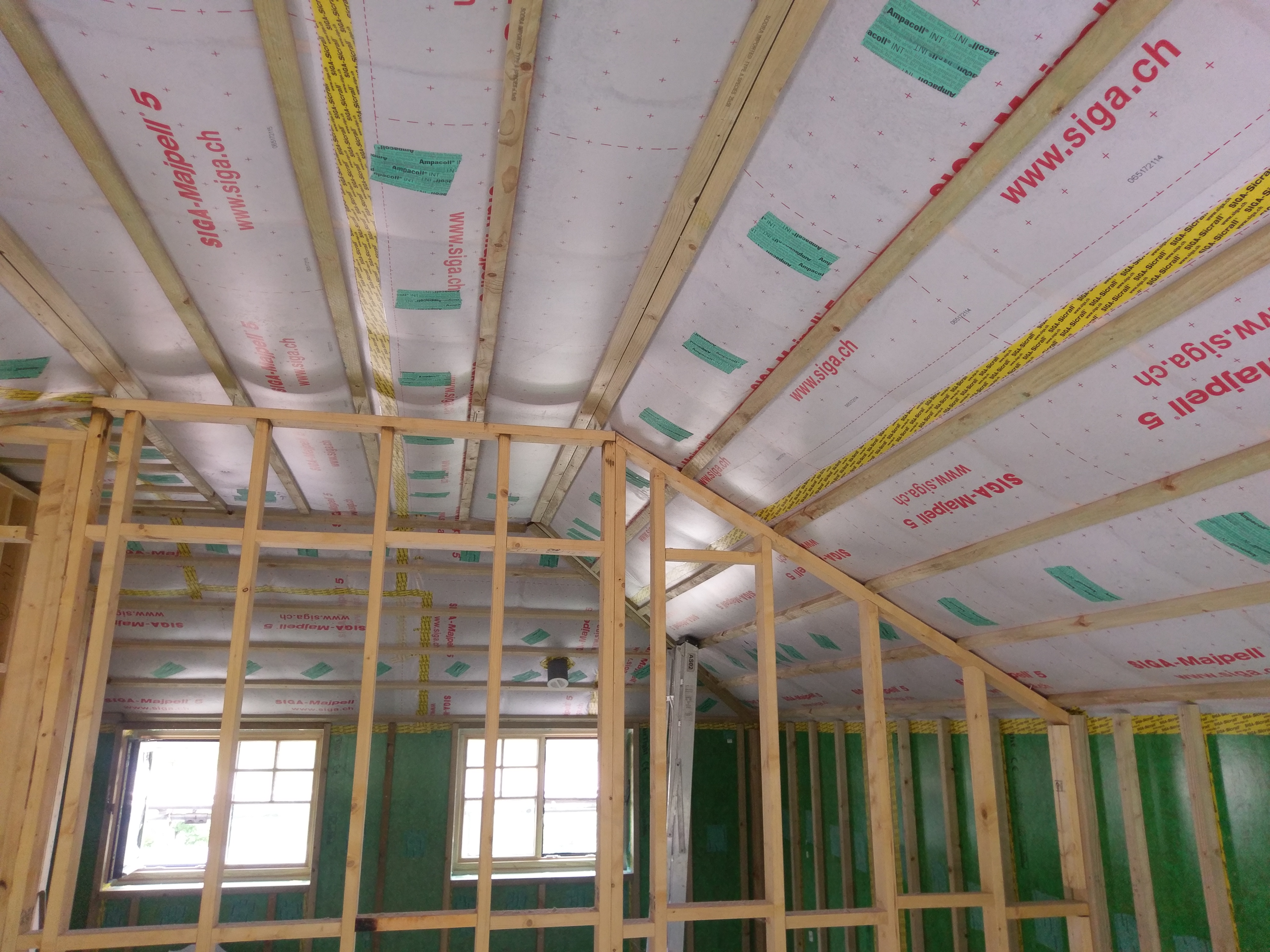

dpmiller Posted October 1, 2017 Share Posted October 1, 2017 do MBC not counterbatten the ceiling for a void? Link to comment Share on other sites More sharing options...

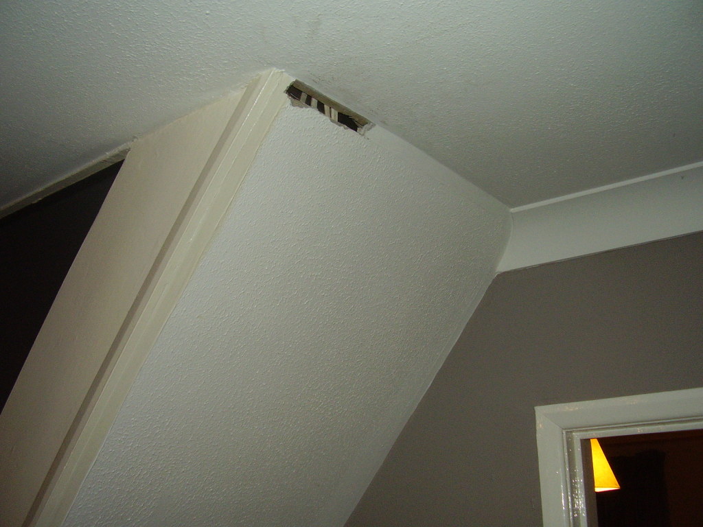

dogman Posted October 1, 2017 Author Share Posted October 1, 2017 yes, but with the amount of insulation the void is sort of filled up Link to comment Share on other sites More sharing options...
dogman Posted October 1, 2017 Author Share Posted October 1, 2017 You can sort of see what i mean here in one of the bed rooms Link to comment Share on other sites More sharing options...
Barney12 Posted October 1, 2017 Share Posted October 1, 2017 23 minutes ago, dogman said: yes, but with the amount of insulation the void is sort of filled up We have exactly the same issue with our MBC ceilings. The insulation pumped in causes the airtight membrane to "pillow" to the point that the ceiling service void isn't much of a void! In the end I counterbattened certain ceiling areas to allow for cable runs. Link to comment Share on other sites More sharing options...
