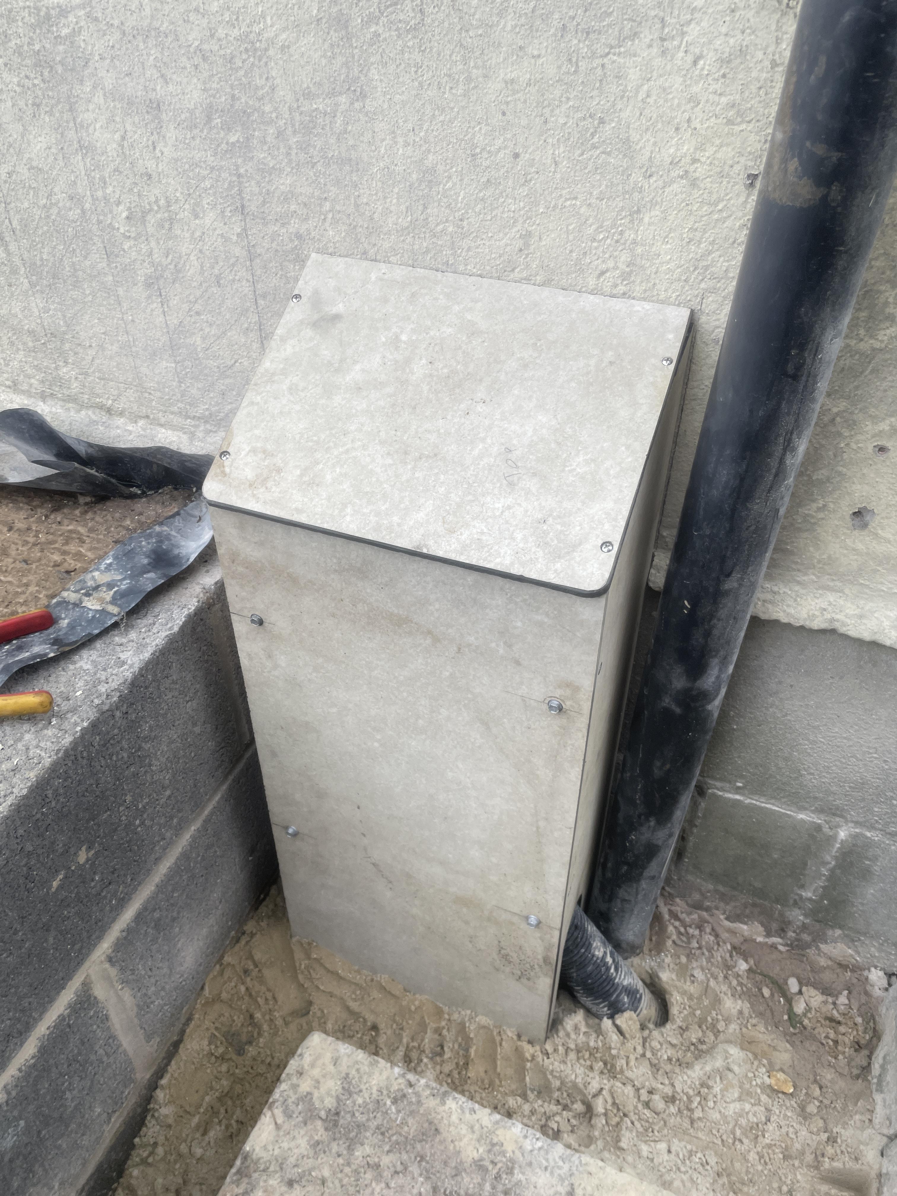

HughF Posted March 5 Share Posted March 5 I built a box out of trespa cladding and covered it all up…. You could do similar but paint it to match the brickwork? Link to comment Share on other sites More sharing options...

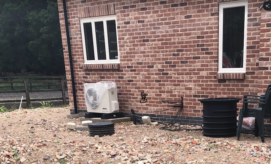

crispy_wafer Posted March 5 Author Share Posted March 5 That's actually neat solution @HughF. A picture of where the the HP will be sat, pipes into plant room through the scribble, It will sharing space with an A2A unit hence why it's over to the left... I've seen Trunking used for A2A units pipework, something like that I think would be ideal I think to cover the pipes and brickwork entry. Link to comment Share on other sites More sharing options...

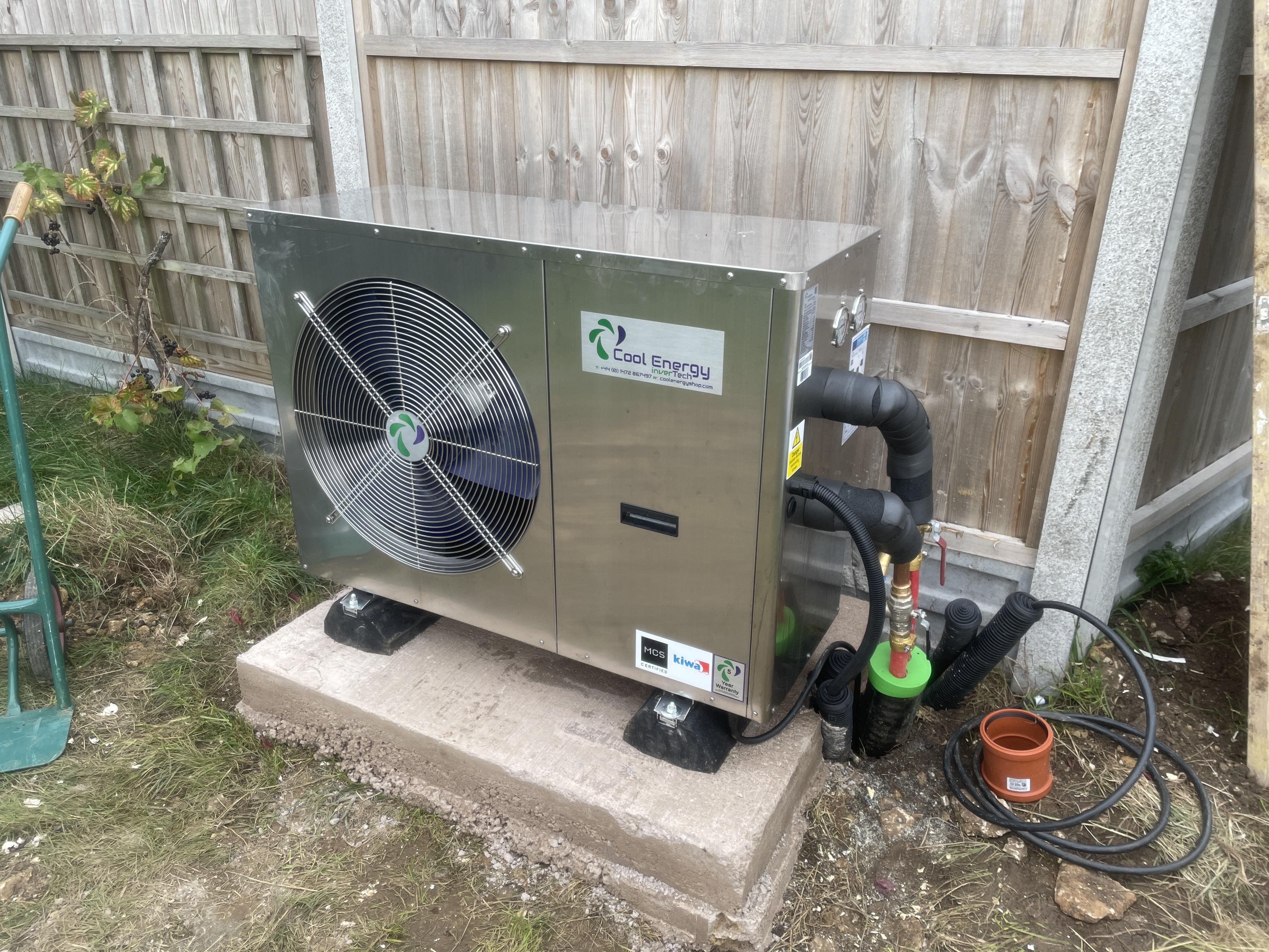

HughF Posted March 7 Share Posted March 7 (edited) I didn’t use flexi’s….. straight off the 32mm pex into 28mm press adapters, onto 28mm and then onto brass unions threaded straight onto the heat pump. Edited March 7 by HughF 1 Link to comment Share on other sites More sharing options...
