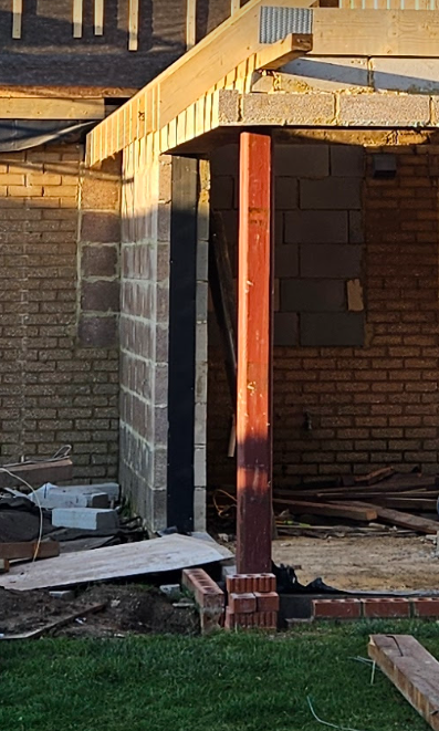

NRMartin Posted March 1, 2024 Share Posted March 1, 2024 Morning all, I have a steel column in the corner of my build, with a steel returning both directions because there are bifolds on both sides of the corner. The corner needs to be rendered, and I was assuming I'd need to build the external wall of the column out of block work. However, because the overall column will only be 300 x 300mm the blocks need to be tied back to the steel somehow - otherwise it will be a tiny part of blockwork that's unsupported from the back. I've attached a photo of the column to help show what I mean Does anyone have any advice on how to do this, or if there are ties I can use? Thanks in advance Link to comment Share on other sites More sharing options...
Mr Punter Posted March 1, 2024 Share Posted March 1, 2024 (edited) You can fix the ties to the column with screws or shotfire Hilti nails. You may need 1 every course. https://www.travisperkins.co.uk/wall-and-frame-ties/staifix-spb-frame-cramp-200mm/p/252309 Edited March 1, 2024 by Mr Punter 1 Link to comment Share on other sites More sharing options...
Temp Posted March 1, 2024 Share Posted March 1, 2024 +1 "Starter wall ties" fixed to the column? 1 Link to comment Share on other sites More sharing options...
Conor Posted March 1, 2024 Share Posted March 1, 2024 Where does the steel sit relative to the cavity? It looks like it's in the inner leaf? If it was within the cavity or external leaf, then it needs to be a galvanised post, which it isn't. Is there a drawing showing the bifold detail? You want to avoid cold bridging here. Link to comment Share on other sites More sharing options...
Canski Posted March 1, 2024 Share Posted March 1, 2024 Tek Screws ( easiest with a pilot hole) and frame cramps. We don't shot fire any more. Most engineers advise against it because the nails have been known to corrode over the years. Link to comment Share on other sites More sharing options...
Redbeard Posted March 1, 2024 Share Posted March 1, 2024 Perhaps forget the blocks and use XPS? Much warmer. (I would normally say graphite EPS but XPS will give you a bit more impact resistance 'just in case'). Thin-coat reinforced render on top, of course. 1 Link to comment Share on other sites More sharing options...
Redbeard Posted March 1, 2024 Share Posted March 1, 2024 XPS would fix via pilot holes to column, BTW. Link to comment Share on other sites More sharing options...

saveasteading Posted March 1, 2024 Share Posted March 1, 2024 Good advice and ideas above. I'm torn. A fabricated boxing may be vulnerable to bashing and difficult to repair. However it would flex with the building if the door is bashed, and in wind. Block can be tied to the steel and will be robust, but the render may crack.... but is easy to patch. If you go the block route then use self drill, self tapping tek screws with the correct head (called a 'heavy') for hot-rolled steel (ie not for cladding or light weight steel). They are easy to find at a specialist fixings merchant, and a driving head to suit. Then you can use standard L wall ties. These screws are much easier to fix than hilti nails, using a normal drill and you can be certain they will stay put. Paint the steel with bitumen paint and it won't rust. or a fancier, coloured steel protection paint. If the base plate is exposed, then paint it and any mortar packing too. And pack the cavity with cavity insulation. 2 Link to comment Share on other sites More sharing options...
