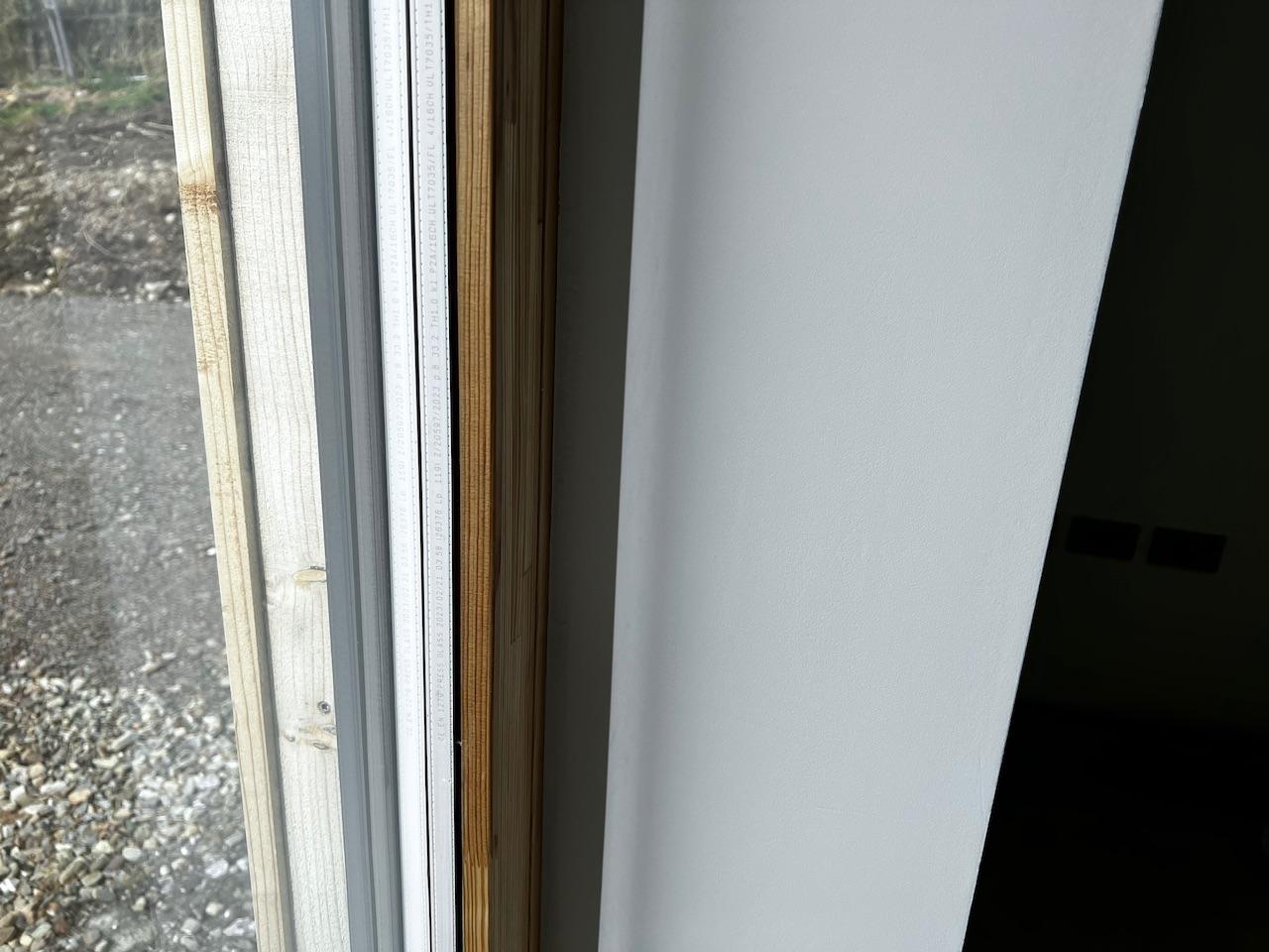

Thick walls look nicer too in my opinion. Our walls are 490mm thick from outside face of the cladding to inside face of the painted wall. It’s given us deep reveals internally which is partly why we chose this build method. Everything has a more substantial solid feel about it.
With my fairly thick walls (400mm) I created angled reveals which allow more light and look really nice.
Great idea. Lots of old stone buildings do that.
There are lots of little details I love about our house this view of the wall inside to outside is one of them.
We also set our reveals at 60° see
I just picked up on this, trawling blocks. I like the sound of the reveal to make it brighter and more cottagey. Are there any technical issues involved or is it purely decorative. I mean is any more support required in order to angle the reveals?
FF
FF
The inner skin needs a longer lintel (I used concrete lintels in the inner block work and brick arches in the outer. ) I also mounted the windows and doors on the back of the brickwork (check reveals) and the fact the inner “hole” was bigger meant it was easier to do this. I cut the block work at an angle and mounted plasterboard across the reveal. Being check reveals also means the windows are fully in the insulation zone. Yes everyone who visited remarked how good it looked.
