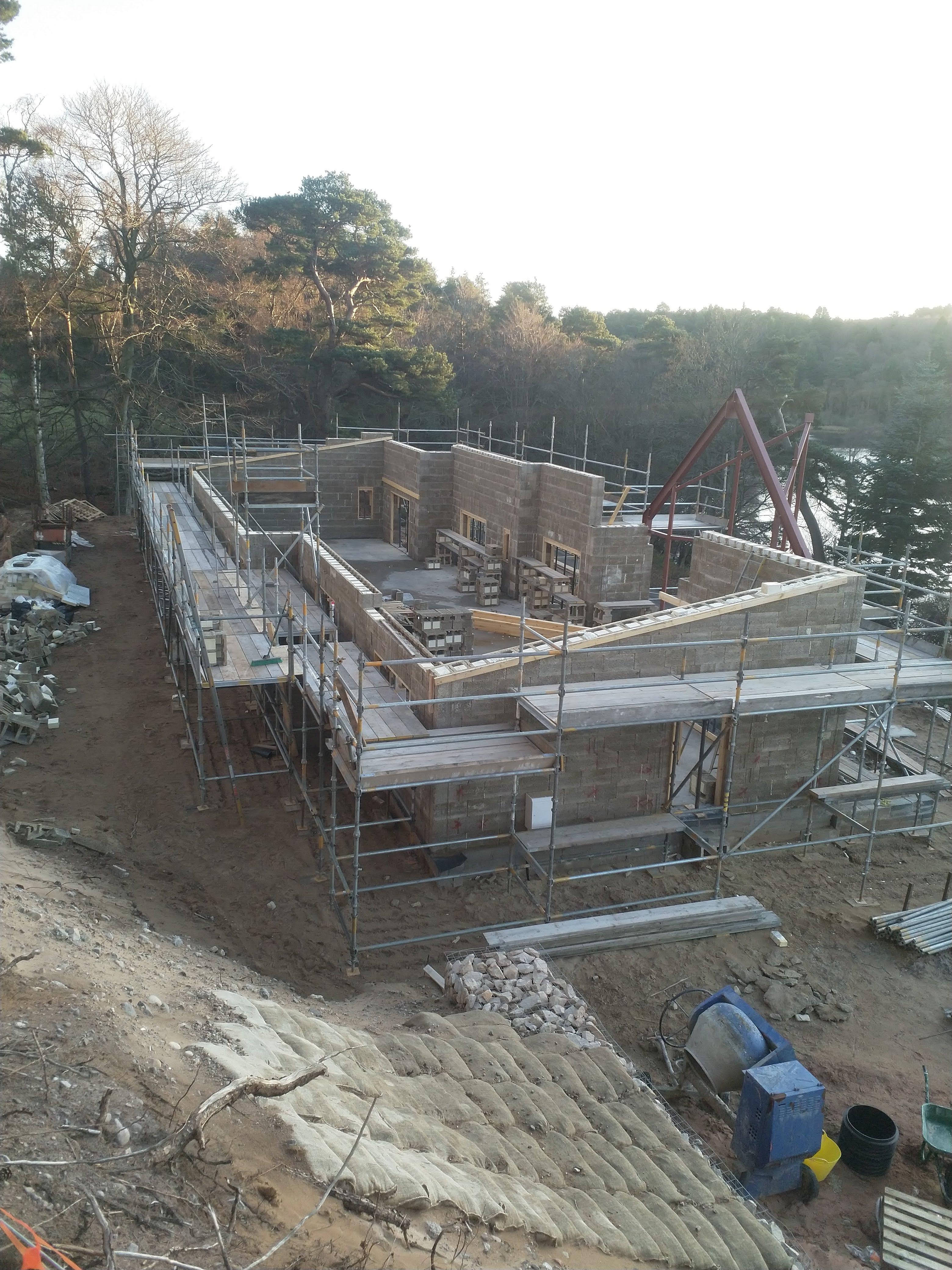

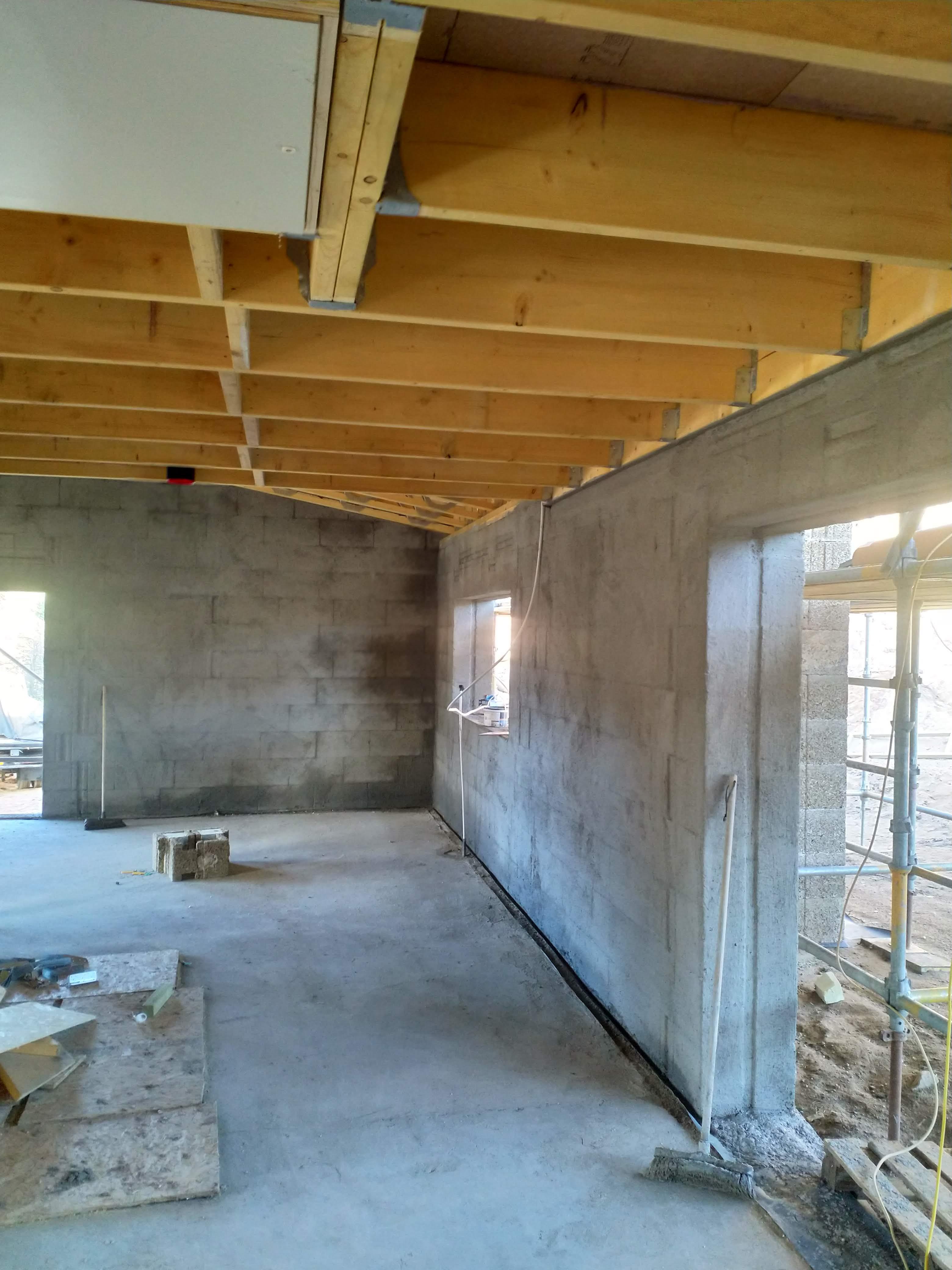

JohnMo Posted April 5, 2024 Posted April 5, 2024 (edited) 1 hour ago, Russell griffiths said: bracing cost for my icf was around £1000 for a 240m build. Picking a product like durisol because it doesn’t require bracing is absolutely bonkers Durisol costs nothing to brace, well 4 sheets of osb and some screws. Nothing wrong with durisol, our external walls took us 4 weeks, (70m x 3m tall) neither of us (2 off) had done or used ICF and neither of are builders. 48 minutes ago, Carly Lawson said: correct me if I am wrong but it seems that Ecobrix (new owners of Durisol) is one of the few UK made ICF's? I can't imagine how much extra pollution and extra carbon must be produced to import EPS foam from the United states. Is that not a crazy thing to do or is that just what everyone dose? Yes from recycling mostly old end of life pallets, very little cement, made in Wales. Easy for anyone to build from. Render and or plaster directly to the woodcrete. U value of 0.14 out the box, zero cold bridges, very little rebars required. You actually screw things to the woodcrete without issue. Lots of things to like. Edited April 5, 2024 by JohnMo 2

JohnMo Posted April 5, 2024 Posted April 5, 2024 8 minutes ago, Carly Lawson said: They said they would give us the quantity for cement and rebar but we have to work that out. You need a structural engineer for the rebar calcs. Durisol had a really good build manual, you should be able to find it online.

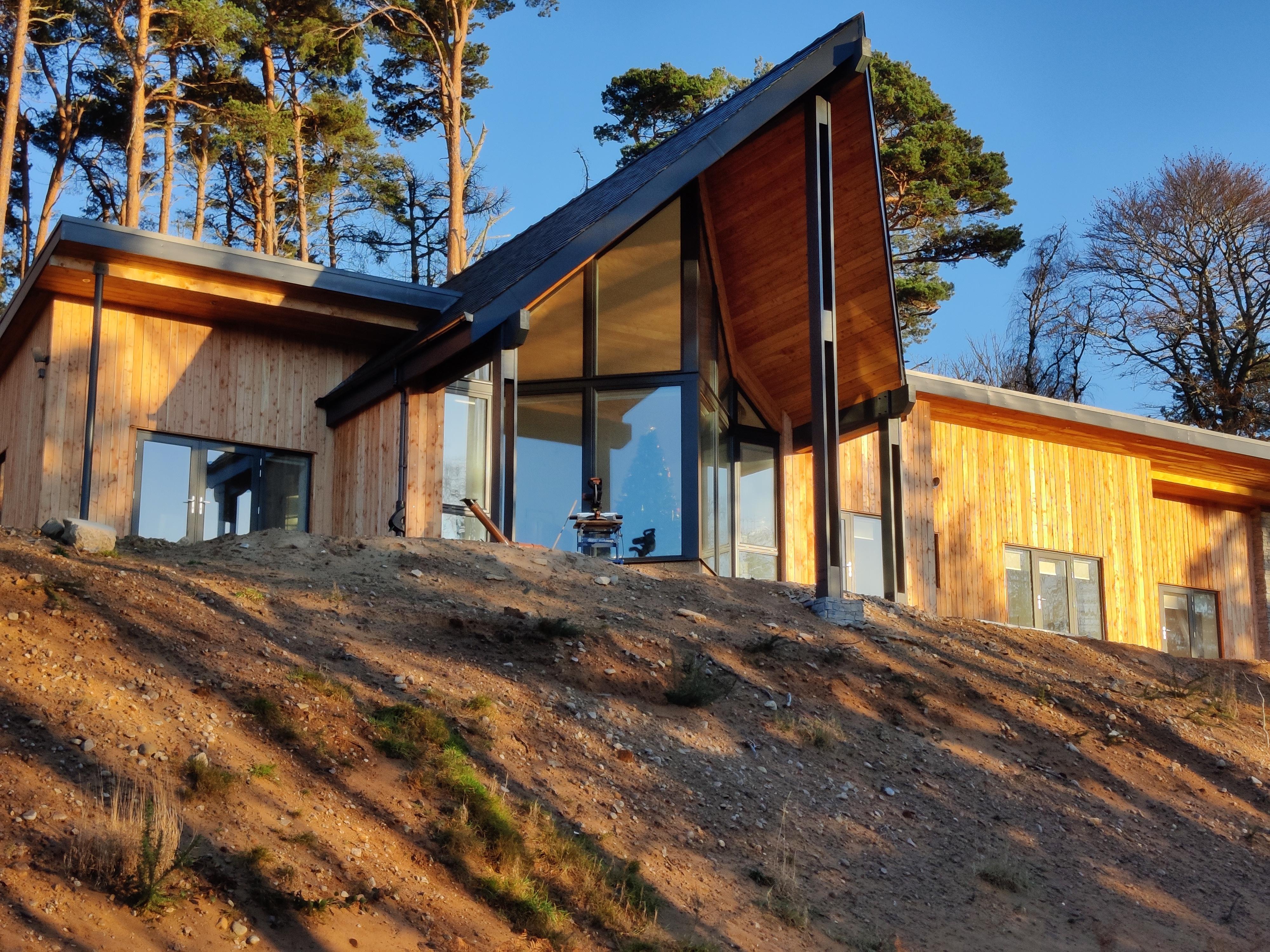

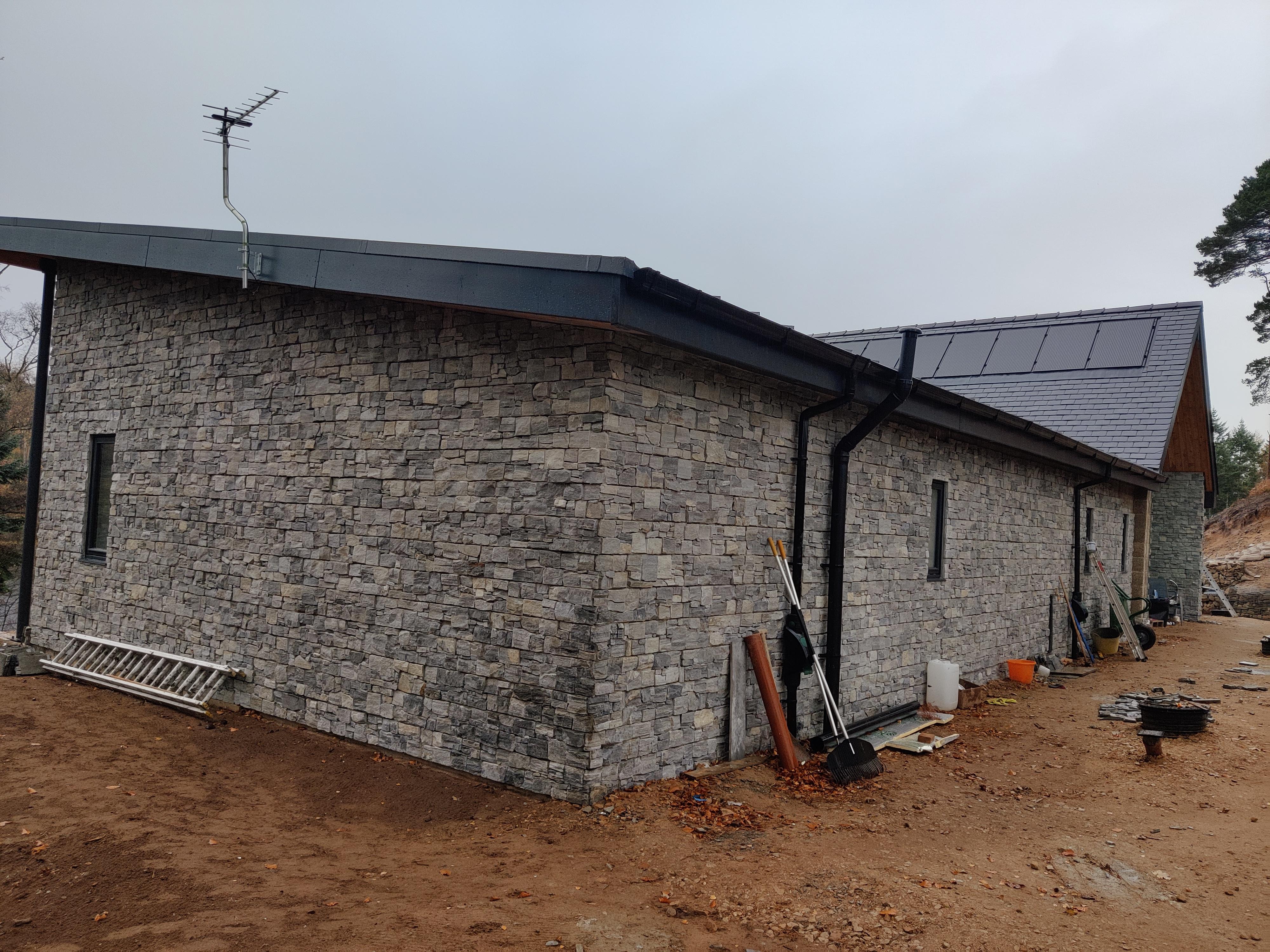

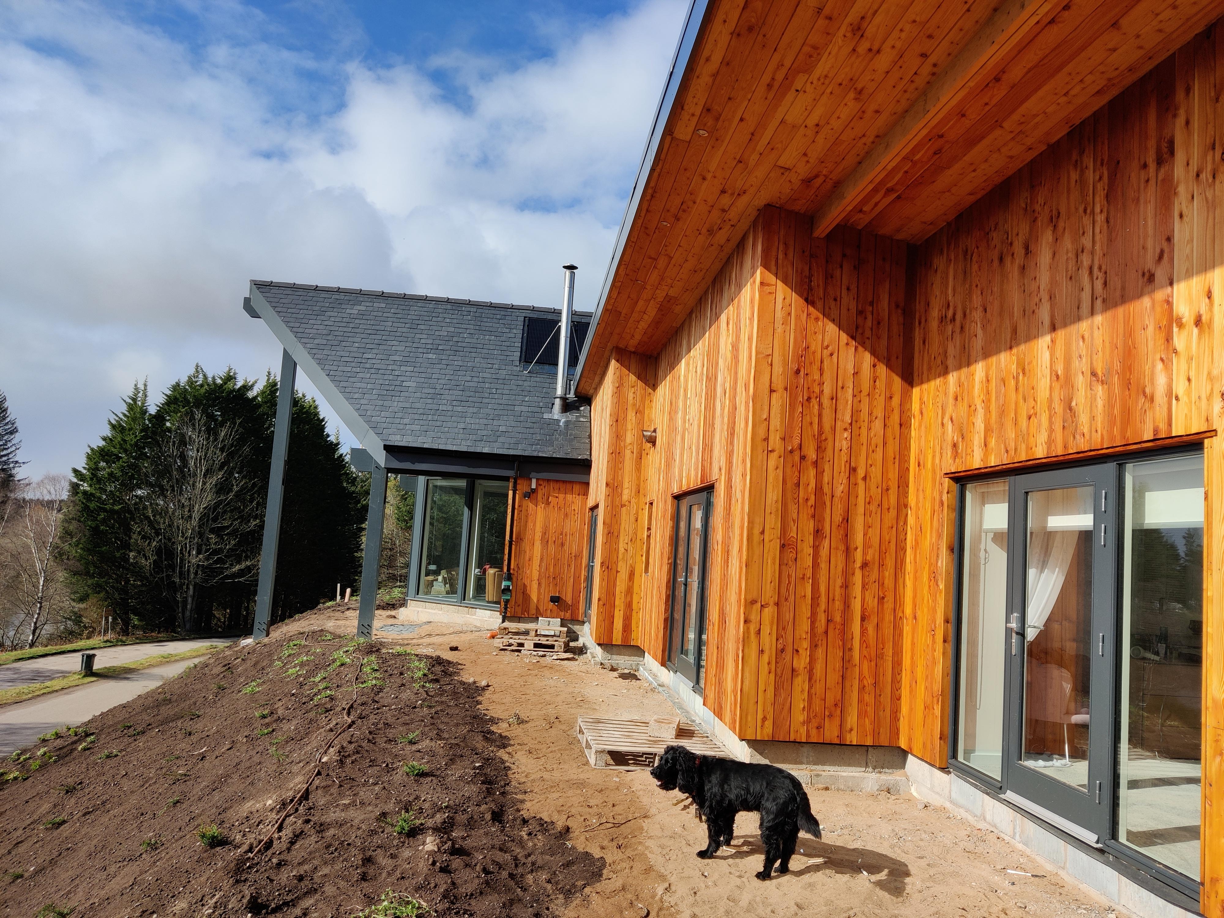

JohnMo Posted April 5, 2024 Posted April 5, 2024 10 minutes ago, Carly Lawson said: Did you render the walls yourself No we didn't render at all, as I hate the stuff. I used stone slips and Scottish larch cladding. Inside we did a lime, cement parge coat for airtightness, and sevice void for from battens screwed to durisol and the dry lined with plasterboard. Doing it again I would miss the parge coat and use a smart air tight vapour barrier membrane, less mess and quicker. 2
Carly Lawson Posted April 5, 2024 Posted April 5, 2024 Hi JohnMo, I think your house sounds amazing. Stone Slips must look amazing! Our architect was thinking mainly render with brick slips (hemp brick slips) to add some charm. However, maybe we should look at adding in some stone slips, ground level as a feature. Thank you so much. This forum has so much helpful advice. I don't understand what steamytea is talking about, sorry that all seems very complicated and I have not been to the Ecobrix factory yet and I don't know anything about crude oil. I just know that if we can, we'd would like to try and be ecofriendly and support UK business and jobs. This country was once full of shops and people had jobs making things but now it seems that people get angry if you try to suggest buying something made in Wales! I don't understand that. We do like the Timber frame but it seems we will save money and the walls will be thinner if we have ICF walls. We were impressed to learn that the ecobrix blocks are mostly made of recycled wood, so isn't that kinda the best of both worlds because we will have a timber roof and floors will all be made here in the UK.
Carly Lawson Posted April 5, 2024 Posted April 5, 2024 OMG OMG OMG that is magical!!! I absolutely love it!! Thank you for sharing. What a beautiful setting and design! Gosh, I hope we do something that good 1
