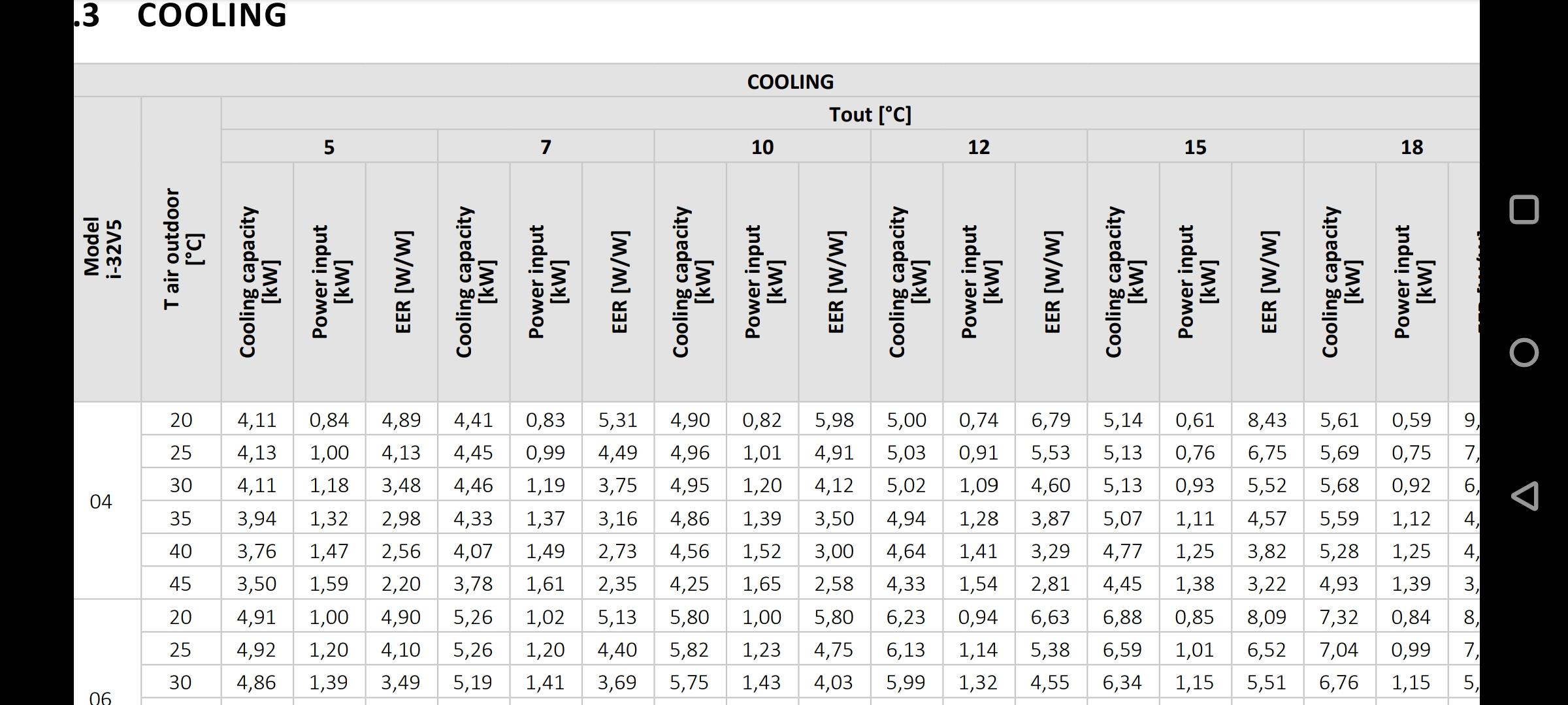

JohnMo Posted March 6 Share Posted March 6 15 hours ago, saveasteading said: But I agree that being in the sun won't make much difference to an ashp, but being next to a big masonry wall in the sun might be a fair bit better than in a permanently dark and damp alley Unless you want to cool also, then efficiency drops. So working the argument through Biggest difference between the OP and the reference property, is the reference property only did DHW for around 1 hour per day. OP will be heating, cooling and DHW, so a different use case. So let's assume the sun exposed, heavily build stone area that's designed to trap the sun's heat, ASHP installed close to a south facing wall to get max perceived gains. Heating by ASHP running with an internal thermostat. Typical nice winters day, cold overnight, zero degs, bright morning, sun out and air temp increases to 7 degs, then by 5pm temp starts to drop quite fast. Overnight the stone area reduces to match ambient air temp of zero, ASHP gets no negative or positive effects from this. Morning air temperature start to rise, stone area remains at close to zero for a prolonged period as sun not high enough in the sky to have any heating effect. ASHP in an area below air temp, negative impact on CoP. Late morning to late afternoon, sun out and heating stone, sun also on house windows warming house, heating clicks off. DHW clicks on and heat pump starts at 2pm. Localised area could warm air flow to ASHP by say 5 degs (if you are lucky), giving a 0.3 CoP benefit. Heating benefit zero as heat pump is off. Early to late evening, temperature outside drop back, some residual heat in stone, but the benefits are marginal, CoP gains for a short period but would guess almost nil. Cooling case case almost the opposite, sun out you need cooling, ASHP is hot sun trap, EER (CoP when cooling), takes a hit. When flowing 12 degs changing air temp from 20 to 25 has a 1.2 negative impact on EER. Another negative is weather compensation becomes screwed up, if the temperature probe becomes exposed to artificial low or high temperatures. 1 Link to comment Share on other sites More sharing options...

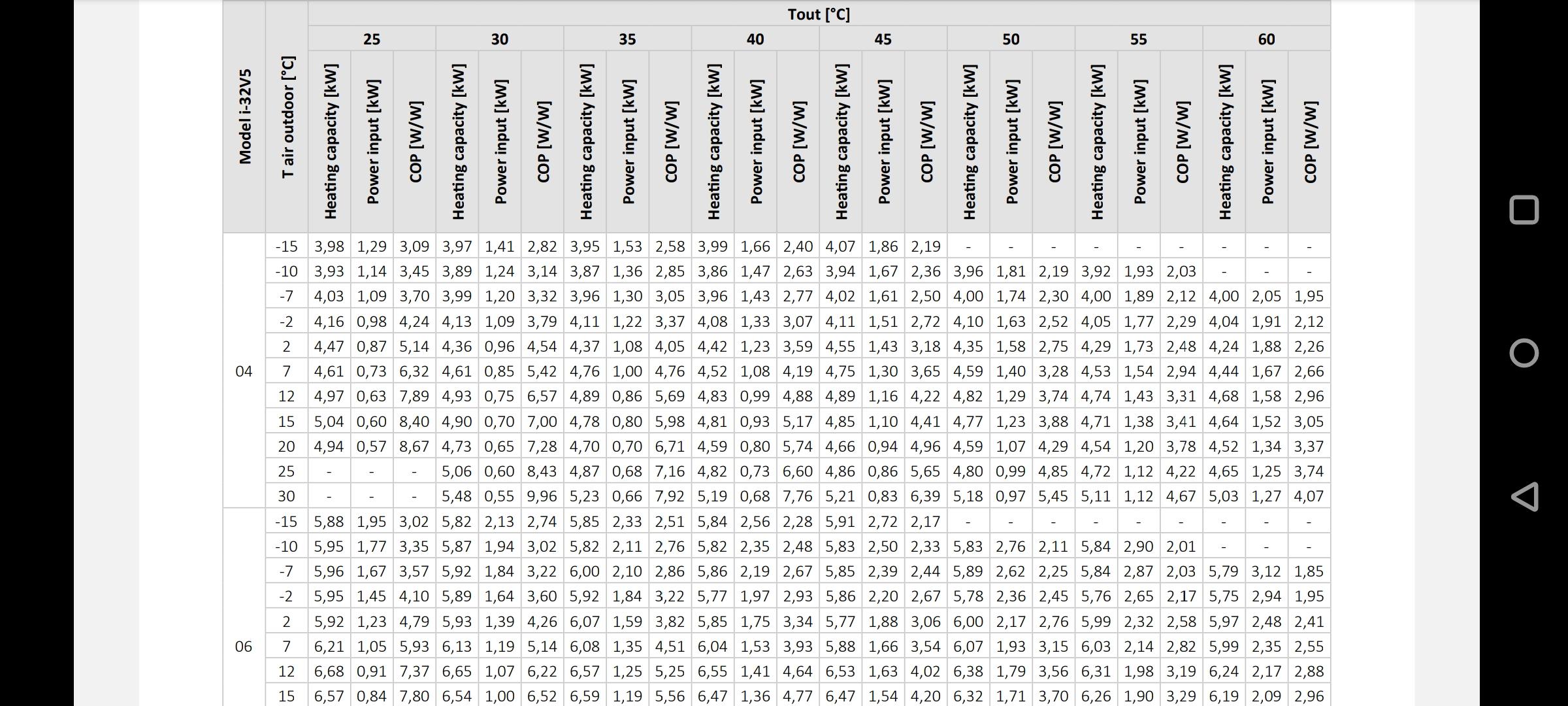

JohnMo Posted March 6 Share Posted March 6 16 hours ago, NailBiter said: Definitely avoid: High winds (causes frosting of the coil), Placement where servicing is hard. Restricted Airflow Not sure where that snippet came from. An ASHP uses a fan to make high winds local to the heat exchanger to ensure good heat transfer. General wind make no difference to frosting of the coil. Link to comment Share on other sites More sharing options...
NailBiter Posted March 6 Author Share Posted March 6 (edited) 2 hours ago, JohnMo said: Unless you want to cool also, then efficiency drops. The issue is a lack of power in December and January due to a lack of sunshine. I am totally unconcerned about power demand during sunny months when we need cooling. We only have a 6kw system in our current house and it provides for most of our needs 8 months of the year. 2 hours ago, JohnMo said: Biggest difference between the OP and the reference property, is the reference property only did DHW for around 1 hour per day. OP will be heating, cooling and DHW, so a different use case. Yes true but it isn't just sunny / warm for 1 hour a day. The goal would be to move both our heating demand and our DHW demand to the period when there is minimal difference between the temperature of the inside and outside unit. With DHW this is easy as you can just store hot water. We can also explore oversizing the ASHP slightly. The heating is a little harder however. My understanding is we can bank heat from about September / October onwards in the thermal mass of the building. On cloudy / very cold days we may be able to avoid running the system entirely. The goal is to put as few units of energy in during winter whilst preserving stable internal temperatures. If the council decide to let me have a wind turbine (tall order but you never know) then I will have all the power I need all year round as December / January is typically plenty windy round by me. I asked the architect about this and he didn't seem hopeful however. 2 hours ago, JohnMo said: So let's assume the sun exposed, heavily build stone area that's designed to trap the sun's heat, ASHP installed close to a south facing wall to get max perceived gains. This is in response to a comment other than mine, personally I wouldn't install high thermal mass I'd just put it in the sun. If I were to surround it with materials I would be looking for low thermal inertia materials that heat easily in the sun (ever trodden barefoot on lead flashing on a roof in full sunshine?). 2 hours ago, JohnMo said: Heating by ASHP running with an internal thermostat. The ASHP for the UFH does not just use a single internal thermostat. We will be measuring both the air temperature and the floor temperature in each zone and can adjust the heating in each zone accordingly. This will be integrated with our Home Assistant instance and will have knowledge of past conditions, current conditions and future predicted conditions (extrapolated from the past combined with weather). 2 hours ago, JohnMo said: Typical nice winters day, cold overnight, zero degs, bright morning, sun out and air temp increases to 7 degs, then by 5pm temp starts to drop quite fast. Overnight the stone area reduces to match ambient air temp of zero, ASHP gets no negative or positive effects from this. The ASHP does not run at night, we have plenty of heat in the building fabric and we will have several hundred litres of hot water at this point. Plenty for the night and the morning. This is the point the differential between inside and outside temperatures is at its highest and therefore efficiency is at its lowest for running the ASHP. 2 hours ago, JohnMo said: Morning air temperature start to rise, stone area remains at close to zero for a prolonged period as sun not high enough in the sky to have any heating effect. ASHP in an area below air temp, negative impact on CoP. Again I personally wouldn't surround the outdoor unit with high thermal mass / thermal inertia materials, I'd also put it somewhere where it was insolated first thing in the morning (very easy for us on our plot). 2 hours ago, JohnMo said: Late morning to late afternoon, sun out and heating stone, sun also on house windows warming house, heating clicks off. DHW clicks on and heat pump starts at 2pm. Localised area could warm air flow to ASHP by say 5 degs (if you are lucky), giving a 0.3 CoP benefit. Heating benefit zero as heat pump is off Can I get a source on these numbers please? They feel like they might be bum plucked. If I could get my entire heating demand via solar gain then I wouldn't have any issue with needing to make sure I am efficiently making use of an ASHP in the first place. This is exactly the point I would be putting a good couple hours heat into the building. In a house the size of ours 0.3. CoP benefit is not to be sniffed at. That is nearly a 10% uplift on standard performance. 2 hours ago, JohnMo said: Early to late evening, temperature outside drop back, some residual heat in stone, but the benefits are marginal, CoP gains for a short period but would guess almost nil. Almost nil != nil so it would depend on the cost to site it in a insolated location vs in the shade as to cost / benefit. Besides by this time the heat pump is off again because the internal / external temperature differential is high again. 2 hours ago, JohnMo said: Cooling case case almost the opposite, sun out you need cooling, ASHP is hot sun trap, EER (CoP when cooling), takes a hit. When flowing 12 degs changing air temp from 20 to 25 has a 1.2 negative impact on EER. Cooling is not a concern for multiple reasons. Mostly the heat capacity of the building but also the fact it is mostly solar powered. When there is cooling demand there is available power. I know there is no such thing as a free lunch which is why I'm trying to shift demand from when I don't have spare power (winter) to when I do (9 months of the year). 2 hours ago, JohnMo said: Another negative is weather compensation becomes screwed up, if the temperature probe becomes exposed to artificial low or high temperatures. This is a solved problem, the manufacturers worked out you can place the sensor in a sensible location and run the fan at full quickly before taking a reading. It is all detailed in one of the links above. Edited March 6 by NailBiter Link to comment Share on other sites More sharing options...

JohnMo Posted March 6 Share Posted March 6 51 minutes ago, NailBiter said: My understanding is we can bank heat from about September / October onwards in the thermal mass of the building. On cloudy / very cold days we may be able to avoid running the system entirely. Wish it was true. It would be nice, my 57 tonnes of concrete floor and about 65 tonnes in the walls would beg to differ. 1 1 Link to comment Share on other sites More sharing options...
JohnMo Posted March 6 Share Posted March 6 56 minutes ago, NailBiter said: Can I get a source on these numbers please? They feel like they might be bum plucked. I don't bum pluck numbers, CoP numbers for different flow temps and outside temps. With this I will bow out and let you dream on. 1 1 Link to comment Share on other sites More sharing options...

NailBiter Posted March 6 Author Share Posted March 6 (edited) 43 minutes ago, JohnMo said: I don't bum pluck numbers, CoP numbers for different flow temps and outside temps. With this I will bow out and let you dream on. It isn't so much a case of dreaming on as much of a case of trying to get the maximum efficiency from installed systems. As has repeatedly been pointed out this house is large but that means even small efficiency savings can have a large impact. I'm slowly discovering how much conflicting information is out there and it is hard to know what to do. I really appreciate you citing your data source, I don't mistrust anyone in particular but data wins arguments. Edited March 6 by NailBiter Link to comment Share on other sites More sharing options...
