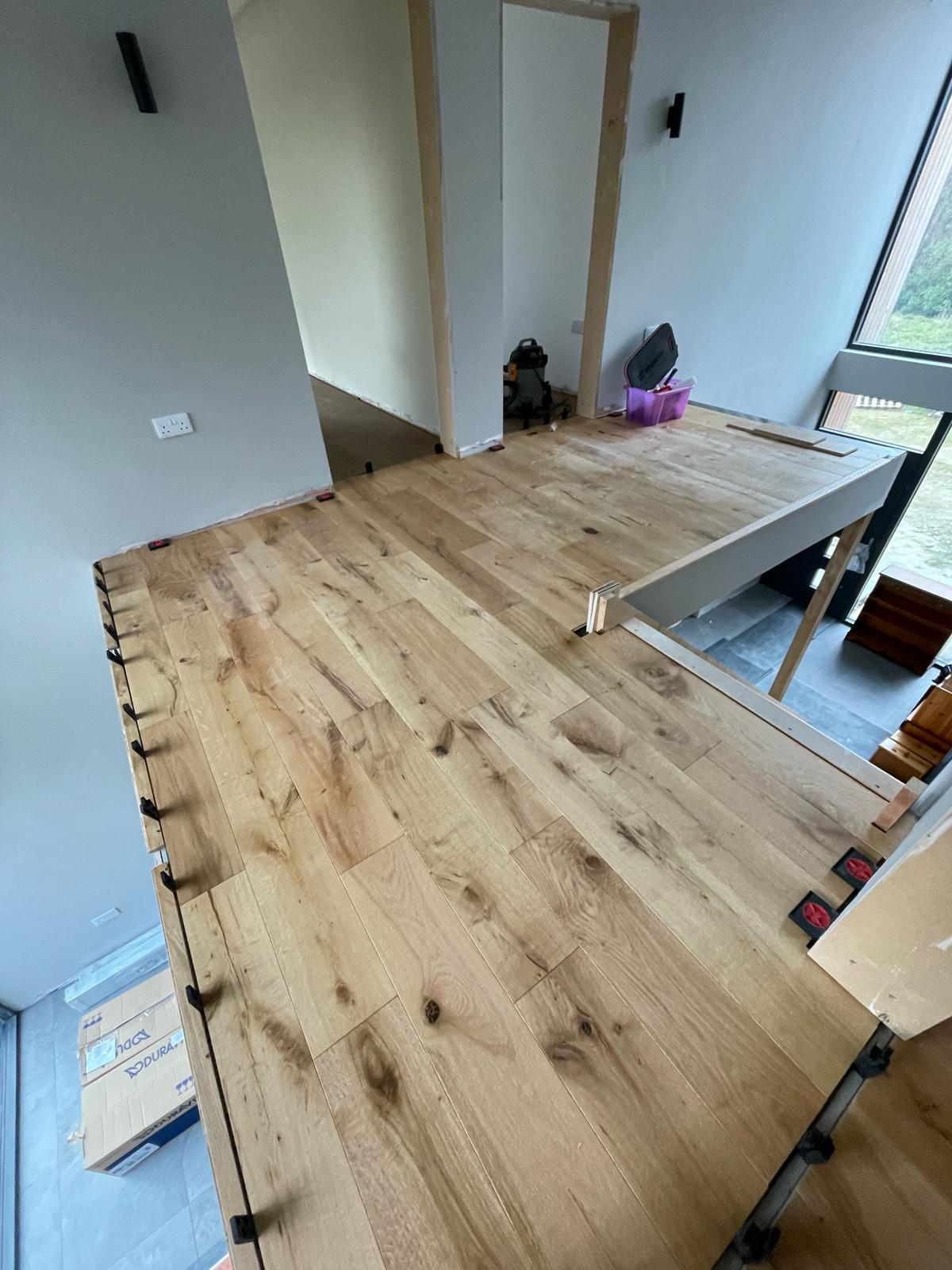

Thorfun Posted February 26 Author Share Posted February 26 (edited) thanks all so far for the responses. another thing if I may. we have 14mm engineered wood flooring on that landing fitted with an underlay (so floating). my builder mate said he was concerned about fixing through the floating 'thin' layer and down into the chipboard and subsequent timbers and I should cut the finished floor out and fix directly to the chipboard and through. that seems to make sense to me but I'm struggling to understand the reasoning behind it as surely the fixing will then go down in to the timbers anyway so why does it matter if there's a thin floating floor between the profile and the solid timber? any of you knowledgable folk care to shed some light on that one please? Edited February 26 by Thorfun added photo Link to comment Share on other sites More sharing options...

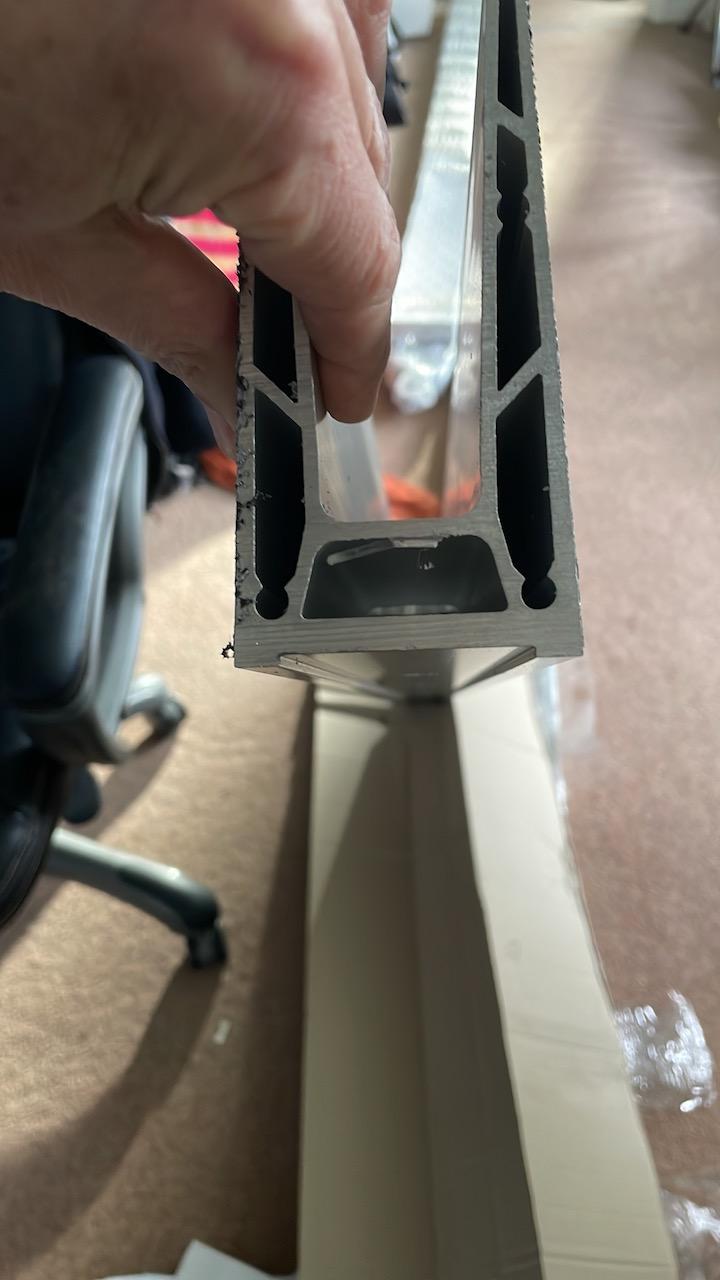

joe90 Posted February 26 Share Posted February 26 (edited) 24 minutes ago, Thorfun said: fitted with an underlay These are usually very thin, how thick is yours? Frankly m12 coach screws every 300mm will crush that IMO and the engineered boards will spread the load even further. i take @saveasteading ,s point about heads pulling through the aluminium so steel washers would be good, as big as possible, penny washers and cut down width wise to fit in the space. (what I don’t get from the pics above it shows the bolt heads below an aluminium web so does this have holes to enable bolts to be fitted to the bottom rail? ) Edited February 26 by joe90 Link to comment Share on other sites More sharing options...
Thorfun Posted February 26 Author Share Posted February 26 (edited) 1 hour ago, joe90 said: These are usually very thin, how thick is yours? Frankly m12 coach screws every 300mm will crush that IMO and the engineered boards will spread the load even further. 14mm. 3mm veneer and 11mm ply (approx). I'm not sure from your answer if the crushing is a good thing! it doesn't sound it to me and it sounds like there might be a slope as the underlay and flooring is crushed? 1 hour ago, joe90 said: (what I don’t get from the pics above it shows the bolt heads below an aluminium web so does this have holes to enable bolts to be fitted to the bottom rail? ) yes. do these photos help? Edited February 26 by Thorfun added a second photo Link to comment Share on other sites More sharing options...
joe90 Posted February 26 Share Posted February 26 (edited) 6 minutes ago, Thorfun said: 14mm. 3mm veneer and 11mm ply (approx). I'm not sure from your answer if the crushing is a good thing! it doesn't sound it to me and it sounds like there might be a slope as the underlay and flooring is crushed? No the engineered flooring won’t crush but the thin underlay (foam?) will slightly and I bet it’s about 2 or 3 mm only 🤷♂️ 6 minutes ago, Thorfun said: does this photo help? No 🤣 how do you get the screw through that upper web, does it have a hole to give access to the bottom ? Ah, you said “yes” to holes…. Edited February 26 by joe90 Link to comment Share on other sites More sharing options...

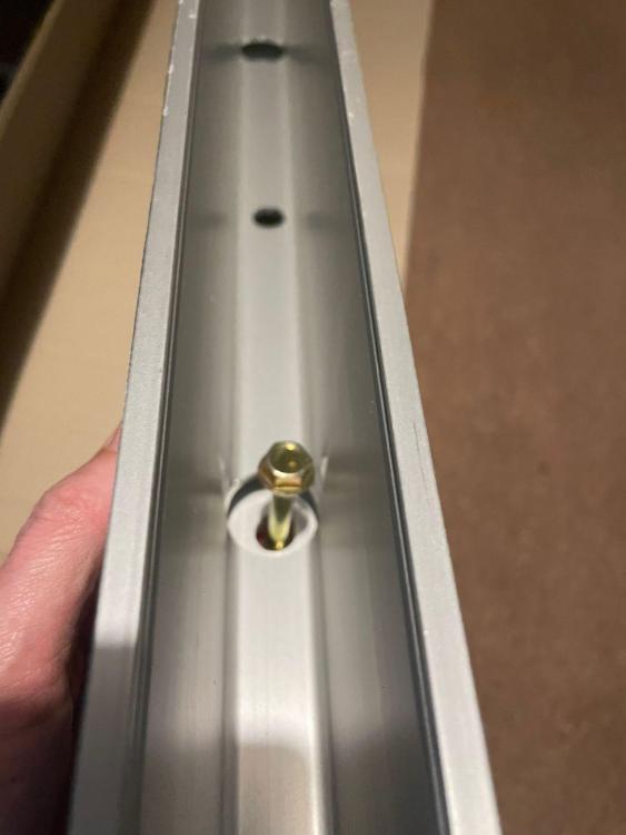

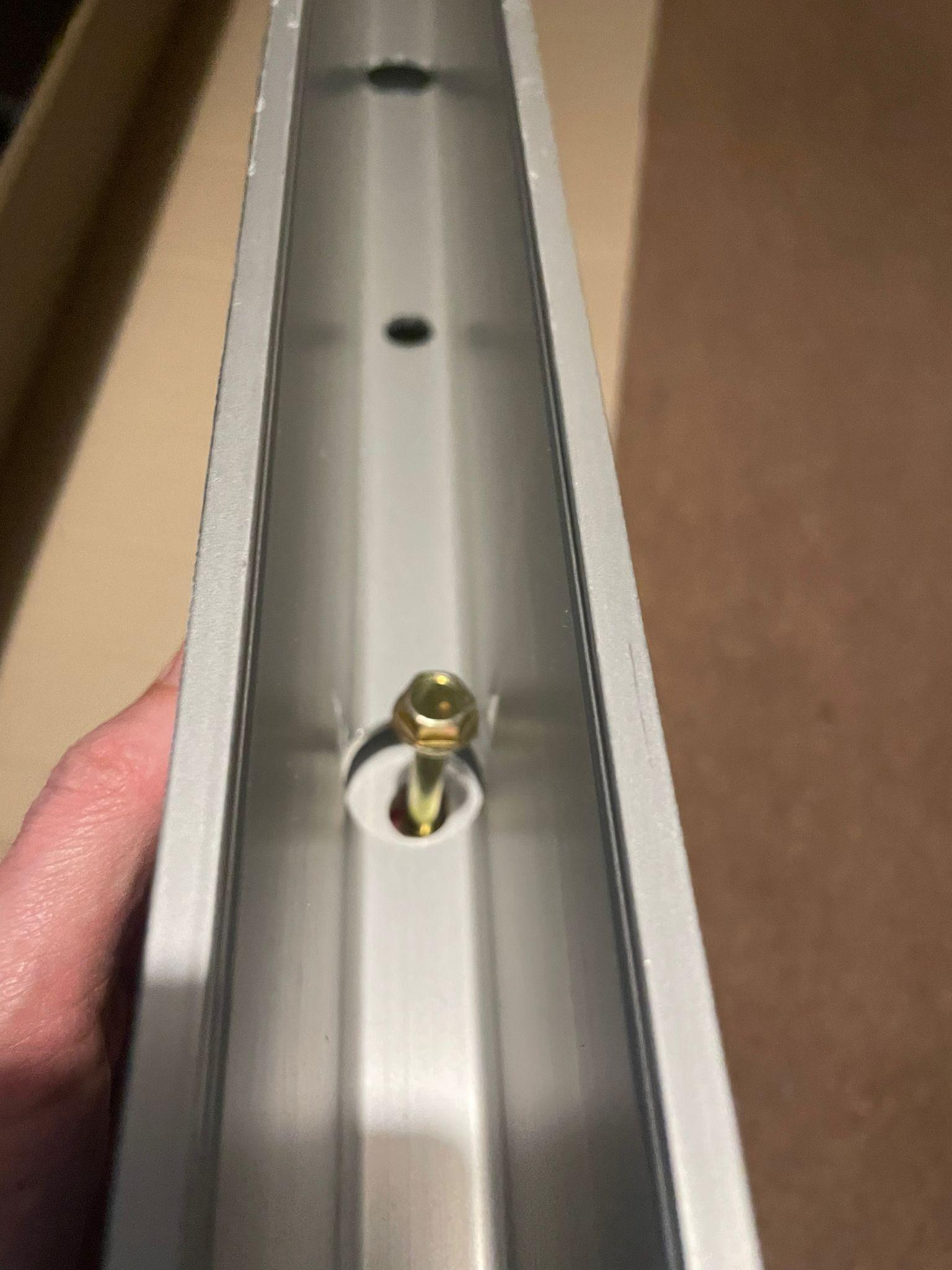

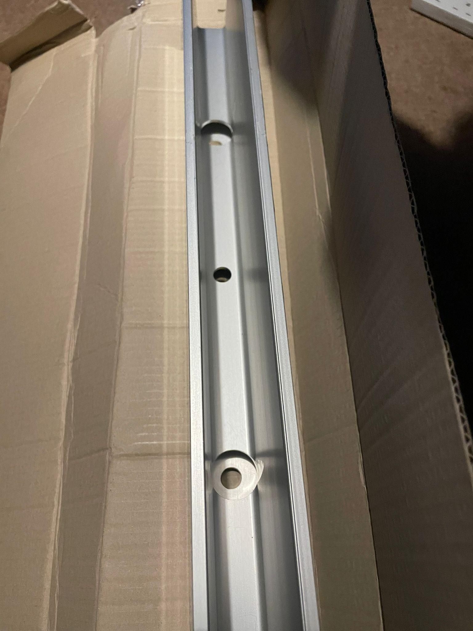

Thorfun Posted February 26 Author Share Posted February 26 Just now, joe90 said: No the engineered flooring won’t crush but the thin underlay (foam?) will slightly and I bet it’s about 2 or 3 mm only 🤷♂️ 5mm 4 minutes ago, joe90 said: No 🤣 how do you get the screw through that upper web, does it have a hole to give access to the bottom ? yes. the screw just fits through. Link to comment Share on other sites More sharing options...
joe90 Posted February 26 Share Posted February 26 Ah those photos came to me late. IMO (others may disagree) 5mm foam under engineered flooring won’t cause a problem because the engineered flooring will spread the load far more than that ally profile would, 200mm screws into the glulam with steel washers will be suffice. Am I qualified as an SE, NO, but years of practical knowledge and a tendency to over engineer has stood me in good stead. I would be interested in other opinions. 2 Link to comment Share on other sites More sharing options...

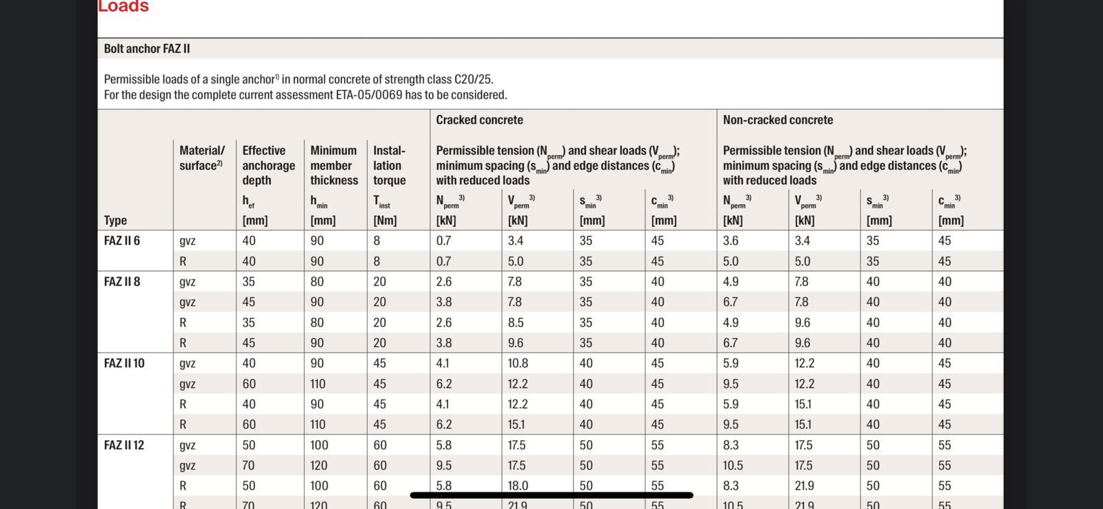

Thorfun Posted February 26 Author Share Posted February 26 (edited) ok. I sent the information to a friend who's a civil engineer and he sent me the following table which I believe is for the fixings the manufacturer used for their testing the manufacturer states that their tests were performed with FISCHER FAZ 11 12/10 fixings and my engineer friend stated that if I can get timber fixings that have a 10kN pull out I'm all good. he then said Quote An m12 coach screw with 90mm thread going into the structural beams below works, I would of suggested a Hilti screw but the head will break off at 5kN so needs to be a TIMco din571 or equivalent, you will need to pre-drill, suggest just get the 150mm long ones so I'll be looking for TIMco din571 or equivalent M12 x 150mm coach screws! I asked him about the floating floor and he said Quote You could core a hole down to the structural timber to match the balustrade hole spacing and use a steel pipe as a sleeve and tighten it down, leaving the floor still floating so a small gap which sounds like an interesting idea and also mitigates the concern my builder mate has about the floating floor. although I would have to buy some steel pipe! I hate to tag you @Gus Potter but I'm going to anyway (sorry!). are you able to cast your eye over the above and see if you agree with the findings please? and any other recommendations before I put this to bed and get on with doing some work? Edited February 26 by Thorfun reworded bits to make a bit more sense, I hope! Link to comment Share on other sites More sharing options...

saveasteading Posted February 27 Share Posted February 27 I am nervous about fixing it over a flexible surface. It will rock if shaken, and crush the underlay. Then it moves even more etc. I've had a steel barrier come loose (rawlbolts to concrete) through repeated pushing by children, because once it starts to rock it becomes a game/ challenge. Perhaps if tightened down hard enough the floor will compress and resolve this. I would do this by fixing the whole system, then repeatedly tightening from end to end That brings us back to the weakest link being at the nut to aluminium interface. It needs hefty steel washers or plates. I've seen steel cladding sheets ripped off screw fixings. The sheet fails before the screw. Aluminium is much softer. I am rather shocked that the manufacturer doesn't specify how to fix your rail in any way. On a positive note, If the ends are also fixed into walls or at returns then this issue will be much reduced. @Gus Potter sometimes looks at my input so I'll @ him too, but he is probably busy doing paid work. Don't panic though. steel coach screws n every fixing hole, with washers, tightened up til the floor compresses and the screws stop tight, and all is probably ok. Fixing direct to the floor board is best though. 1 Link to comment Share on other sites More sharing options...
Thorfun Posted February 27 Author Share Posted February 27 52 minutes ago, saveasteading said: I am rather shocked that the manufacturer doesn't specify how to fix your rail in any way. they do. just in to concrete. it's "not tested in to timber" seems to be the stock answer and so they cannot advise. 53 minutes ago, saveasteading said: On a positive note, If the ends are also fixed into walls or at returns then this issue will be much reduced. simply not possible now. well, it is but it'll involve way too much upheaval at such a late stage in the build I don't want to do it. plus the frameless balustrade has already been bought and we don't have the money to get it re-done. 😞 54 minutes ago, saveasteading said: Fixing direct to the floor board is best though. yeah, that's what my builder mate says too. I told him about my engineer mate's suggestion of coring through to the timbers and using steel pipe as a spacer and he was a bit sceptical. said things along the line of "he's thinking like an engineer" which wasn't a slur but more that it's a different way of approaching the issue. I'm sure both ways will work and it would come down to whether I trust science or experience! Link to comment Share on other sites More sharing options...
joe90 Posted February 27 Share Posted February 27 I agree that steel washers are a good idea above soft aluminium, however, the system must be tested to be fit for purpose. I still say engineered ply above the underlay will spread the load over a much greater surface so think it will be fine. Still if the engineered timber can be lifted a section of the foam where the bolts are could be replaced with 5mm aluminium/steel/ hardwood. 1 Link to comment Share on other sites More sharing options...
saveasteading Posted February 27 Share Posted February 27 3 hours ago, Thorfun said: they do. just in to concrete what do thy say should be used into concrete? the fixing into timber isn't my concern, rather the aluminium and the underlay. 3 hours ago, Thorfun said: "he's thinking like an engineer" Engineer/ ingenuity. You've asked for a way to do this without removing the floor covering...spacers is his answer. 1 Link to comment Share on other sites More sharing options...

Thorfun Posted February 28 Author Share Posted February 28 9 hours ago, saveasteading said: what do thy say should be used into concrete? the fixing into timber isn't my concern, rather the aluminium and the underlay. they tested using FISCHER FAZ 11 12/10 fixings in to concrete and from the spec sheet of those it was determined I need fixings with a 10kN pull out resistance. which led to the M12 x 160mm coach screw decision. 9 hours ago, saveasteading said: Engineer/ ingenuity. You've asked for a way to do this without removing the floor covering...spacers is his answer. indeed. it was an ingenious solution but I just don't know if it was the right one. especially considering @markc's explanation of the forces involved when using the spacers. Link to comment Share on other sites More sharing options...
