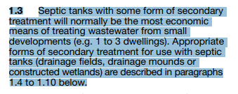

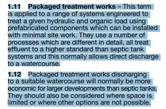

saveasteading Posted February 25 Share Posted February 25 The Scottish reg's contain a formula for the drainage field size, allowing a 20% reduction from that for a septic tank to that for a packaged treatment tank. This is a ridiculously small reduction in my opinion, and seldom insisted on from what we hear. The English reg's used to be the same, from memory, but now appear not to require a drainage field for a package plant: which I think is sensible. Note that there is no mention of a drainage field, whereas there is in clause 1.3 for a septic tank. Plus, how could they be more economic unless there is no need for a drainage field? I welcome any proof to the contrary (building inspector asking for it doesn't count). (Welcome isn't the right word.....as I hope none of us needs a drainage field.) I've also noticed that the government regulation, as linked above, describes treatment packages as being mechanically aided. This omits the middle ground of a non-mechanical 3 stage tank which works pretty well but is not generally available these days......I wonder if the Scottish rules were designed for this and have never been reconsidered. This may not help when the planners state a P limit, but that's another matter. Link to comment Share on other sites More sharing options...
ProDave Posted February 25 Share Posted February 25 ^^^ ALL that is saying is a TP can discharge to a watercourse, but a ST can't so must drain to a soakaway. If you have no watercourse available it will need a soakaway. In Scotland SEPA are less keen on discharge to a watercourse and only allow it if no suitable land drainage option is available. Yet SEPA are not enforcing existing septic tanks discharging to a watercourse to be upgraded Link to comment Share on other sites More sharing options...
saveasteading Posted February 25 Share Posted February 25 2 hours ago, ProDave said: If you have no watercourse available it will need a soakaway. It has to go somewhere. The Scottish regs say, to a drainage field , @ProDave 's 85m2. Ours was even more but we haven't got round to the phase B bit yet and the BCO was happy anyway. But apparently, acc to the jcb operator, a soakaway (pit of rubble) is usually accepted. My premises is that the English regs make no such demand. At most it would be a pit or lateral soakaway for the daily amount of water going through, say 1000 litres, not as additional treatment. 2 hours ago, ProDave said: SEPA are not enforcing existing septic tanks discharging to a watercourse to be upgraded It's government policy according to how old it is. Link to comment Share on other sites More sharing options...
