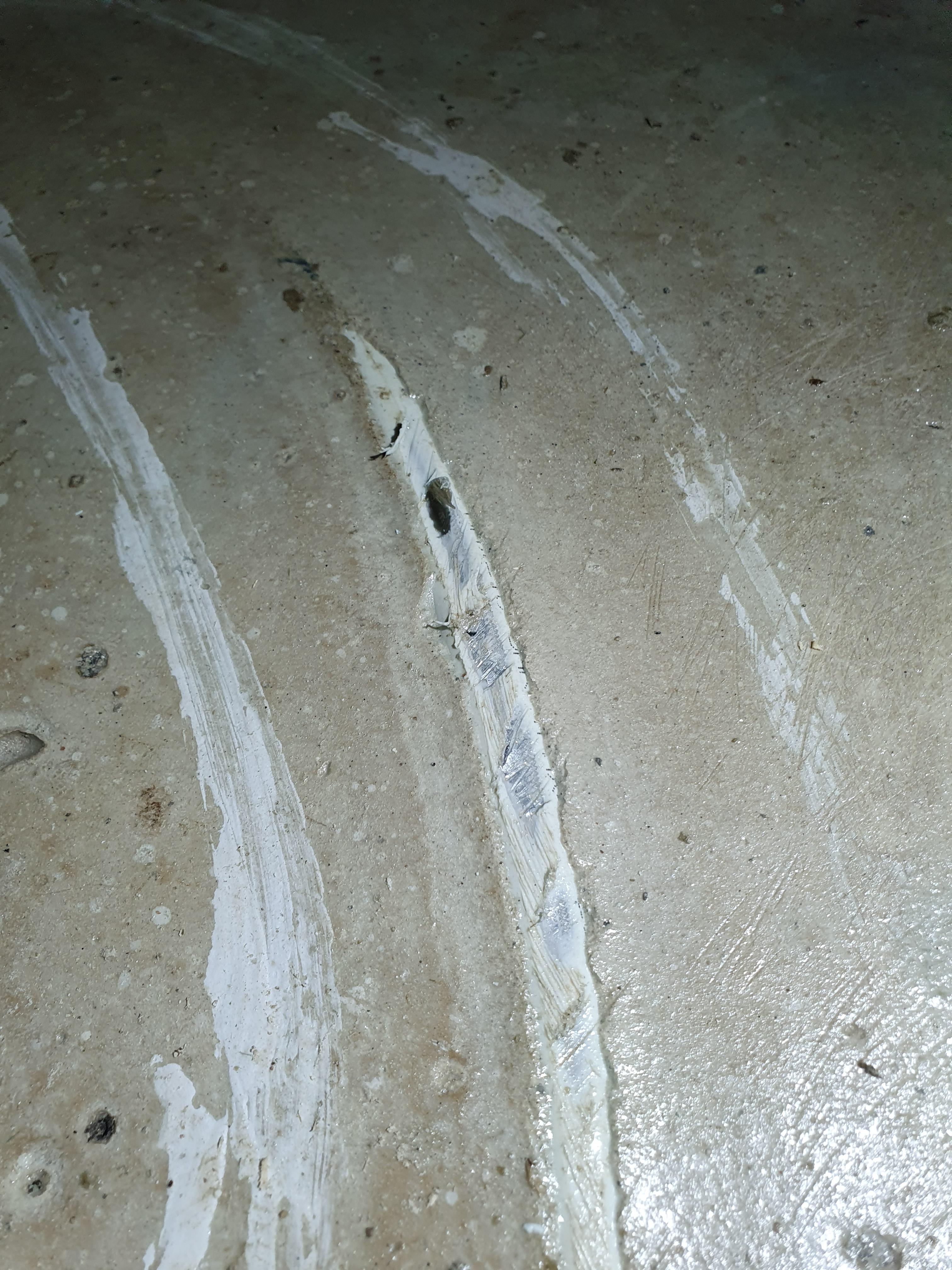

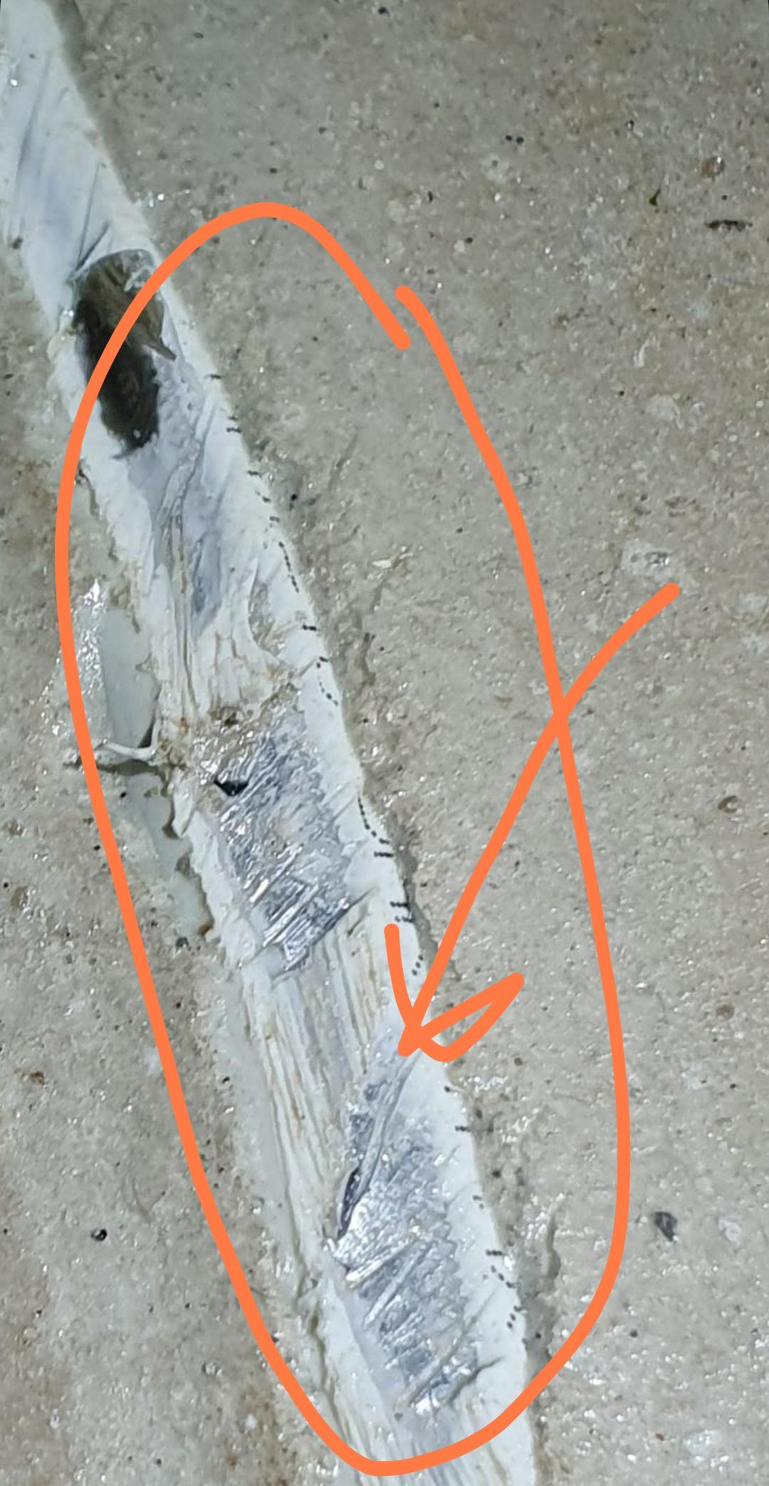

Tom Posted February 22, 2024 Posted February 22, 2024 So inspite of making people abundantly aware of this exposed UFH pipe in my screed they have still managed to go over it with the floor grinder. The outer PEX layer has been taken away in a few places and the inner alu layer scratched. No holes fortunately and the system is still pressurised. There is a few mm of latex screed going down next, then an engineered wood floor. Should I leave alone or get it cut out and replaced? I'm worried that cutting it out will cause more issues and then there are two compression fittings to leak in future. Thoughts? 1
Iceverge Posted February 22, 2024 Posted February 22, 2024 Ah that's disappointing. The trials of self building eh. I would bite bullet and pull it up. There's some quite deep scratches in the pipe, they may be ok now but I wouldn't trust the aluminium not to degrade over time and leak. Is it a single room? Can you lift the whole loop. Can you isolate the loop and do without?
Conor Posted February 22, 2024 Posted February 22, 2024 I feel your anguish. After nicking a pipe with a grinder while making room for a shower tray, I decided to leave it. It was pressurised, pipe didn't swell or leak. Though if it ever did leak I'd just isolate and forget about it... Only a small WC that has a towel rad anyway. However... That's significant damage. The aluminium layer is there as a gas barrier and will degrade now it's exposed. Aluminium and cement do not like eachother.
Tom Posted February 22, 2024 Author Posted February 22, 2024 Thanks both. The floor people have accepted liability (how generous!) although not actually apologised. They are paying for the plumber to dig out that section of pipe and replace. However I will now be left with two compression fittings buried under the floor. Honestly, the level of incompetence displayed by some people is astounding and is a never ending source of wonder and amazement to me. 3

Andeh Posted February 22, 2024 Posted February 22, 2024 We've had compression fittings last fine. Reality is, you'd detect with a damp meter through the carpet if an issue was suspected. Carpet lift and refit no issue, fix, refit. ... Few £100 and days work should worse case happen. Worse shit happens. Average house probably has several dozen pipe joints all over the place! Get them rejointed, pressurise over a weekend to ensure pressure is fine... Forget and move on!!! 2
Post and beam Posted February 22, 2024 Posted February 22, 2024 5 hours ago, Tom said: The floor people have accepted liability Then the entire loop has to be replaced, no brainer. You will never stop worrying about this if its not. Have you got their admission in writing? If so insist that you cannot have a joint in a UFH pipe. 2 1

Iceverge Posted February 23, 2024 Posted February 23, 2024 I would cut the three sections back to virgin pipe. It might need to be done with hand tools and slowly. Tooth brushes for the last few bits. I wouldn't let the floor grinding knuckle draggers near it. You'll probably need to do it yourself and charge them for it. Put in 6 joiners and 3 new sections of pipe. Those multilayer fittings with the built in inserts are pretty bombproof. Then pressure test the pipes. Then wrap all the exposed pipe in cling film to protect the joints from the screed and make it easier to repair if needed in future Repour the concrete and forget about it. Charge the grinding company for your time and put it down to experience.

Tom Posted February 23, 2024 Author Posted February 23, 2024 2 hours ago, Iceverge said: I would cut the three sections back to virgin pipe. Only one pipe is damaged - the other two white marks are where I painted around the pipe in white emulsion to highlight it. That and marking where the pipe was on a floor plan and telling them to not to effing go near it I thought would have been sufficient, clearly not!
