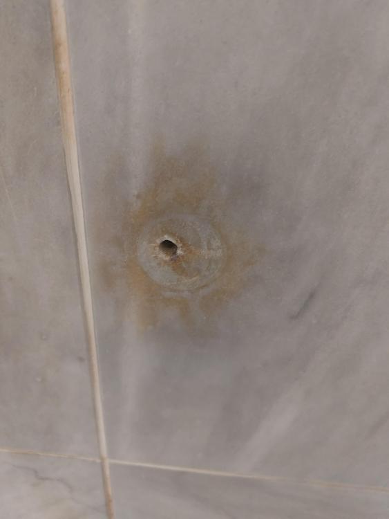

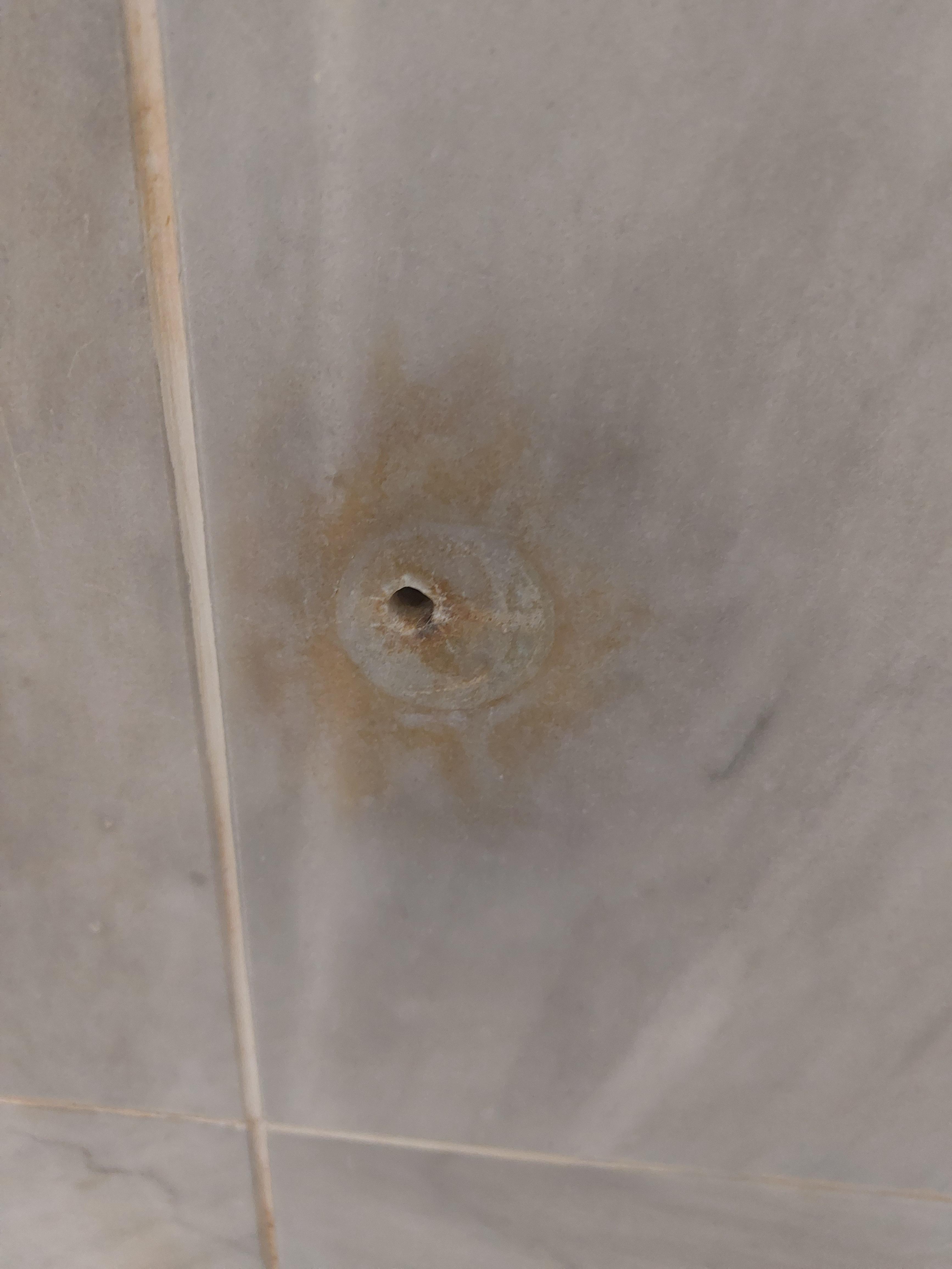

saveasteading Posted February 17 Share Posted February 17 One of the screws on our shower has rusted to failure, leaving a stain. For replacement I will use a branded SS screw, as I always do, in recent years, for wet locations. I've tried baking powder, toothpaste, detergent, vinegar and all combinations ( yes, including mixing acid and alkali, as at least there is bubbling.) Any ideas? Perhaps a big SS or chrome washer if nothing works. Link to comment Share on other sites More sharing options...
joe90 Posted February 17 Share Posted February 17 It looks like the rust is under the gloss surface of the tile, marble is quite absorbent so might be within the tile 🤔. Link to comment Share on other sites More sharing options...
saveasteading Posted February 17 Author Share Posted February 17 1 minute ago, joe90 said: under the gloss surface Yes I'm afraid so. But if it went in, and it's visible, then Snibbo might also get in, and neutralise or remove it? 1 Link to comment Share on other sites More sharing options...

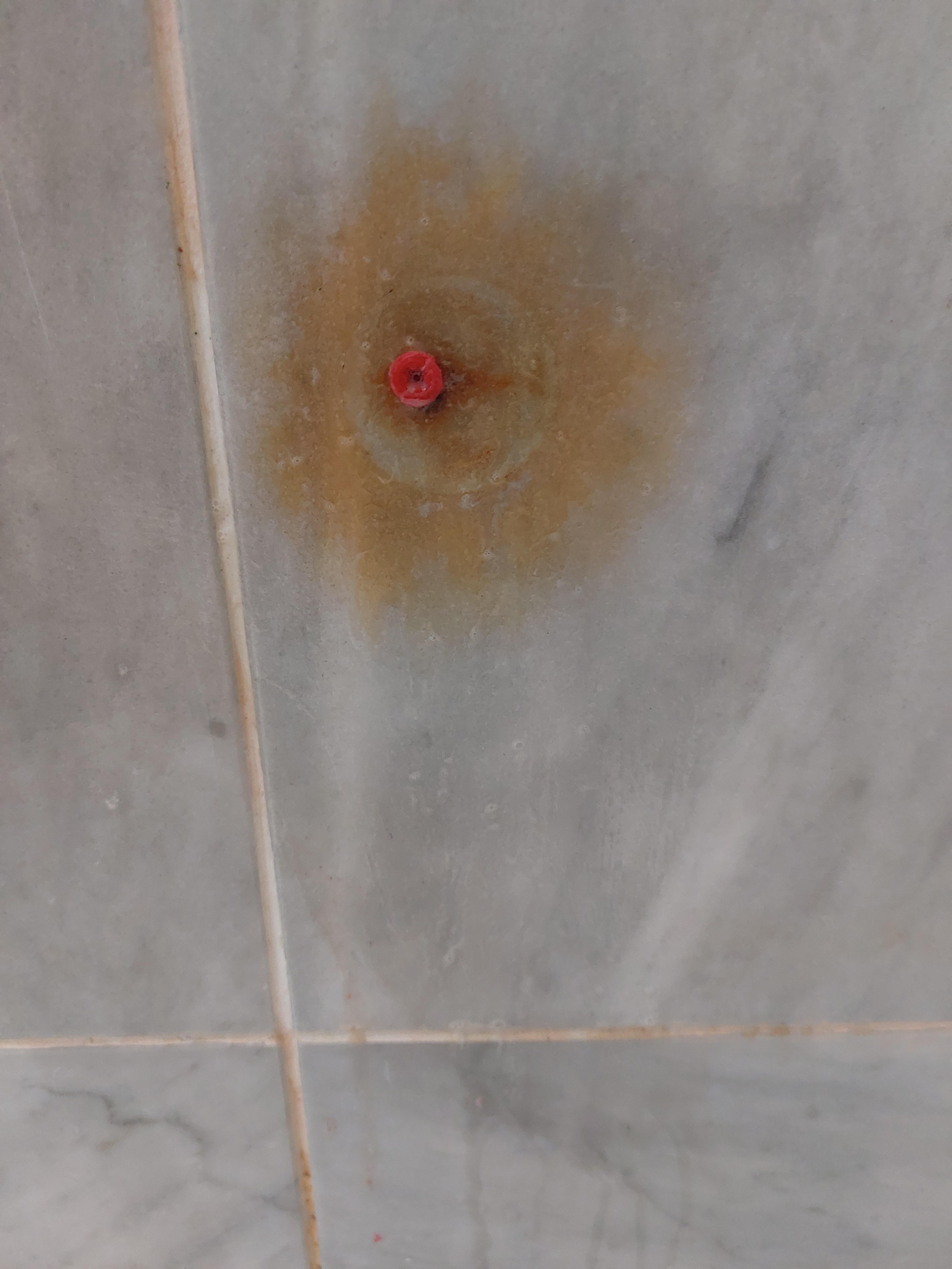

saveasteading Posted February 25 Author Share Posted February 25 Toothpaste, bicarb, vinegar didn't work at all. I found the Rustex to be readily available online. Used that in multiple brush on/ wash off applications. The rust turns purple then comes off. Most of it anyway. the remaining stain must be embedded, yet the chemical doesn't reach it. I haven't worked out why the stain is less beneath the round plastic fixing. Going to refix for now. Thanks for the advice. Link to comment Share on other sites More sharing options...
