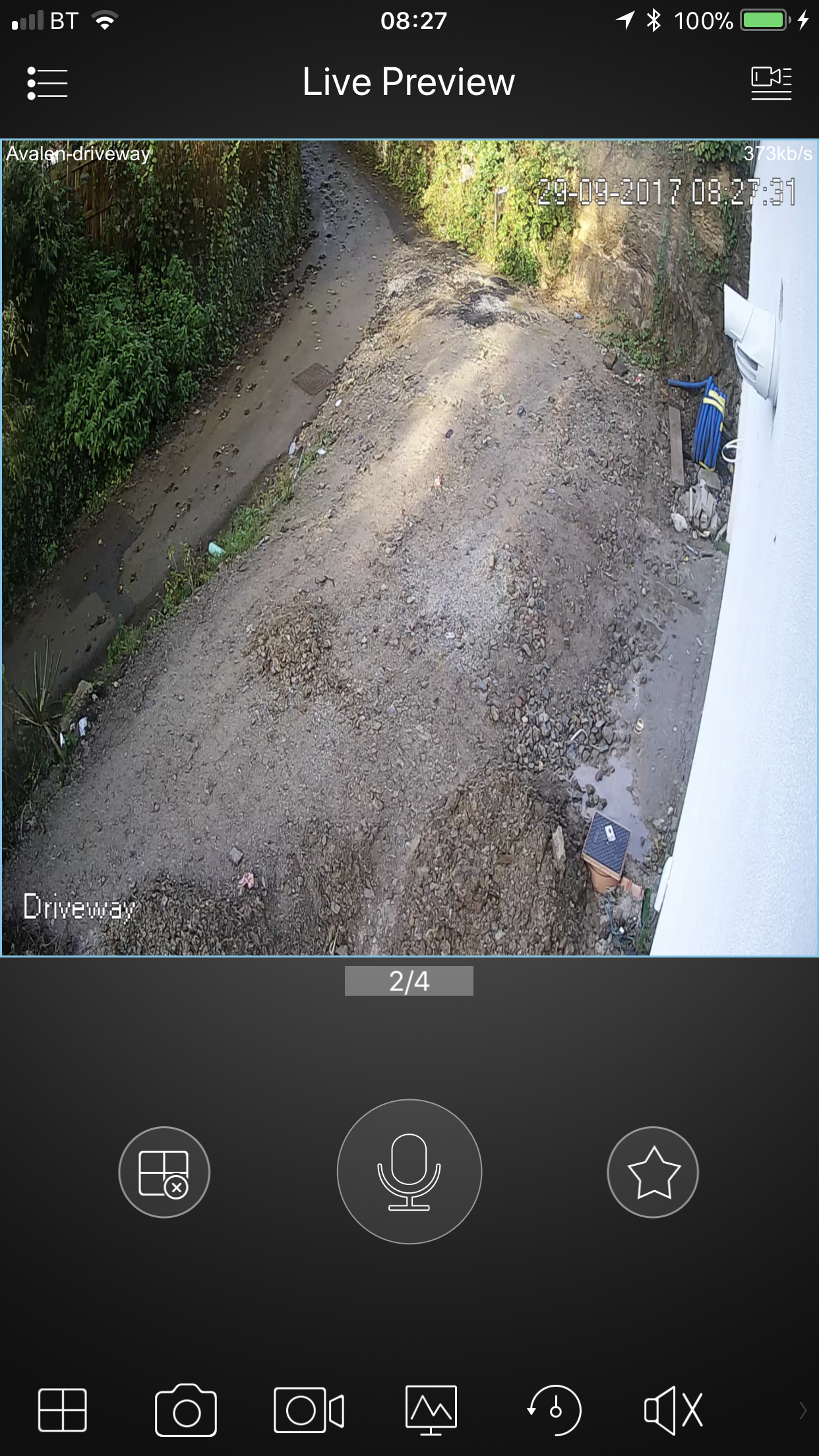

Grosey Posted September 28, 2017 Posted September 28, 2017 What a goon, CCTV was installed 6 months ago, Boiler was installed today... Dont feel sorry for me, it’s made me laugh quite hard and my Facebook friends laugh even harder! 2
ProDave Posted September 28, 2017 Posted September 28, 2017 Sory not making sense. looks like snow falling off a roof? What am I looking at?
jack Posted September 28, 2017 Posted September 28, 2017 CCTV is looking at the outlet of his boiler!

Grosey Posted September 28, 2017 Author Posted September 28, 2017 19 minutes ago, ProDave said: Sory not making sense. looks like snow falling off a roof? What am I looking at? My boiler flue has essentially created a smoke machine completely engulfing my security camera, which is 10x worse in night vision

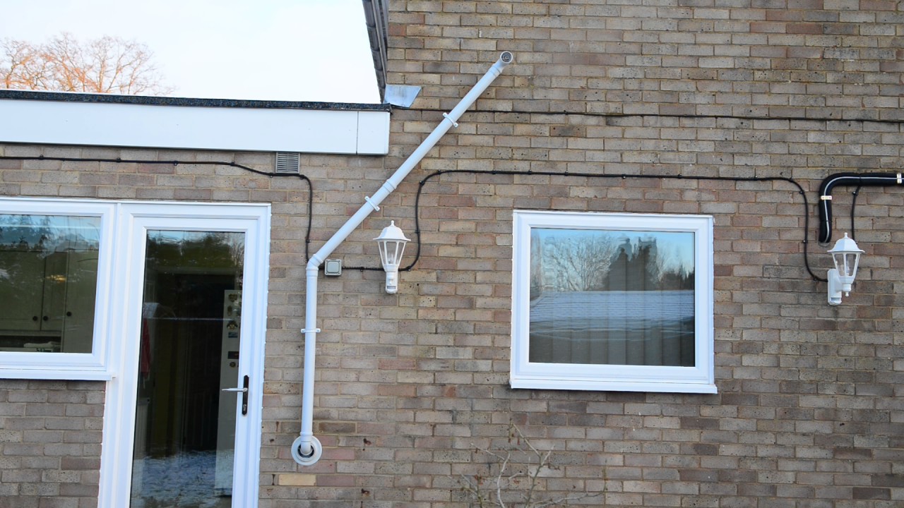

Jeremy Harris Posted September 28, 2017 Posted September 28, 2017 @Nickfromwales can confirm this, or otherwise, but you may be able to fix this with a flue extension. A new house was built up the road from us a couple of years ago, and they had to fit a sort of "periscope" arrangement to their boiler flue, to avoid it blowing out across a footpath, and something like that might be a solution for your problem. 1
SteamyTea Posted September 28, 2017 Posted September 28, 2017 https://www.youtube.com/watch?v=E8AvfXar9zs

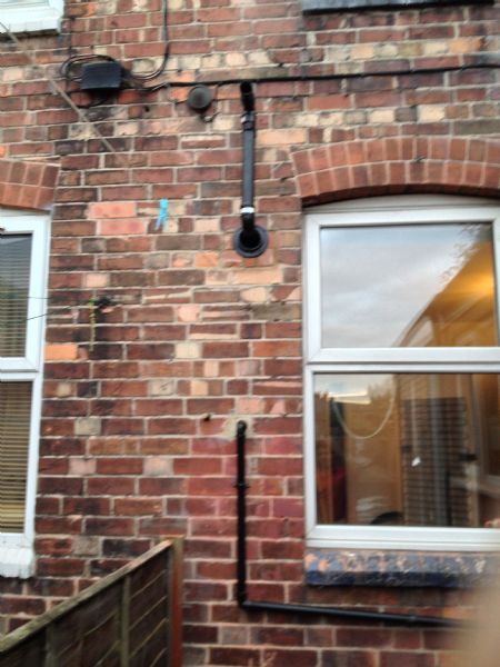

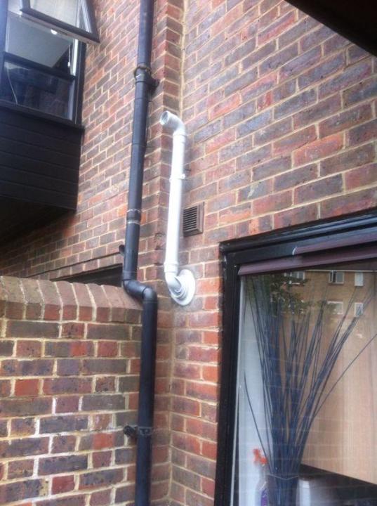

Nickfromwales Posted September 28, 2017 Posted September 28, 2017 2 hours ago, JSHarris said: @Nickfromwales can confirm this, or otherwise, but you may be able to fix this with a flue extension. A new house was built up the road from us a couple of years ago, and they had to fit a sort of "periscope" arrangement to their boiler flue, to avoid it blowing out across a footpath, and something like that might be a solution for your problem. Yup. These kinds of thing :- g These are called, "plume management kits" and can be all sorts of crazy arrangements for redirecting nuisance plume. .

Jeremy Harris Posted September 29, 2017 Posted September 29, 2017 Thanks, @Nickfromwales, those first photos look exactly like the "periscope" arrangement on the house down the road, and are exactly what I was thinking of. I shall try and remember that they are called plume management kits! It looks easy enough to retrofit one of these to an installation, looking those photos, so my guess is that one may offer an easy fix for the problem that @Grosey is having.
Nickfromwales Posted September 29, 2017 Posted September 29, 2017 It does sometimes require the original flue to be either cut back, or replaced if it's too short.
Grosey Posted September 29, 2017 Author Posted September 29, 2017 Unfortunately I can’t see the wife agreeing to any form of plume management! Its not too bad during the day, the night vision makes it much worse. I’ll see how it works out over time but it’s more likely to become a security camera move than anything else. Photo shows it running now in daytime -
