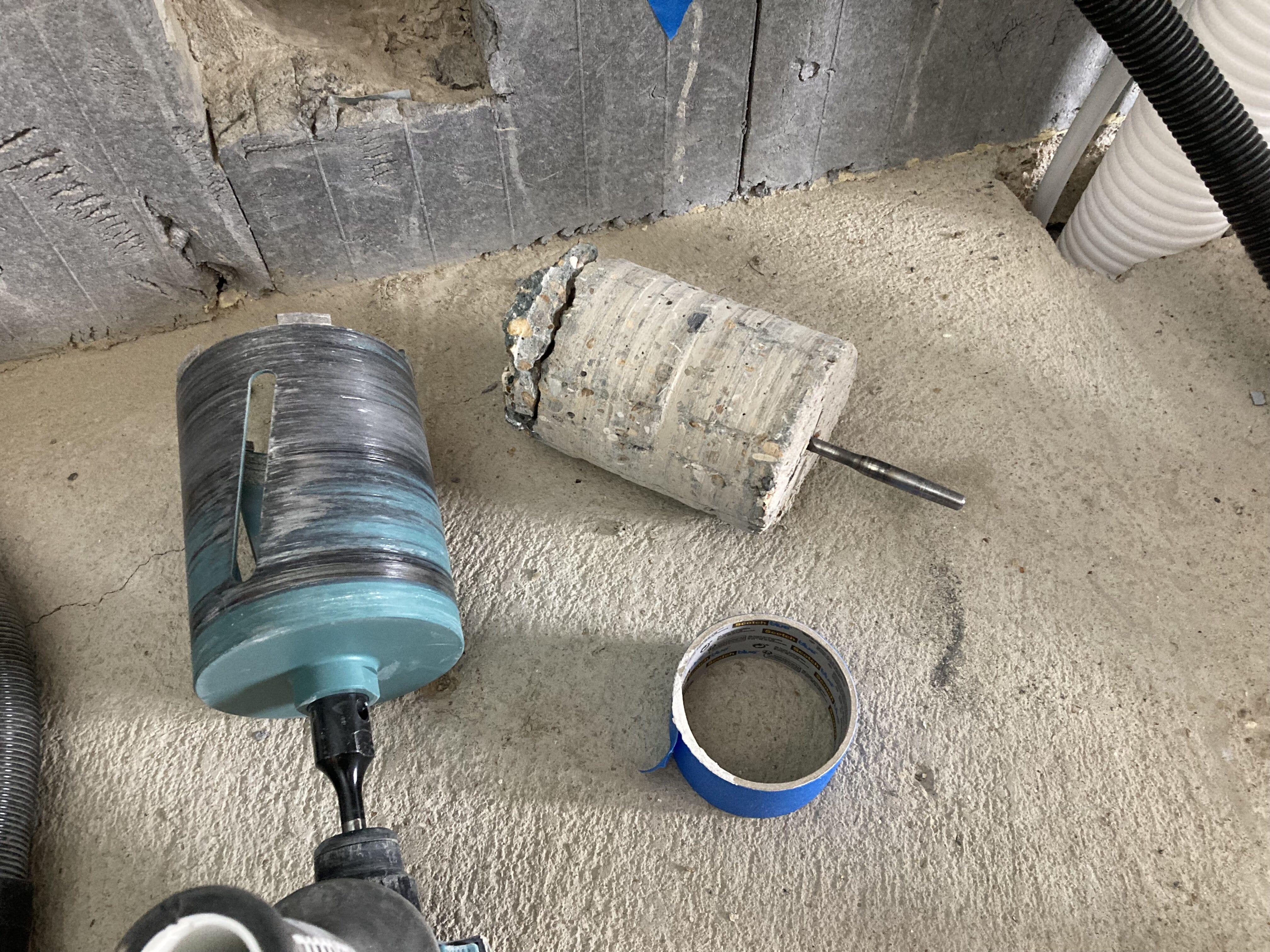

I was lucky, I was able to have most of the penetrations in place before the concrete pour. I did however have to drill one 110mm SVP hole through 150mm ICF concrete wall and two 50mm waste pipe holes through the same wall.
I used my Makita SDS drill with the Erbauer diamond tripped core drill bit from Screwfix.
https://www.screwfix.com/p/erbauer-diamond-core-drill-kit-3-cores/96229
The one hole killed the core bit. If you can, I would pay someone to do it for you.

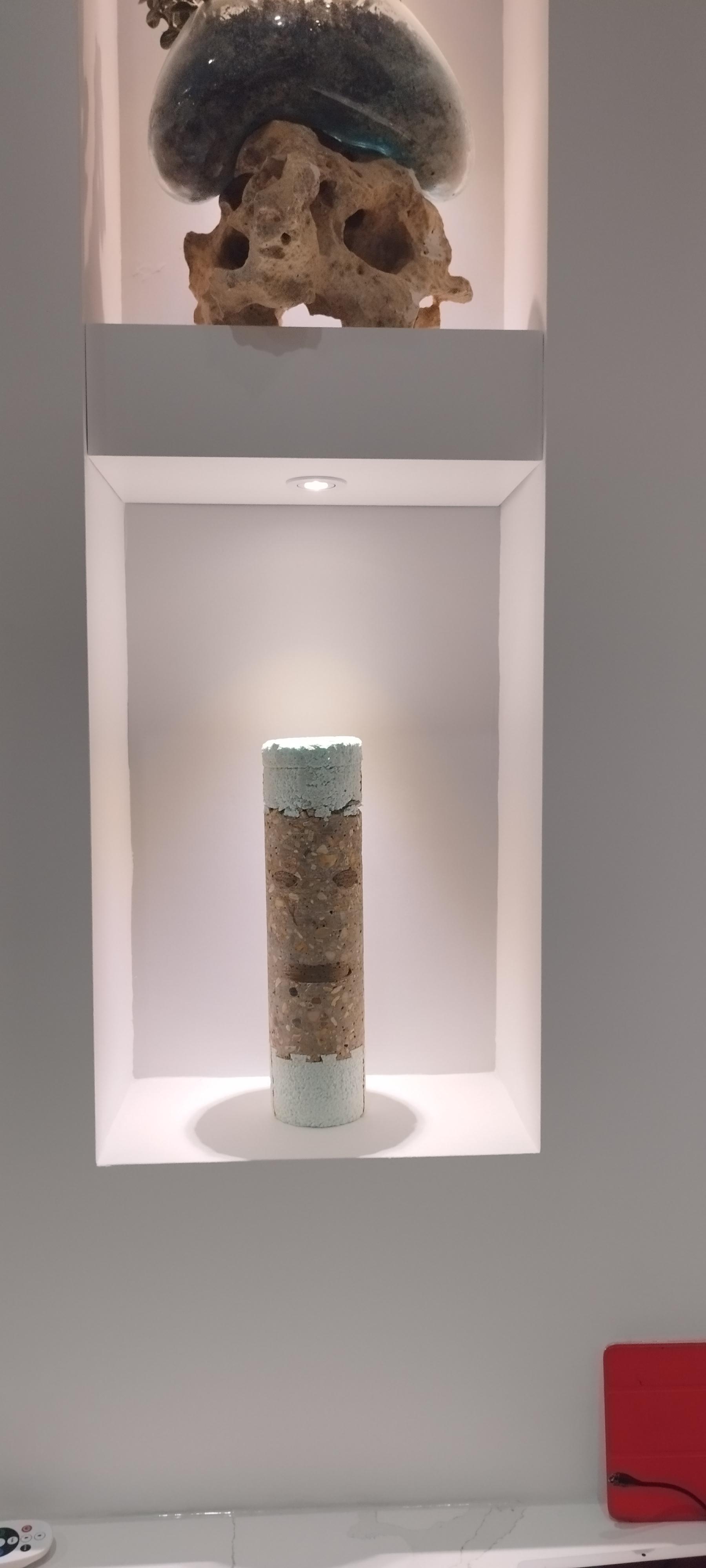

Also recommend paying someone. I had similar - all 200mm concrete with a lot of reinforcement a good guy can do quite a few holes in a half day. For mine he bolted the drill to the wall - maybe he could have used a stand for the drill but a few were quite high. A bonus is that the cores are super smooth and with a bit of varnish make a nice ornament. Will post up from my phone 🙂

I was wondering what to make of the 3 cores that I'll end up with 🙂
I used them as door stops in the office or placed on shelves to look suitably techy for the industry.
On 16/02/2024 at 19:56, Adam2 said:
Love that - looks superb like a geological sample
