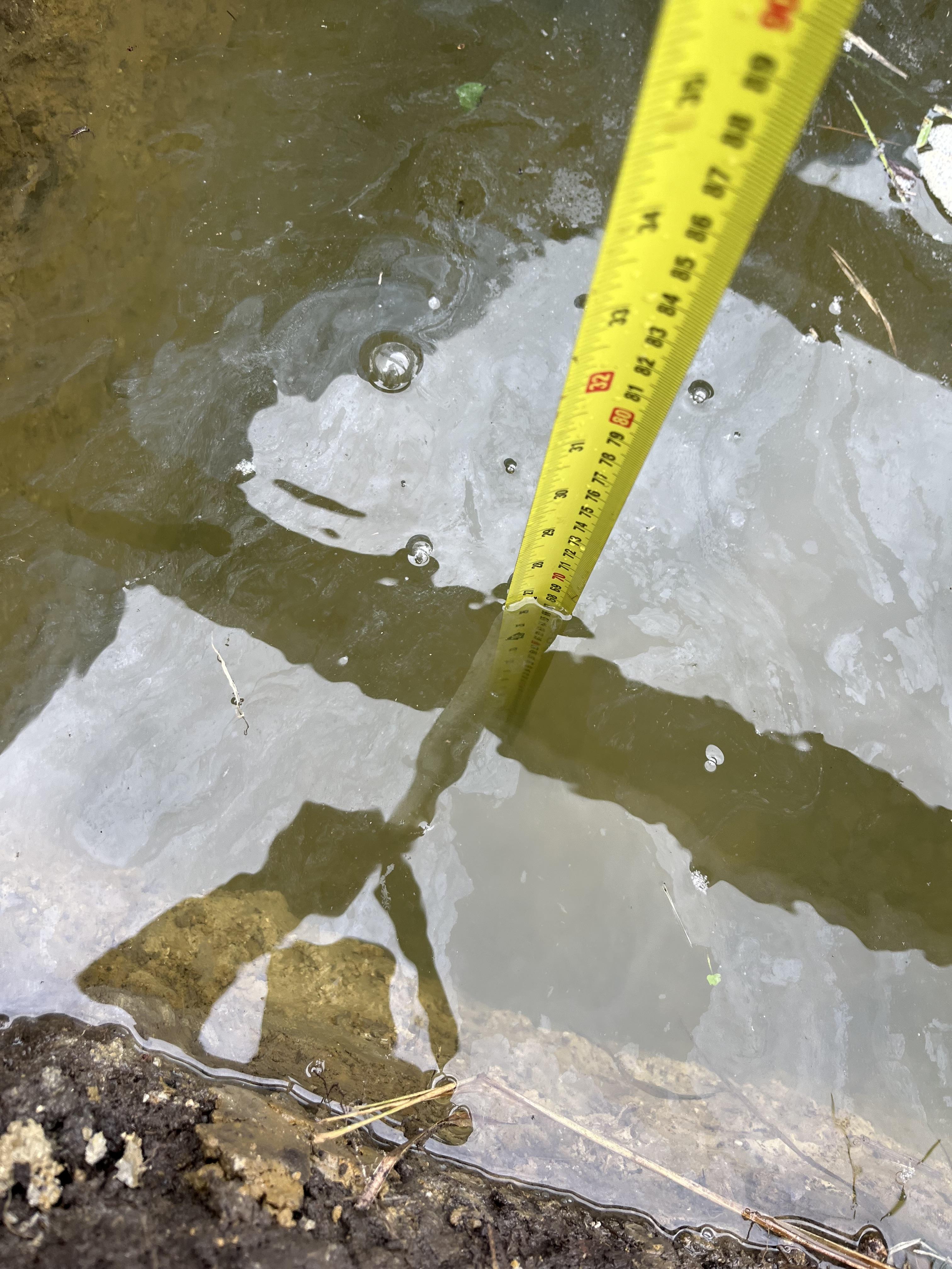

Alan Ambrose Posted March 21, 2024 Author Share Posted March 21, 2024 Just to report back: the ground turned out to be quite hard boulder clay and the window sampling rig, which turned up first, only got down to 2.5m. So, the cable percussion rig was a good call and we moved 2x GW monitoring to those holes instead. We also dug a percolation test pit by hand and the 300x300 hole in the bottom started slowing filling with water - and then kept on going. So, a sort of reverse perc test. A week later it was at 67cm in the main 1m deep hole! (It is protected from direct rainwater entry.) Our theory is it's using the slight sandy deposit to convey surface water. So, we'll need v good surface drainage for the winter and we're fairly close to proving that soakaways are out of the question. Link to comment Share on other sites More sharing options...
saveasteading Posted March 21, 2024 Share Posted March 21, 2024 51 minutes ago, Alan Ambrose said: close to proving that soakaways are out of the question. Don't assume that yet. What level did the groundwater rise to? 1 Link to comment Share on other sites More sharing options...
Alan Ambrose Posted March 21, 2024 Author Share Posted March 21, 2024 (edited) Well I hope it's from the surface or 'perched' rather than GW, but 67cm of the 1m cube depth in 6 days Edited March 21, 2024 by Alan Ambrose Link to comment Share on other sites More sharing options...
saveasteading Posted March 21, 2024 Share Posted March 21, 2024 1 hour ago, Alan Ambrose said: 67cm of the 1m cube Sorry, I see you had said already. 330mm below ground level Is very high but it took 6 days to fill. Great fun for foundations or even any site strip. I think do this again after a drier spell of weather. The water coming out of a digester is not in large quantities so maybe it can be made to work ( site specifics and pragmatic bco depending). But where will rainwater in modern vast volumes, go? Link to comment Share on other sites More sharing options...

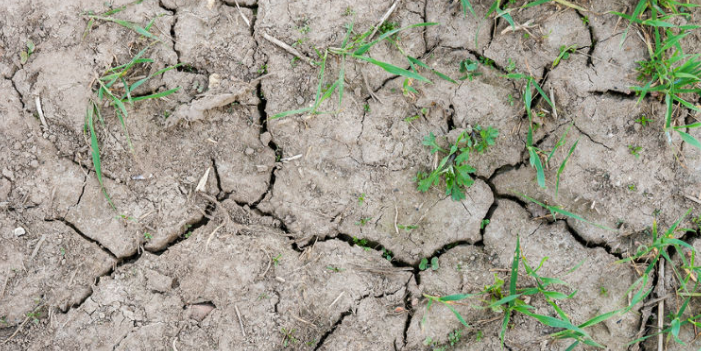

Alan Ambrose Posted March 21, 2024 Author Share Posted March 21, 2024 (edited) >>> But where will rainwater in modern vast volumes, go? There's a culvert / ditch at each end of the plot which we can use for drainage - so it's just a matter of convincing a BCO that we've tried hard to do SUDS I think. The clay does this in the summer, so I'm expecting that it'll be OK to dig, but quite hard. Edited March 21, 2024 by Alan Ambrose Link to comment Share on other sites More sharing options...
