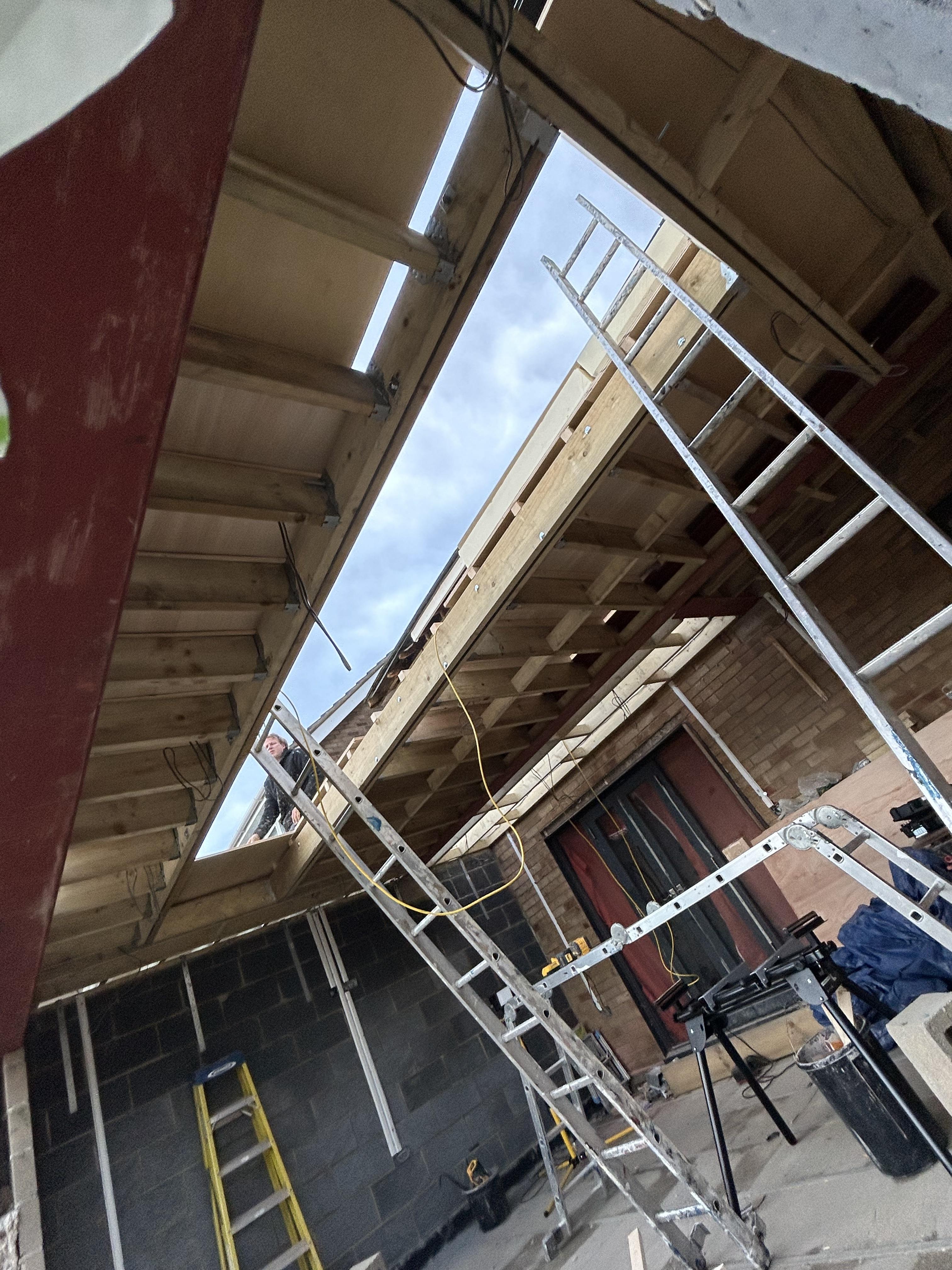

Oceanjules Posted February 8 Author Share Posted February 8 4 minutes ago, Moonshine said: hope it gets sorted, just a thought, do you have any photo from the inside of the room of the skylight area and the opening. Also the architectural plans, it it was really a 5.6m sky light it looks like the dimension of the room underneath is only just bigger than that! Yes. I do have pictures and videos from the inside. It seems like that surveyor measured wall to wall instead of measuring the upstand. Link to comment Share on other sites More sharing options...
Oceanjules Posted February 8 Author Share Posted February 8 Just now, Oceanjules said: Yes. I do have pictures and videos from the inside. It seems like that surveyor measured wall to wall instead of measuring the upstand. Link to comment Share on other sites More sharing options...

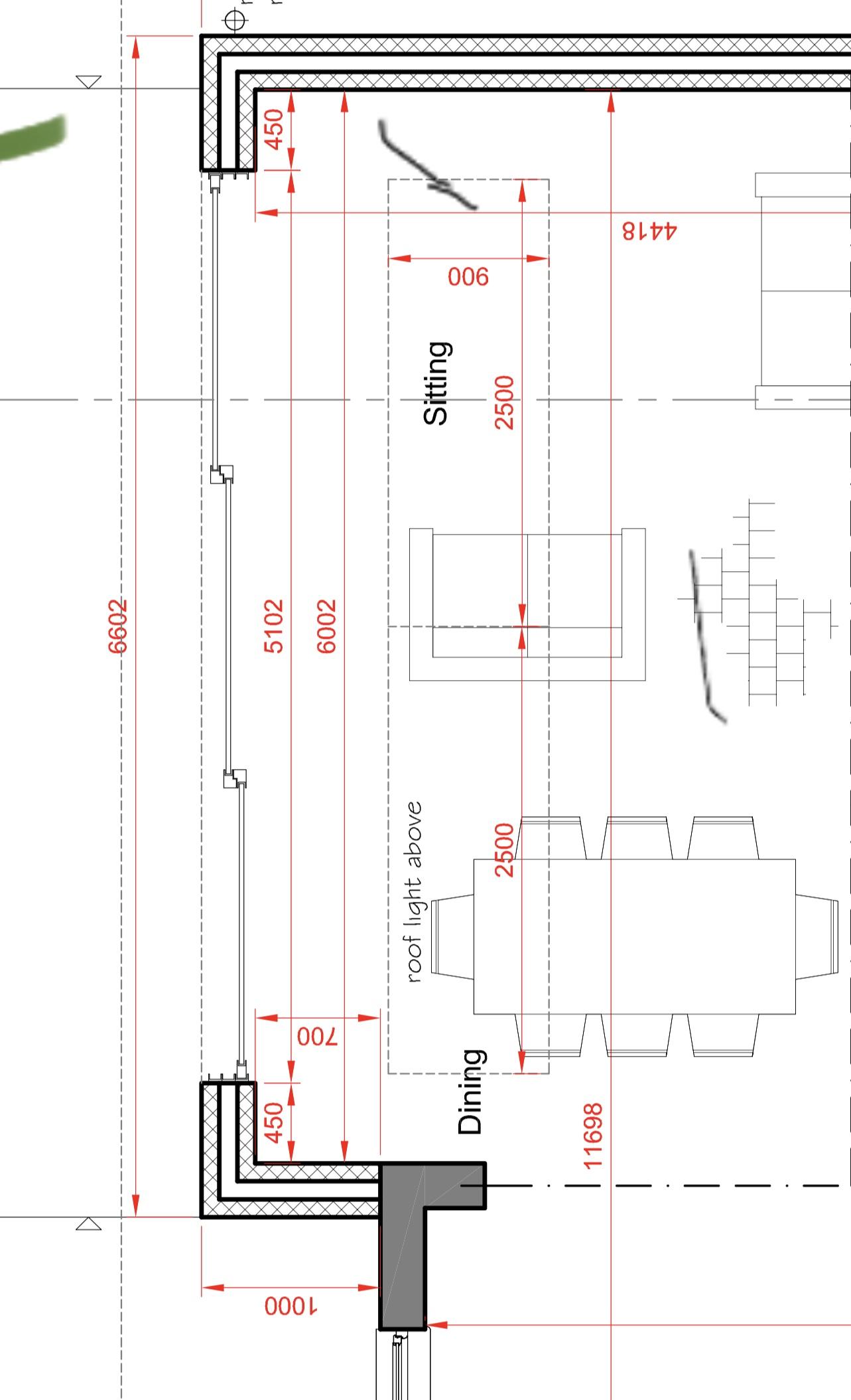

Moonshine Posted February 8 Share Posted February 8 2 minutes ago, Oceanjules said: Yes. I do have pictures and videos from the inside. It seems like that surveyor measured wall to wall instead of measuring the upstand. Hold on is the room width 5.6m? If it is that is a monumental f$%k on their part it's hilarious (sorry for your situation) Link to comment Share on other sites More sharing options...
Oceanjules Posted February 8 Author Share Posted February 8 4 minutes ago, Moonshine said: Hold on is the room width 5.6m? If it is that is a monumental f$%k on their part it's hilarious (sorry for your situation) I know right? I’m not entirely sure, will check later. For them to say 30 years of experience is the just full of arrogance. Everyone makes mistakes no matter how experienced the person is. It’s pouring down where I am and I had the temporary roofing removed because I timed it with the skylight installation. Link to comment Share on other sites More sharing options...

Moonshine Posted February 8 Share Posted February 8 35 minutes ago, Alan Ambrose said: @Moonshine - how did you do that measuring trick if you don't mind me asking? Printed the jpg as PDF, opened the PDF in 'PDF Xchange editor' which allows you to add dimensions, i changed the scale of the dimension too to match those on the drawings then added more dimensions using that 'custom' scale. 1 Link to comment Share on other sites More sharing options...

Moonshine Posted February 9 Share Posted February 9 21 hours ago, Oceanjules said: I know right? I’m not entirely sure, will check later. For them to say 30 years of experience is the just full of arrogance. Everyone makes mistakes no matter how experienced the person is. It’s pouring down where I am and I had the temporary roofing removed because I timed it with the skylight installation. What always the dimensions of the room below? At least it's only a small section that needs a temp roof, a 5m x .9m one Financially how do the delays affect you? Thier cock up can be costing you money... Link to comment Share on other sites More sharing options...
Oceanjules Posted February 9 Author Share Posted February 9 4 minutes ago, Moonshine said: What always the dimensions of the room below? At least it's only a small section that needs a temp roof, a 5m x .9m one Financially how do the delays affect you? Their cock up can be costing you money... Thankfully it’s only a small area. The builder had put something on top of it to make it a little bit waterproof. currently, it’s not costing us anything as we were meant to tackle the downstairs in 2 months time to give the owner a bit of time to gather some budget. It’s quite involved on the other side of the house (kitchen, bathroom, pantry, utility and knock through from the extension to the kitchen). it’s gonna cost us if they’ve decided they won’t pay a penny for the replacement. 😱 still haven’t heard from them. They are probably asking an advise from their solicitor measurement is attached Link to comment Share on other sites More sharing options...

Moonshine Posted February 9 Share Posted February 9 9 minutes ago, Oceanjules said: it’s gonna cost us if they’ve decided they won’t pay a penny for the replacement. 😱 still haven’t heard from them. They are probably asking an advise from their solicitor measurement is attached So a gap of the actual hole of 500mm either end, compared to a 200mm gap either end based on their measurements. Any photo's that you have from underneath that show the hole prior to the surveyors visit will show a large gap to the side walls which visually will be much more than 200mm, and there is a clear reference that the skylight lines up with the reveals of the sliding door. Link to comment Share on other sites More sharing options...
Oceanjules Posted February 9 Author Share Posted February 9 7 minutes ago, Moonshine said: So a gap of the actual hole of 500mm either end, compared to a 200mm gap either end based on their measurements. Any photo's that you have from underneath that show the hole prior to the surveyors visit will show a large gap to the side walls which visually will be much more than 200mm, and there is a clear reference that the skylight lines up with the reveals of the sliding door. This is the built up of the flat roof Link to comment Share on other sites More sharing options...

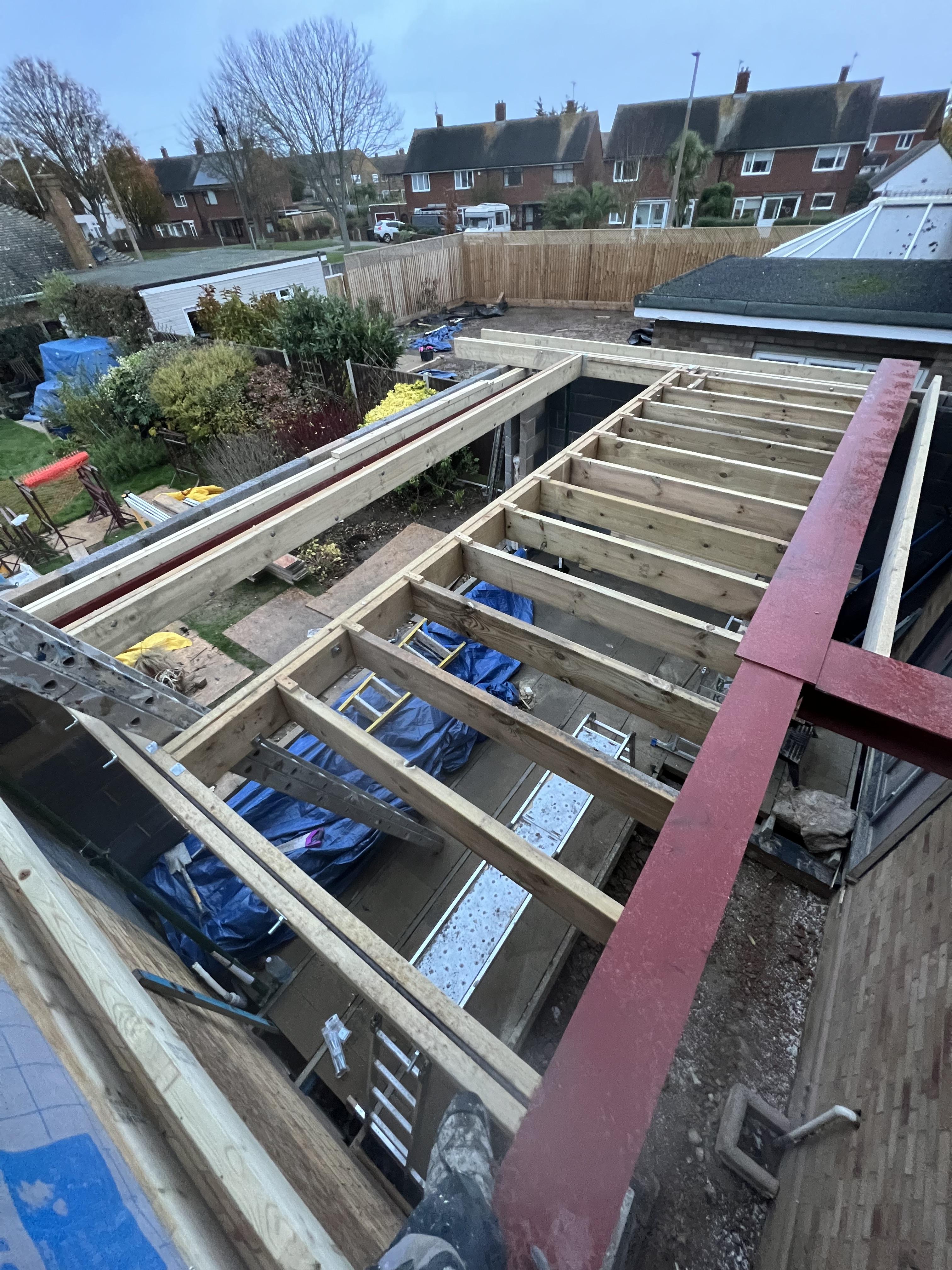

Oceanjules Posted February 9 Author Share Posted February 9 Just now, Oceanjules said: This is the built up of the flat roof Link to comment Share on other sites More sharing options...
Oceanjules Posted February 9 Author Share Posted February 9 Just now, Oceanjules said: Link to comment Share on other sites More sharing options...
Oceanjules Posted February 9 Author Share Posted February 9 13 minutes ago, Mr Punter said: This never ever happens. In the skip and replace with new. Rooflights are often toughened and / or laminated, so even if you wanted to endlessly faff around it would not be possible. That’s what I was told 😞 Link to comment Share on other sites More sharing options...
Moonshine Posted February 9 Share Posted February 9 10 minutes ago, Oceanjules said: This is the built up of the flat roof Quote You then updated the upstand to sort out the bow and to give the correct pitch, and was obviously made it smaller at the same time. Yeah, ain't no way you have made that roof light space bigger / smaller for shits and giggles from this point onwards, those doubled up joists ain't easy to mess with! The surveyor / supplier has got some explaining to do. On my project i have measured and ordered made to measure a large number of expensive things (insulated garage door, 4 flights of oak stairs, glass balustrades, external steel stairs), every time its very worrying until it actually arrives on site and fits (ish). I check, re check, have someone else check as i know people especially me make mistakes, and i made a fairly costly one early doors (two large lintels) which burnt me. However its me doing the measurements and its my fault if its wrong, to pay someone else to do the measurements (surveyor) its on them as you are paying extra to do the job and to take that risk away. I would still look at the wording of thing you signed to make sure that you don't have any liability there, but why would you want to double check or question a surveyor that is their job and has 30 years experience to your own? 1 Link to comment Share on other sites More sharing options...
Oceanjules Posted February 9 Author Share Posted February 9 3 minutes ago, Moonshine said: Yeah, ain't no way you have made that roof light space bigger / smaller for shits and giggles from this point onwards, those doubled up joists ain't easy to mess with! The surveyor / supplier has got some explaining to do. On my project i have measured and ordered made to measure a large number of expensive things (insulated garage door, 4 flights of oak stairs, glass balustrades, external steel stairs), every time its very worrying until it actually arrives on site and fits (ish). I check, re check, have someone else check as i know people especially me make mistakes, and i made a fairly costly one early doors (two large lintels) which burnt me. However its me doing the measurements and its my fault if its wrong, to pay someone else to do the measurements (surveyor) its on them as you are paying extra to do the job and to take that risk away. I would still look at the wording of thing you signed to make sure that you don't have any liability there, but why would you want to double check or question a surveyor that is their job and has 30 years experience to your own? Thank you. I have video footage as well but I haven’t got time to go through them as so much things are going on. Link to comment Share on other sites More sharing options...
