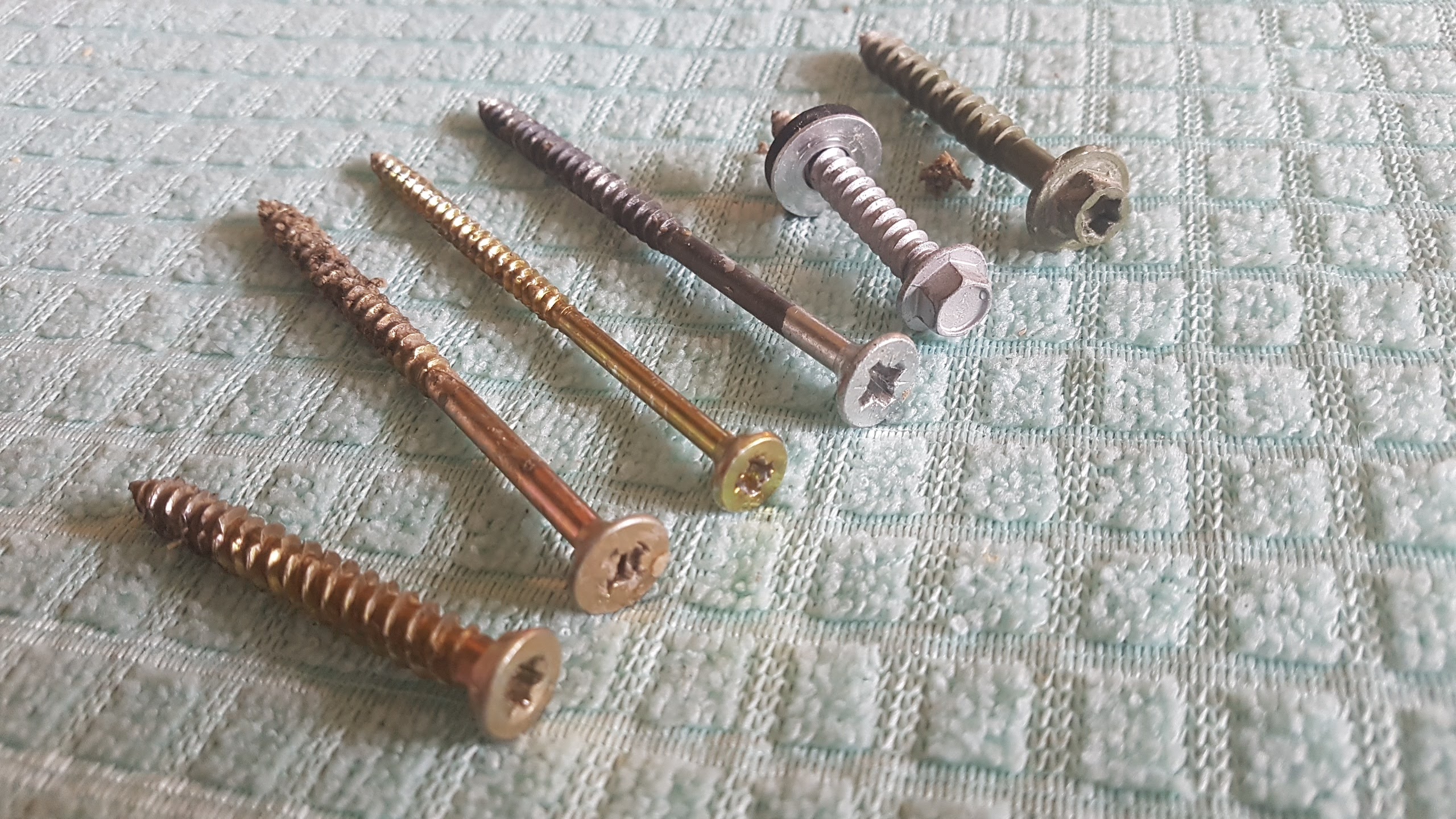

ToughButterCup Posted September 25, 2017 Share Posted September 25, 2017 Shuttering came down this weekend: well, most of it. The shuttering was screwed onto the wall by gorillas. Some joker had given them several boxes of screws with which to play: here's one of each type. And, being fun-loving gorillas, they managed to burr at least 50% of the heads sink the screw so deep into the shuttering the screw was invisible destroy the heads put the screws deep into the wood at an angle so that it was possible to see that there was a screw in the wood, but it was impossible to tell the type of screw hid the screw behind a thin scrim of concrete I bought a proper set of (Na! Bosch naturlich!) screw-driver bits. I armed myself with patience and good humour. I balanced happily on a proper scaffolding tower. And by tea time on Saturday I had been transformed into a furious, fulminating Dervish, happily ready to rip the arms off the nearest gorilla and beat it to death with the soggy ends. I am I alone in this sentiment? Link to comment Share on other sites More sharing options...
MikeSharp01 Posted September 25, 2017 Share Posted September 25, 2017 I guess they had no stake in getting them out so didn't worry about putting them in such that they could be extracted. That is quite a nice selection you have there though. Some are wood (L-R) 2,3,& 4, some for concrete 1 one for roofing material 5 and I cannot identify 6 but i must be a high torque application as it uses a torx head drive like the first. Plus, it looks like you have rested them on a very neat tea cloth ( dish / towel). Link to comment Share on other sites More sharing options...

ToughButterCup Posted September 25, 2017 Author Share Posted September 25, 2017 So folks, is there any way of removing screws which have (say) had the slot stripped or otherwise abused? I ended up trying to screw them in a tiny bit first. Some Torcx screws were in so deep and hard that I broke two driver bits. Please tell me it's not just me, tell me there is no simple answer.... Link to comment Share on other sites More sharing options...
MikeSharp01 Posted September 25, 2017 Share Posted September 25, 2017 No easy way I have ever come across. Do you have a multitool? If so you can probably cut the wood away from around the screw head and then grip the head with a pair of mole grips such as these. You can then twist them out. One thing to remember about these screws, well most of them, is that the are hard and can be snapped off - they don't like bending, by accident or perhaps for you, on purpose. Link to comment Share on other sites More sharing options...

Onoff Posted September 25, 2017 Share Posted September 25, 2017 You could try something like this: https://www.aldi.co.uk/damaged-screw-remover-set/p/094899148133700?gclid=EAIaIQobChMI-8ak47bA1gIVzbXtCh2MMAUMEAQYASABEgK7L_D_BwE You run the cordless ccw and it bites into the mullered head is the idea. Sometimes they just strip the head even more. You could...drill say a 50mm hole in a bit of scrap ply. Centre that over the problem screw and attach to the shuttering. Then use the Starrett sans the pilot to remove the section of shuttering the screws in. The scrap bit keeps the cutter on centre. Then get some moles on the screw. Even if it shears off at least it'd let you remove the sheets save for little rounds here and there which you could take off later. Link to comment Share on other sites More sharing options...

Ferdinand Posted September 25, 2017 Share Posted September 25, 2017 29 minutes ago, Onoff said: You could try something like this: https://www.aldi.co.uk/damaged-screw-remover-set/p/094899148133700?gclid=EAIaIQobChMI-8ak47bA1gIVzbXtCh2MMAUMEAQYASABEgK7L_D_BwE You run the cordless ccw and it bites into the mullered head is the idea. Sometimes they just strip the head even more. You could...drill say a 50mm hole in a bit of scrap ply. Centre that over the problem screw and attach to the shuttering. Then use the Starrett sans the pilot to remove the section of shuttering the screws in. The scrap bit keeps the cutter on centre. Then get some moles on the screw. Even if it shears off at least it'd let you remove the sheets save for little rounds here and there which you could take off later. That's Aldi. @Onoff wants his welder and a profit. Link to comment Share on other sites More sharing options...

Lesgrandepotato Posted September 25, 2017 Share Posted September 25, 2017 Stick a jemmy down the back and rip it down? Would the lads that put it up have take them out? I suspect not.... Link to comment Share on other sites More sharing options...
ToughButterCup Posted September 25, 2017 Author Share Posted September 25, 2017 That's what we did in the end: never mind a jemmy ..... two 'king great big crow bars .... 1 Link to comment Share on other sites More sharing options...
