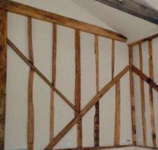

Alan Ambrose Posted January 23, 2024 Author Posted January 23, 2024 >>> Have you any idea of the original paint name / manufacturer.# No, the backstory is that it was a new barn conversion we bought 5 years ago and I need some touch-up paint. I guess that's a harder job than just 'get me somewhat close to this F&B colour'. I'm a bit closer with matching the Valspar swatches by eye and their sample pots - actually I have a much better match than the custom-spectro-matching-mix thing. That suggests their matching service is a bit of a waste of time - at least from that B&Q with that operator. I couldn't understand why they didn't have a second matching step to take their first guess and improve it - but they were properly stroppy by that time. I'll try Johnstones and Tikkurila and see if they're better and report back. Someone has done a very skilled job plastering and painting between all the old oak sticks so it's not an easy job to just re-paint a single 'wall' - it would need loads of masking. This kind of thing:
