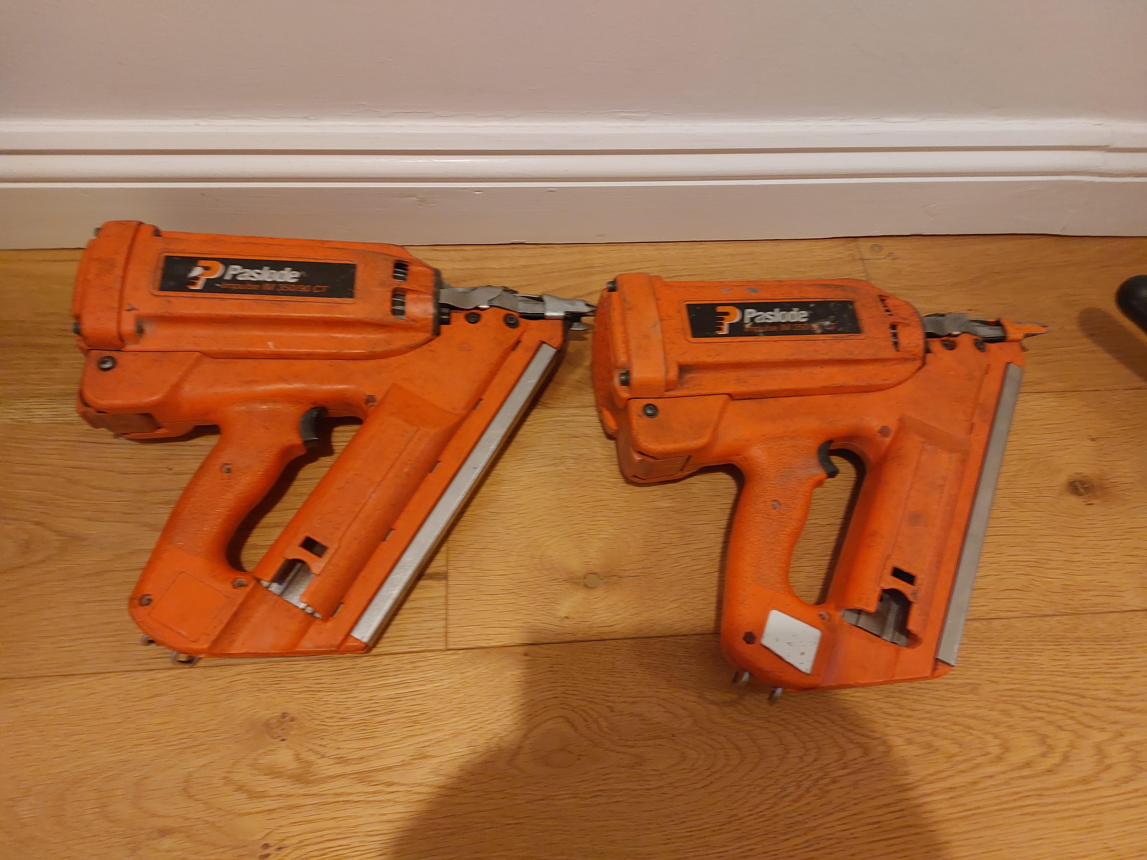

saveasteading Posted January 10, 2024 Share Posted January 10, 2024 Ive bought an old paslode nail gun, well 2 actually. 350/90 model. I saw them both tested, and fired a few nails myself. But I feel that a few tweaks of the nails and gas cylinder were needed by the vendor and maybe I have to learn the same. Can anyone point me to an instruction manual or a good youtube demo? I've got to buy batteries and charger but that looks straightforward. Nails, the guy said to get slanted, partial headed ones. Nail and gas prices seem to vary a lot. Can't see the reason for that except maybe SF and TS charge what they can. Either it's a bargain at £70 each or I've bought somebody else's problems. Do feel free to say. Link to comment Share on other sites More sharing options...

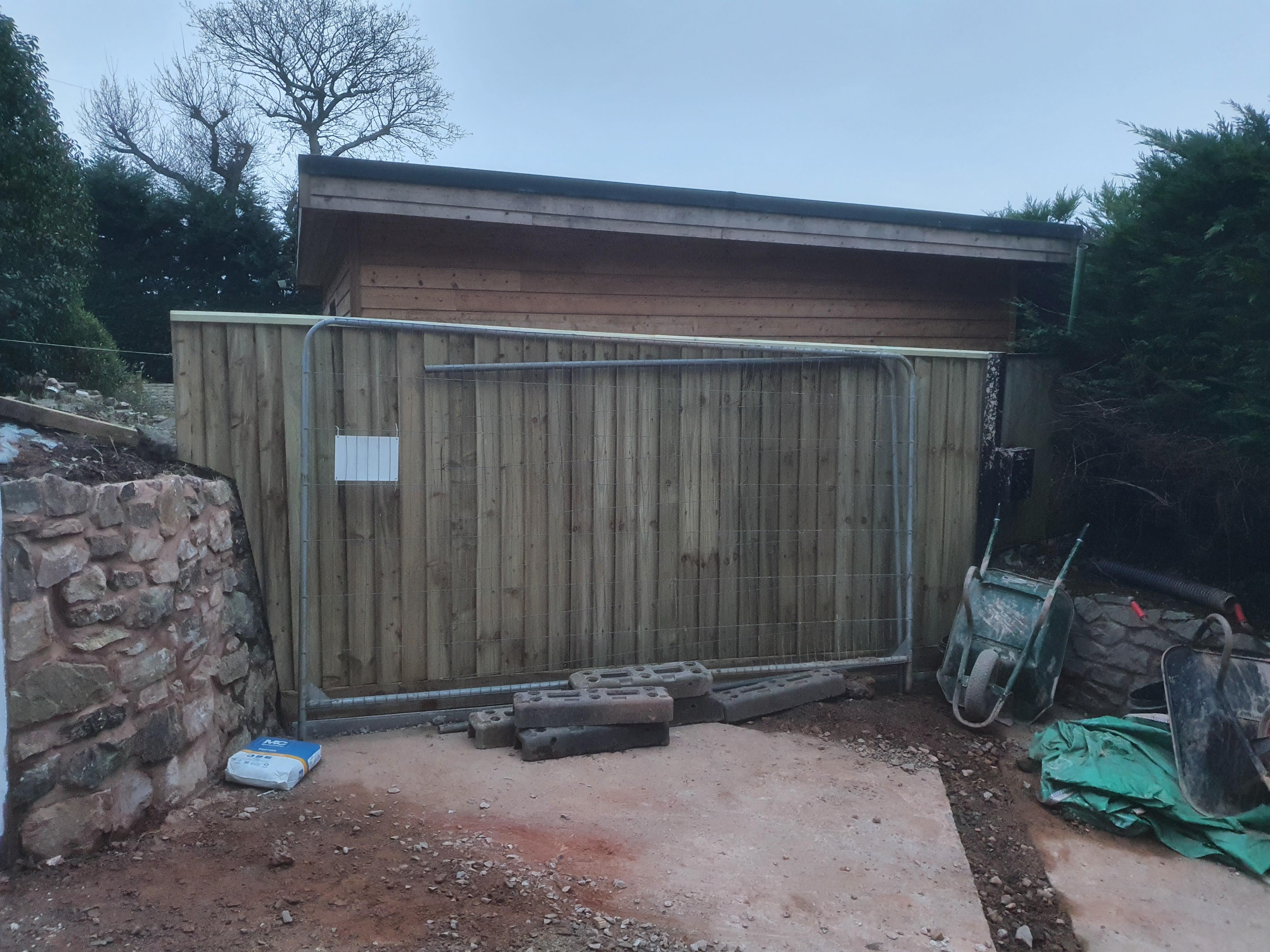

Moonshine Posted January 15, 2024 Share Posted January 15, 2024 (edited) I did a bit of close boarded fencing on the weekend (first time I have ever done fencing). Paslode was invaluable. Though with my the depth gauge kept slipping which was annoying and something I need to sort out. Probably saved myself £250 labour doing it myself, and it took about 6 hrs inc digging the holes and setting the posts Edited January 15, 2024 by Moonshine 1 Link to comment Share on other sites More sharing options...
Mr Punter Posted January 15, 2024 Share Posted January 15, 2024 Looks a very neat job. It takes a bit more work to do the capping, cut the pales to the slope and shape the end few around the wall but it looks good. 1 Link to comment Share on other sites More sharing options...

Moonshine Posted January 15, 2024 Share Posted January 15, 2024 25 minutes ago, Mr Punter said: Looks a very neat job. It takes a bit more work to do the capping, cut the pales to the slope and shape the end few around the wall but it looks good. capping was very easy as it was rebated so it just sits on top 20 minutes ago, saveasteading said: I don't know what this is. Does the nail disappear into the wood if this is set wrongly? I've just been looking at the vast choice of nails. Something else to get an understanding of. I can't see why there is a choice of 2.8mm or 3.2mm. Is that significant? its just the setting that determines how far the nail is driven into the wood, and set by the tip of the gun which is held in space by to serrated plates which are tighten together by an allen bolt on the top of the gun. On mine the serrations on the plates are worn so don't hold in place very well. the thickness of nail is dependant on its length, 2.8mm for about 50mm nails and 3.2mm for longer nails, e.g. 90mm 1 Link to comment Share on other sites More sharing options...

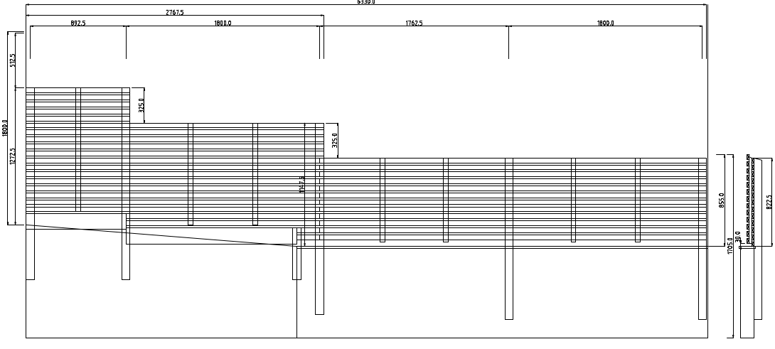

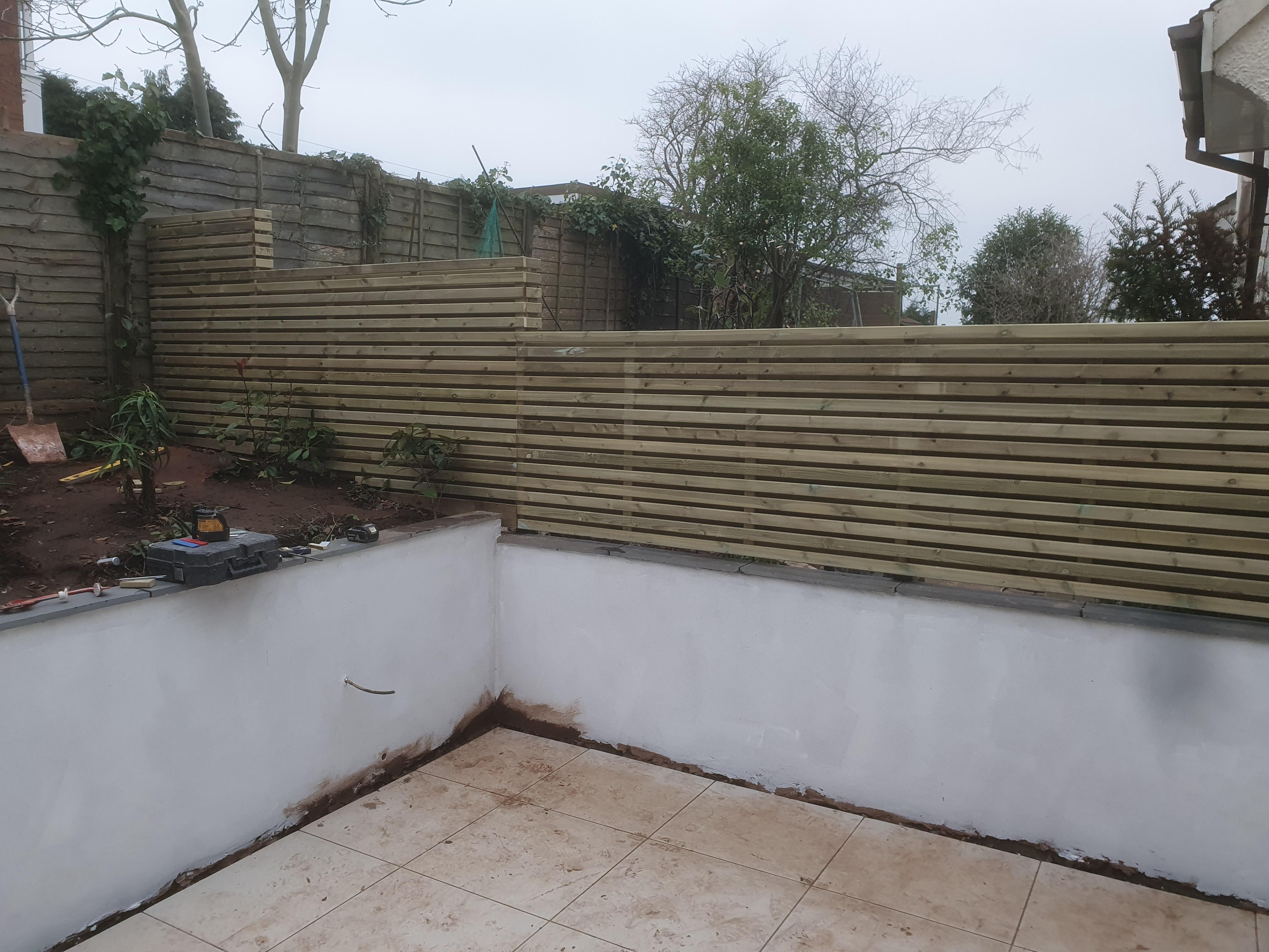

Moonshine Posted January 15, 2024 Share Posted January 15, 2024 (edited) I did this on Saturday, with my second fix nailer, took ages with double slats i cheated a bit and needed to get sign off from the end client (wife) so put it into CAD to get my head around it and work out how much materials i needed Edited January 15, 2024 by Moonshine 1 Link to comment Share on other sites More sharing options...

Mr Punter Posted January 15, 2024 Share Posted January 15, 2024 46 minutes ago, Moonshine said: I did this on Saturday, with my second fix nailer, took ages with double slats Where were the slats from? They look like 2 x 1 treated with rounded corners. I am looking for something like this. Link to comment Share on other sites More sharing options...
