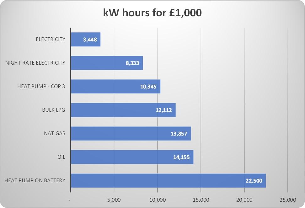

Originaltwist Posted January 7, 2024 Share Posted January 7, 2024 Batteries getting cheaper and no VAT 15kWh for £2,500 from Fogstar next month and no VAT Time shifted night rates running heat pump (with the COP uplift) make for an interesting comparison to the normal heating methods. I've tweaked a recent chart of the latest rates to show how good it could be. Of particular note is that the battery tweak elevates an existing heat pump from the worst spot on the chart to the best with a doubling of the output. Batteries used to reach the end of life before payback was reached but now ....? Link to comment Share on other sites More sharing options...

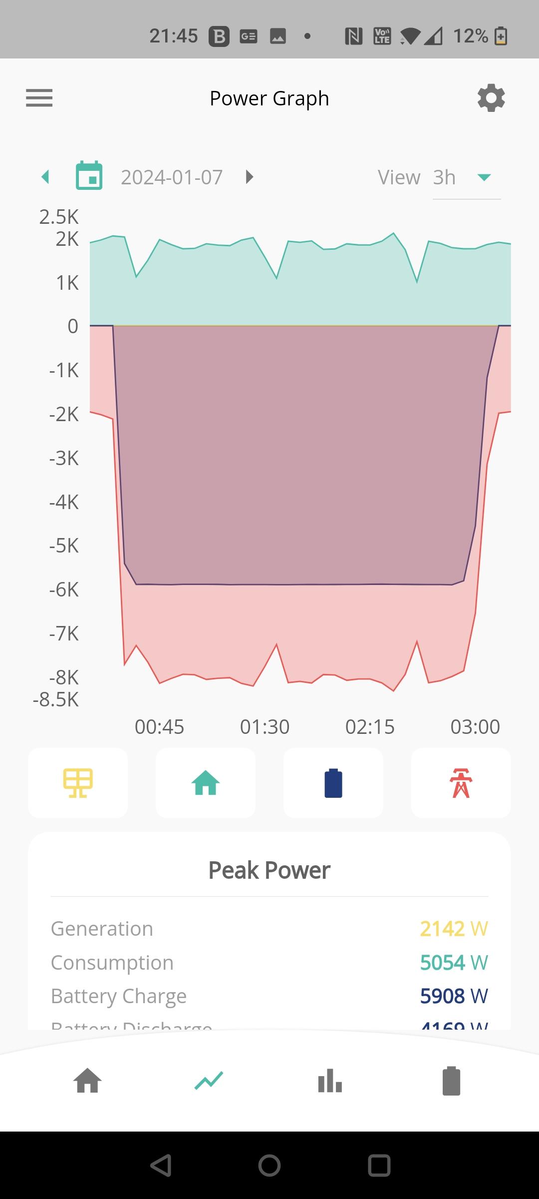

JohnMo Posted January 7, 2024 Share Posted January 7, 2024 GivEnergy AIO charging last night - dark red area, charging 6kW. 1 Link to comment Share on other sites More sharing options...

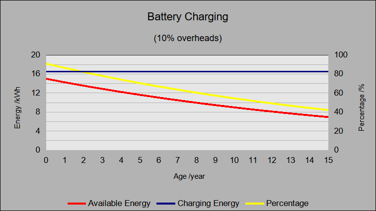

SteamyTea Posted January 8, 2024 Share Posted January 8, 2024 As batteries age, it is accepted they hold less charge. If one assumes a 10% charging overhead for thermal losses (this may vary over times and is just a starting point), then a 15 kWh system will need 16.5 kWh to be fully charged (this is depth of discharge agnostic for this purpose), that is an initial efficiency of 91%. If one then assumes that the battery capacity reduces by 5% each year, the efficiency then drops to 86% after a year, then 82% by end of year 3. After ten years it is 54%. I am not actually sure if a degraded battery still takes the same amount of energy to charge up to deliver lower amount of energy, and lightly discharged batteries may well fair better than heavily discharged ones. I think this is called Coulombic Efficiency (CE). Even if the charging energy levels are reduced over time, I very much suspect that the overall CE drops. Even if it is half of what I have modeled (very basic model with assumptions), that still means after a decade near enough 30% of the capacity has gone. This will also affect the power delivery i.e. initially say it can deliver 5 kW, after a decade it may be only to deliver 3.5 kW. It would be nice if someone that has batteries can monitor the overall energy in and the overall energy out to see how good they are, it is too easy to fudge the numbers to make them fit an argument. A chart. Link to comment Share on other sites More sharing options...

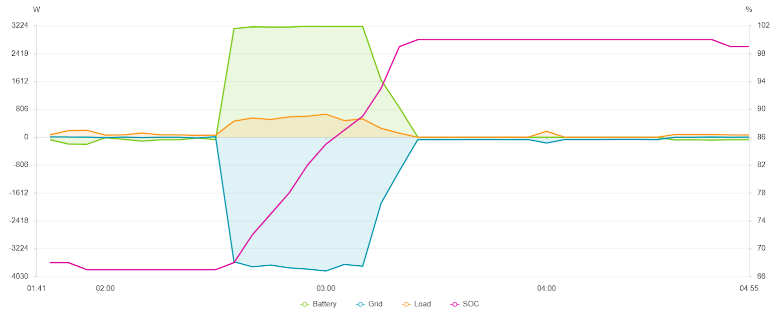

MikeGrahamT21 Posted January 8, 2024 Share Posted January 8, 2024 10 hours ago, JohnMo said: GivEnergy AIO charging last night - dark red area, charging 6kW. This seems to show an inefficiency, much in the same way mine does, unless you are actually consuming power at that time? This is what mine shows during charge, with an evident "load" during the charge, this isn't a load, its just in fact the inefficiency. I'm in talks with Solis regarding this at the moment, as to me it seems to be too much, and they advised me to speak to Pylontech, i'm waiting for their response Link to comment Share on other sites More sharing options...
JohnMo Posted January 8, 2024 Share Posted January 8, 2024 (edited) The colours are Green, power going to the house, running MVHR, heat pump etc. this is also represented as import electricity in the light red/pink section below the dark red. The way mine works, during off peak, it charges battery and any consumers take electric direct from grid, not the battery. At the end of the off peak period the battery is at 100% charged, then house consumption comes from battery, until departed to 5%, then grid power is taken by the house. Edited January 8, 2024 by JohnMo Link to comment Share on other sites More sharing options...
