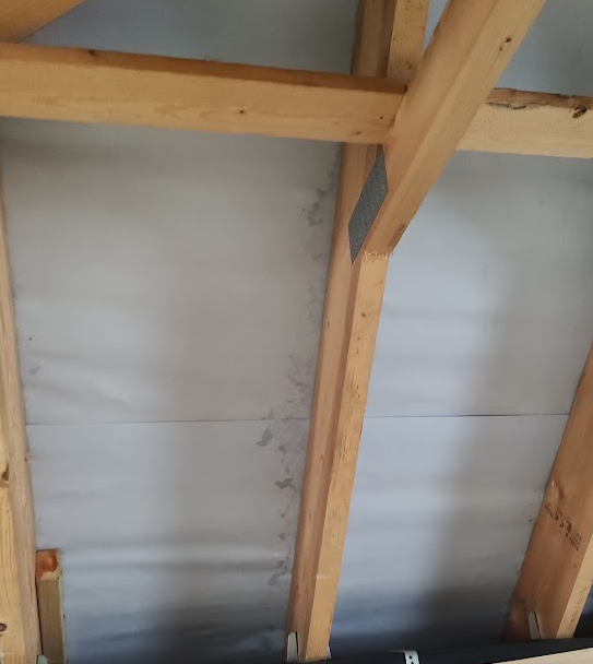

Hi everyone,
We have recently had GSE in roof solar panels and trays fitted to our new build roof which is now complete and slated. Since then we have been getting wet patches/streaks on the membrane visible from below. My roofer has been round and said he's 90% sure it's condensation, which I'm not convinced by. The patches only form when it's raining which seems to be the big give away for me that it's water ingress and not condensation, but saying that, I'm no roofer. Any thoughts/advice would be much appreciated.

OK bit more progress on this. I'm even more dumbfounded.
So I had a hose constantly on different parts of the roof flat out at hour intervals this week and nothing shown up on the inside. No patches, no streaks, nothing.
I took a panel off (in the rain) to expose the GSE tray underneath and there was no running water on the tray, the top flashing and panel was taking the majority of the water away, but what I did notice was the tray had what looked like condensation on it, wiped it with my hand and was soaking. So is that what is showing up on the membrane??
Another test I did was put a piece of DPM across the opening in the tray to see which side of the DPM was getting wet. Went down this morning after rain, wet patches visible on the inside again, pulled the DPM out and found that the external side was dry and the internal side was wet with condensation??
So seems like possibly condensation but I still don't understand the science on it 🤷🏼‍♂️
For a bit more info the patches are still only showing when it's wet weather. Not particularly rain, it's been misty damp today and the patches are visible inside 🤷🏼‍♂️

Still battling with this. It's definitely not leaking. I've had a multiple water hoses running full whack on the roof at 1m intervals and the patches didn't appear, bone dry.
I did however get a borescope through the membrane to where the patches were showing and noticed drips coming from the back of the GSE tray and onto the membrane, which seems like a condensation issue. This is a new build, ventilation at eaves and ridge, breathable membrane but no insulation has been installed yet to monitor the issue.
I have since insulated between 5 of the rafters as a test to see if the patches disappeared, but they came back next time we had damp weather. Again, patches only show, at a continuous height all the way across the panels and in wet weather, I'm out of ideas.

This looks like condensation to me, so you must have dew point conditions around the in-roof GSE plastic formers - the fact that it is wet both sides supports this theory. So warmer damp air hits a cooler surface and condensation forms as the air goes through its dew point. Calculating dew point in the traditional way is a bit of a pain but in 2005 Mark Lawrence came up with a much simple calculation which gives a good approximation, above 50% Relative Humidity (RH) and not far out below.  Td = T - ((100 - RH)/5.) you can read all about it here: https://climate.envsci.rutgers.edu/pdf/LawrenceRHdewpointBAMS.pdf.
So you can then play with the numbers and get an impression for just when the condensation will happen. I created a simple spreadsheet to help me understand why I was getting vast quantities of condensation on the air tight membrane before the insulation was pumped in. So if the RH is 80% and your air temperature is 9oC and if your plastic unit is at 5oC you will get condensation by this calculation (and the full one). Your situation is all on the outside but it still means that at for every 5% RH drop from 100% the temperature delta increases by 1o C (at 100% the dewpoint is the temperature if you think about it!).

My guess would be cold air passing on the outside of the roofing felt with warmer moist air in the roof space condensing...

So that would explain why condensation only occurs when it's wet weather, rain/damp/mist/drizzle. I insulated one side of the roof and left the panel side uninsulated so I can see what's going on. This might be compounding the issue possibly. I have tried insulating between 5 rafters just to test but the patches still appeared behind, maybe I need to crack on and insulate the whole roof for a proper test? What do you think?

Hi mate, no never, it was -5 degrees here the other week and I had no patches whatsoever, bone dry. This is what's dumbfounding me, I'm no physics expert, but I would have thought condensation would be affected by temperature and not weather? So unless it's purely the relative humidity outside that's increasing in the wet weather like Mike said is resulting in the ideal conditions for condensation to come closer and show up I don't know?

Yeah that's my thinking also, although like I said I have insulated 5 rafters and it made no difference behind these. So I may have unless to do the whole roof to fully test the theory.
I have had the sand/cement screed poured in January but this was happening before and after that?

Not GSE, just metal rails.  The solar guys attended to inspect and were due to get on the roof to resolve this.  I don't know how they got on.  Scaffold is down, so I will not be going up there.  This only shows on the section of roof with solar.
Is the top metal rail perchance by that nail-plate? In which case could the moisture be where the rail bkt has (*if it has*) perforated the membrane? Of course whatever flashing detail was used should prevent this but it looks like you have a point of entry and then it's running down (or not; I may be wrong!).
It's in one line down the slope, so I'd say it is one screw at fault, at or above the start of the wet area.
FYI the last pic is not of my issue but someone with similar problem.
