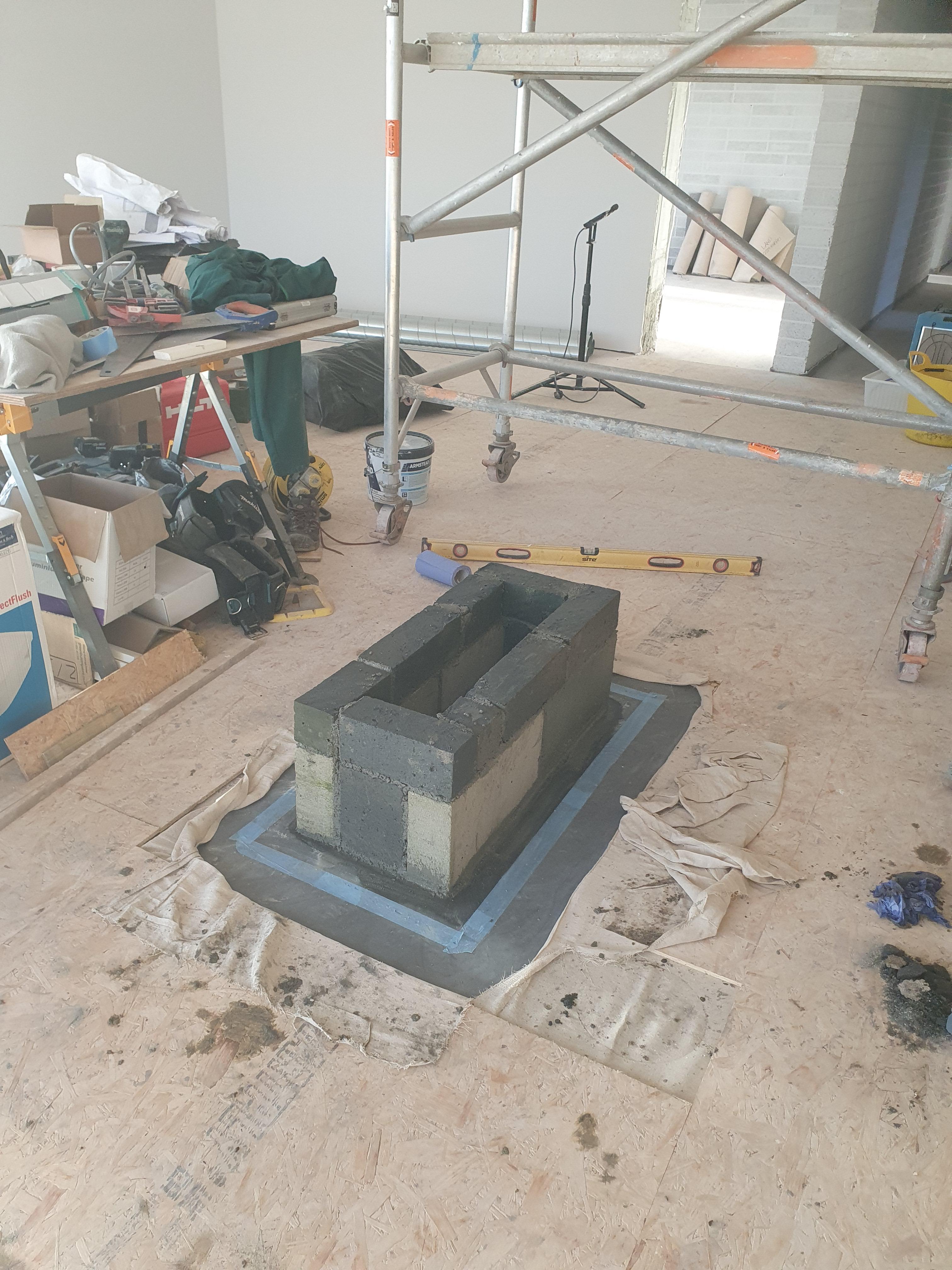

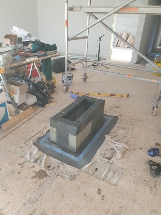

Tom Posted January 13, 2024 Author Posted January 13, 2024 Here's what I did in the end. Lightweight block "core"

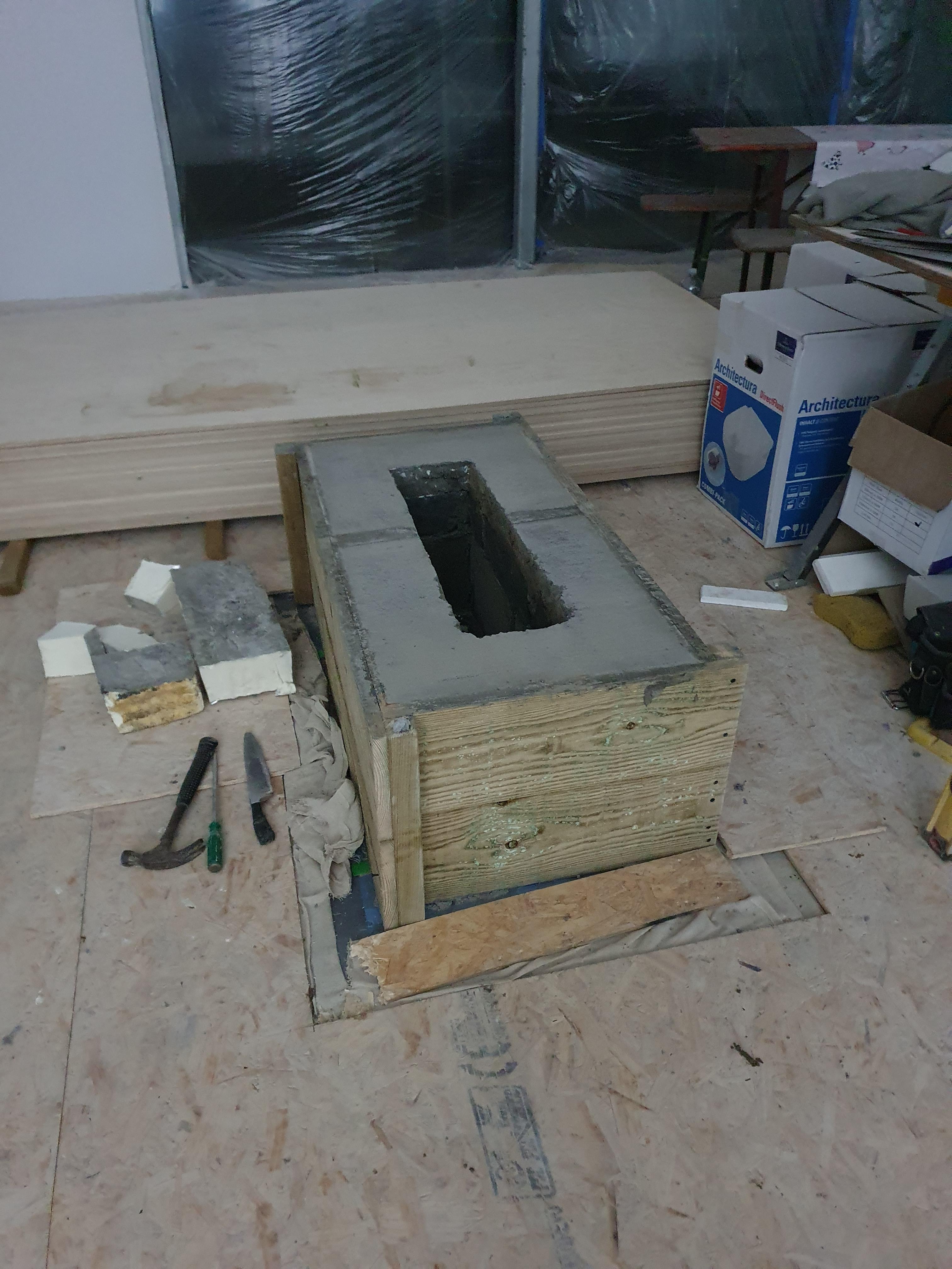

Tom Posted January 13, 2024 Author Posted January 13, 2024 Wood former around the outside and fill with concrete between this and the blocks

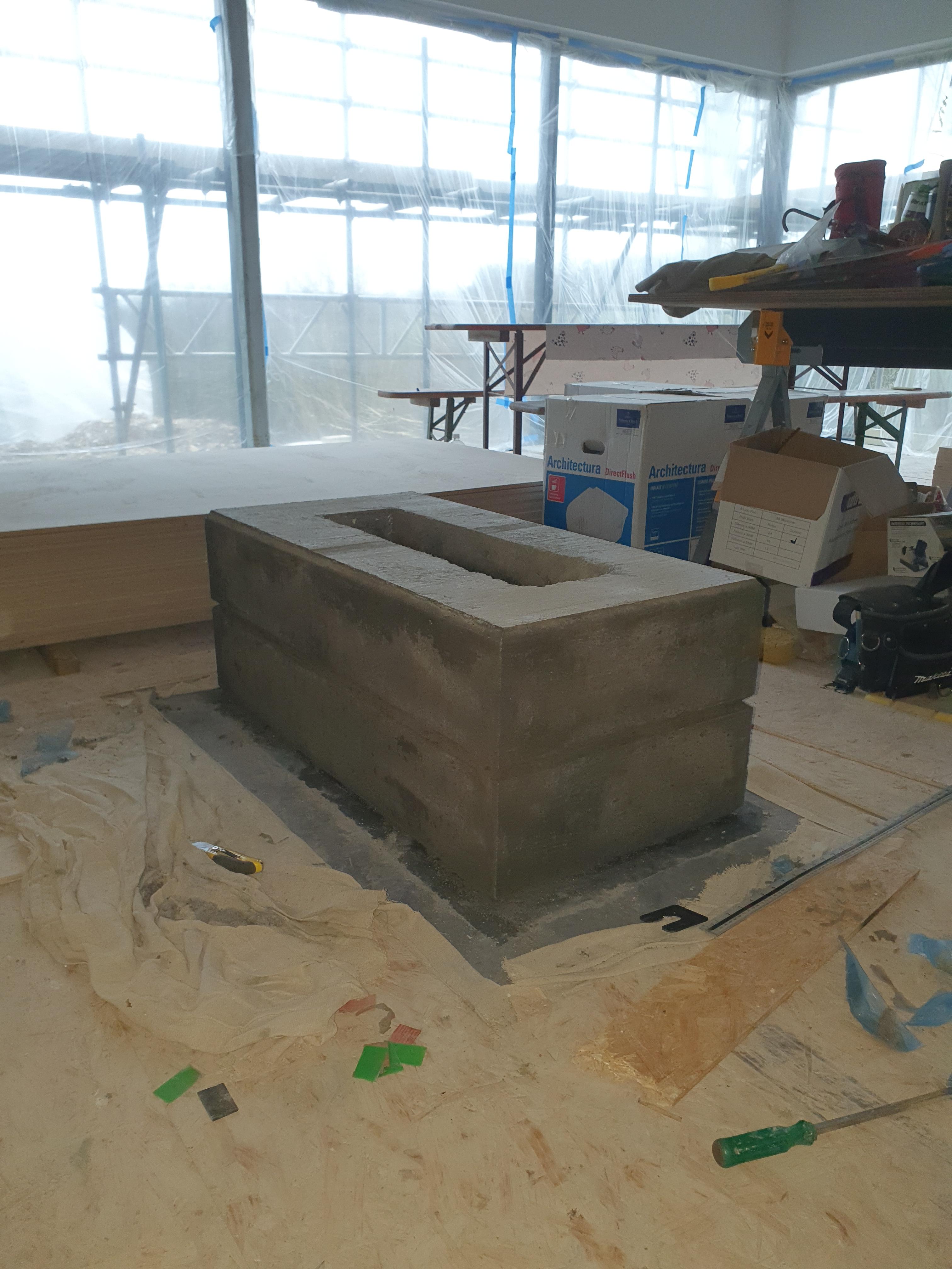

Crofter Posted January 13, 2024 Posted January 13, 2024 Looking good! What's going on the sides and the top?
ProDave Posted January 13, 2024 Posted January 13, 2024 When you said you wanted it "raised up a bit" I expected an inch or two. What is going on the floor? I am not sure that stand is big enough to meed the space the "hearth" needs to be around the stove?
Ferdinand Posted January 13, 2024 Posted January 13, 2024 If you need more space around it, one possibly acceptable way may be to have a set of modern hearth rails at a suitable height. In concept think of the altar rails in churches, but made out of eg wrought iron or something shiny. Or a traditional fender if that is permissible. I think the only difference I might have done with the cast concrete would have been to use shiny sheet for the mould to make it very smooth - but that might have shown imperfections.
Tom Posted January 13, 2024 Author Posted January 13, 2024 3 hours ago, Crofter said: Looking good! What's going on the sides and the top? The stove on the top and nowt on the sides! 3 hours ago, ProDave said: What is going on the floor? I am not sure that stand is big enough to meed the space the "hearth" needs to be around the stove? The floor is concrete. BR needs 225mm in front and 150mm to the sides IIRC which obviously must not be flammable (which the floor wont be!) but also serves as a demarcation so furniture etc cant get too close - so we might just put down some tiles to satisfy them for sign off and then remove after. 3 hours ago, Ferdinand said: I think the only difference I might have done with the cast concrete would have been to use shiny sheet for the mould to make it very smooth - but that might have shown imperfections. Exactly this. Looks good when smoothe but has to be 100%. Our floor is going to be polished, so I think the contrast with the rough concrete monolith will look good.

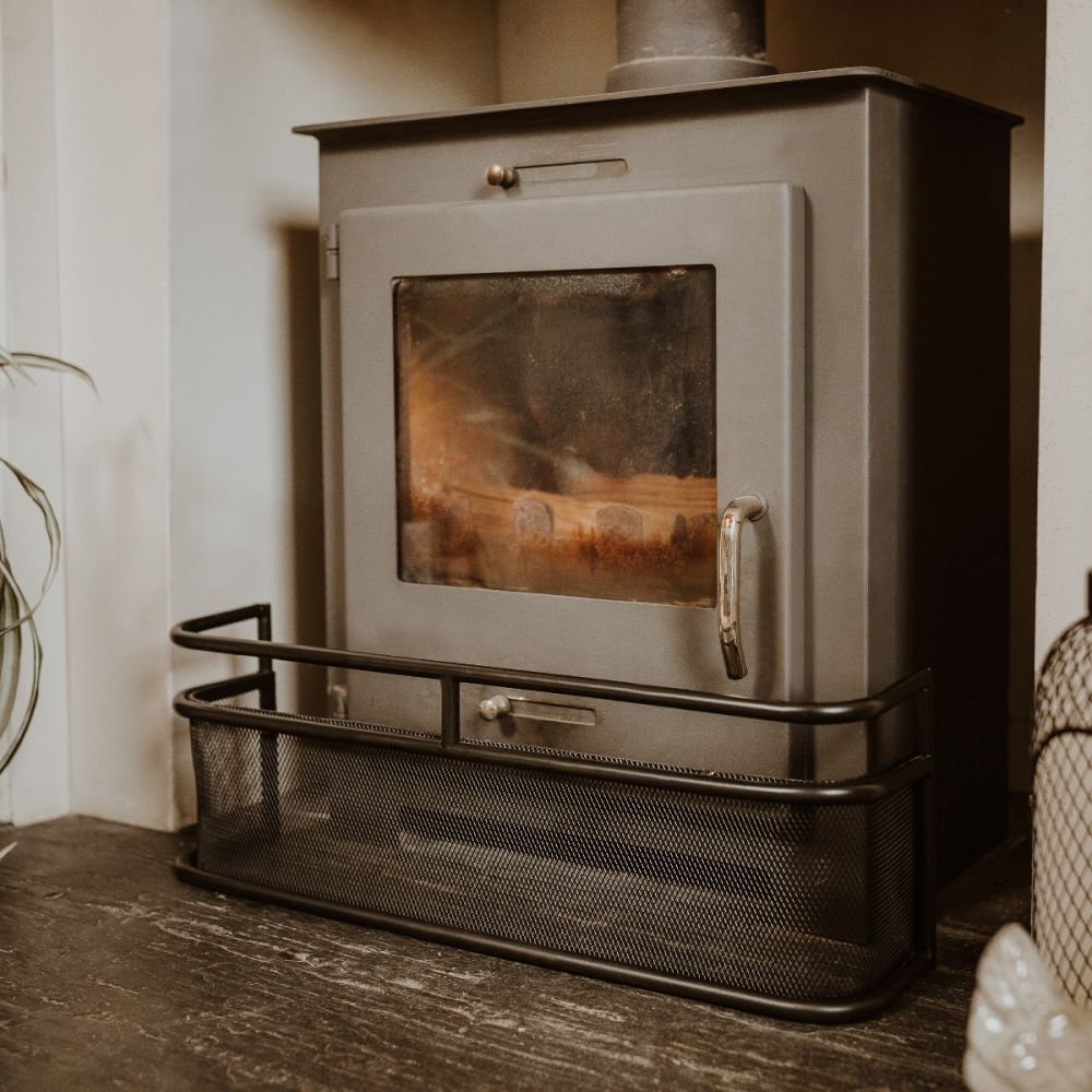

saveasteading Posted January 13, 2024 Posted January 13, 2024 Regardless of the rules, I like a hearth with edging to catch embers when loading, and retain ash.

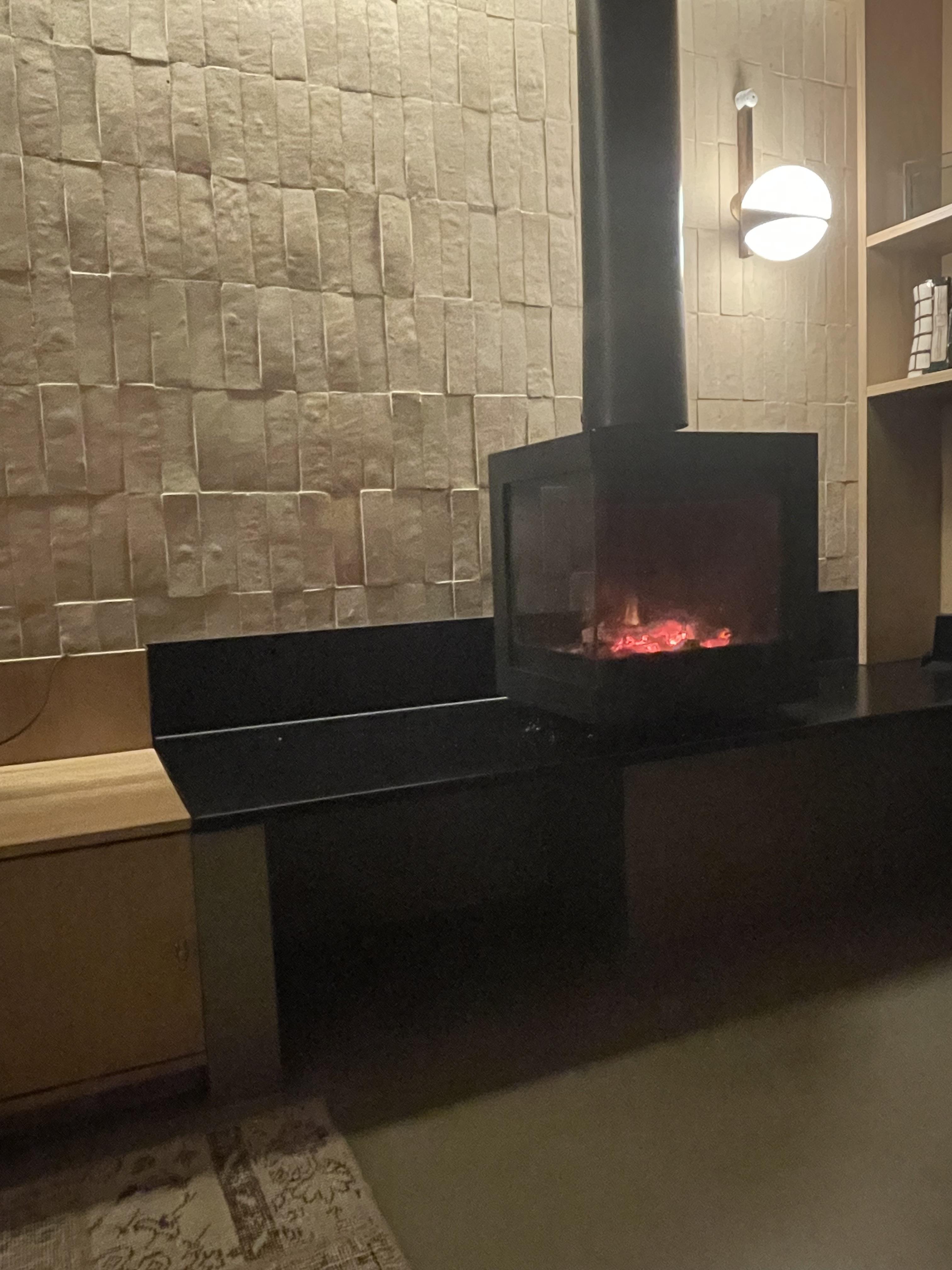

Adsibob Posted January 18, 2024 Posted January 18, 2024 On 13/01/2024 at 12:27, ProDave said: What is going on the floor? I am not sure that stand is big enough to meed the space the "hearth" needs to be around the stove? Looks fine to me. Very similar to what we did: ours is also sitting on a cast concrete plinth, save that we have a steel tabletop between the stove and the plinth. You can’t really see the plinth in this photo as it’s the same colour and finish as the floor: microcement.
