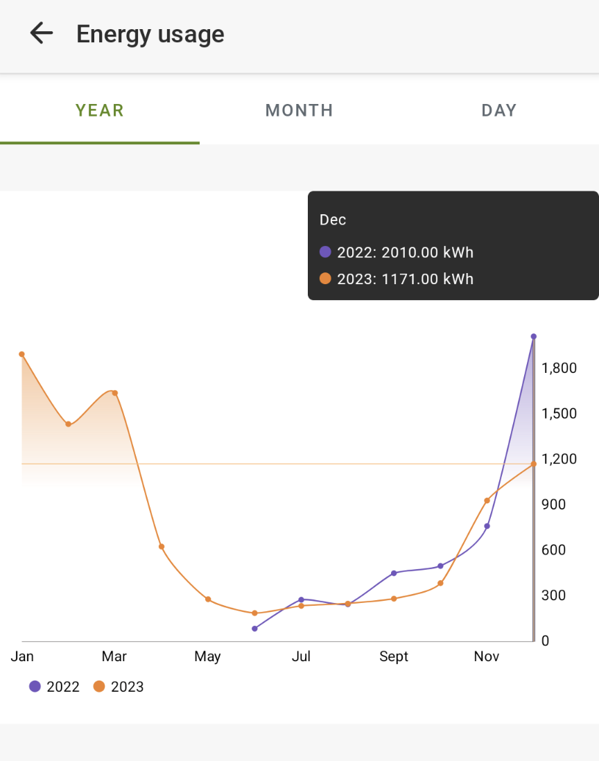

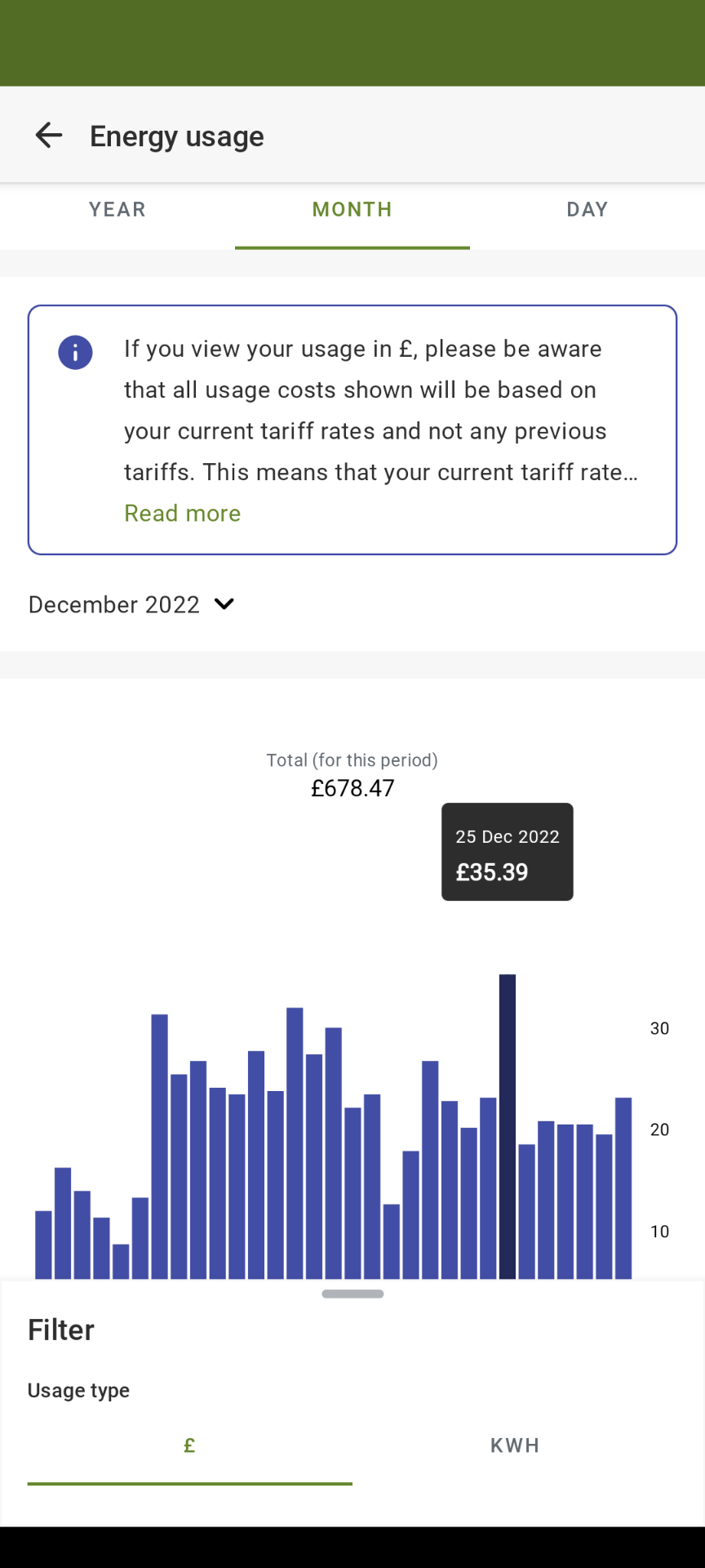

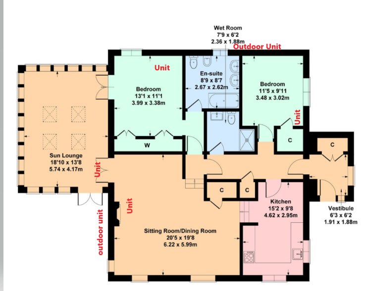

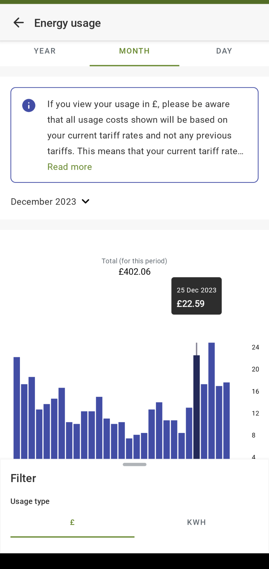

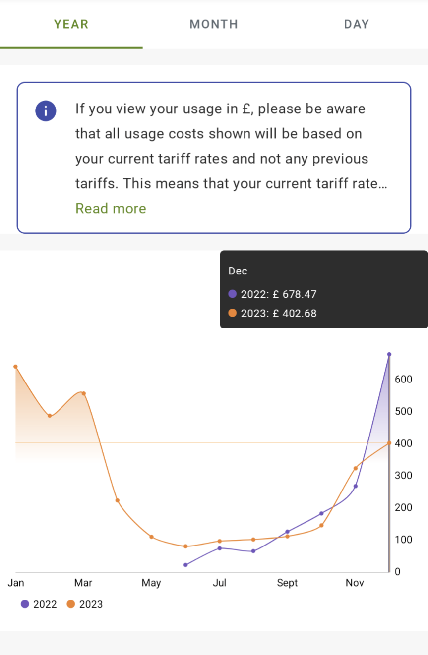

Gill Posted December 30, 2023 Posted December 30, 2023 Thought I'd come back with how the A2A journey has been going so far. We fitted 2 x 2.5 kw and 2 x 3.5 kw indoor units with 2 outdoor in our bungalow to replace 5 storage heaters. Aside from a couple of tests of the AC in summer, it wasn't until September they saw much action. We haven't changed energy tarrif so still eco 7. I'd love to have some like for like stats on energy usage but there are quite a few moving factors. - Old draughty double glazed widows replaced with triple glazed early this year - Underfloor insulation in the suspended floor void - Standalone garage converted into a granny flat with building work starting in July and finishing in November. Build work put a bit of an increase in our daytime electricity and since completion we've had friends stay (10 days total) and I'm heating it on the two or three days a week I'm not in the office. The granny flat has a single 2kW panel heater. - Last year was our first year in the place and we were baltic for much of October /November until we gave up with wearing 12 layers and accepted we needed to top up heat with peak heat when the storage heaters were no longer keeping the temperature above 16. After that, we decided to try to accept the cost, be comfortable (no more than 3 jumpers) and get baseline of what our energy needs really were. I thought I'd share the stats I have. September, October we're down on usage and cost which was a bit of a surprise given building work. I put that down to running heating only for an hour or so when needed and probably a good COP as the temps hadn't dipped way down. November we were up on usage and cost. Not surprising as I was running heating and dehumidifier in the granny flat to draw out last of the moisture, we had a cold snap that coinsided with friends staying in there for a few days. As I mentioned, last year we were trying to avoid top up peak heat which we gave up on as it was making us miserable. December is looking really positive. We've had family round for Xmas day as per 2022 so whole house and sunroom set to sauna ++ to keep the oldies from feeling a chill. This year it was much easier to heat the place and much warmer than last year. One other event that meant whole house and sunroom heating was cranked up again. We've also had young ones in the granny flat this week who are unfamiliar with short showers and off switches. I think we're likely to be £450 this month vs £670 December 2022. (Admittedly Dec last year have a good week + of very low temps where we were going through 80kWh daily). I'm not entirely trusting of the SP app but supposedly it is comparing last year to this year using current prices. If our December saving is comparable to Jan and Feb then hopefully we'll be saving around 500 over those months alone and enjoying more responsive and comfortable heating. Worth noting for balance - ROI not taken into account. Come July potential saving should be clearer (unless we fast track on our solar plans) . New system was about 9k fitted. It will have annual maintenance overhead unlike the storage heaters. System lifespan isn't going to be anything like that of storage heaters. Defrost cycles in very cold weather are regular (quite short periods so far even at - 6). Pure luck that the indoor units we tend to run together when very cold are connected different outdoor units. We opted for high wall mounted units so there's still the cool air pocket down low issue. I do wonder if a ceiling fan might help. It's a different type of heat which takes a bit of getting used to. As the room comes to temp, there's the feeling of cold draft as the air circulates. I find that's avoided if I don't try to crank the heat up very quickly but instead set a timer to give it 1 hour to come up to desired temp. All in ALL, very happy we made the switch and wondering if I'll regret not putting it into the granny flat. Much appreciated all the BH help and advice that went into my lengthy decision making 😁 1
MikeGrahamT21 Posted December 30, 2023 Posted December 30, 2023 Certainly a good reduction in kWh comparing the two years, the weather will have helped this December too, had some very mild days. How many m2 are you heating?
Gill Posted December 30, 2023 Author Posted December 30, 2023 (edited) 58 minutes ago, MikeGrahamT21 said: Certainly a good reduction in kWh comparing the two years, the weather will have helped this December too, had some very mild days. How many m2 are you heating? Yes, the mild December has definitely been a bonus. More winter months before I can get too optimistic but I'm quietly hopeful. We can now be even more inconsistent with what we heat which doesn't make for great measurements or comparisons. Living room. Room size 105 m3. Heated evenings /weekends /holidays. Till mid Nov heated 2 to 3 days a week when I wasn't working in the office. Usually set about 22. Bedroom. Room Size 40m3. Heated when temps are low only. It benifits from the living room unit as we're open ish plan. It helps avoid the living room unit working too hard when it's very cold. Set around 18. Bedroom 2. Office room / spare bedroom. Room Size 36m3. Heated when used as office by OH (3 days a week). Overnight +dehumidifier for winter laundry. Or guest staying and no longer being baked overnight. SunRoom. Room size 68m3. Winter only if we're having big family / friend gathering. Twice only this winter so far. Last year just once on Xmas day. Hall & kitchen only gets heated if very cold and then we leave bed 2 door open and run that unit at around 19. Bathrooms we don't heat. Rarely use one off hall and our main absorbs heat from bedroom or living room Unit placement was adjusted a little from pic. Sun room unit is centre of wall and bed 2 unit went on outside outdoor unit wall. Working well for our current layout. Last winter the living room, main bathroom storage heaters were always on at some level after November. Bed 2 only when OH was working at home. Kitchen and hall consistently baltic. 🥶 Edited December 30, 2023 by Gill
Crofter Posted December 31, 2023 Posted December 31, 2023 @Gill those room sizes are enormous! Is it a ft²/m² mixup?? Thanks for posting the update, really useful for someone like me considering making the switch soon.

joth Posted December 31, 2023 Posted December 31, 2023 (edited) 4 hours ago, Crofter said: @Gill those room sizes are enormous! Is it a ft²/m² mixup?? The quoted sizes are m3 so room volume not area. Looks about right vs plans for 2.7m ish ceiling heights. @Gill are you able to make use of the E7 cheap rate at all now? Planning a battery, or moving to a different tariff might reduce running costs assuming you aren't running the a2a all night. Edited December 31, 2023 by joth 1
MikeGrahamT21 Posted December 31, 2023 Posted December 31, 2023 (edited) 6 hours ago, Crofter said: @Gill those room sizes are enormous! Is it a ft²/m² mixup?? Thanks for posting the update, really useful for someone like me considering making the switch soon. @crofter they’re m3 so assuming normal ceiling height divide by 2.4 for m2. if ceiling height is right your around 11kWh/m2 for this month. Edited December 31, 2023 by MikeGrahamT21 2
Gill Posted December 31, 2023 Author Posted December 31, 2023 (edited) 1 hour ago, joth said: The quoted sizes are m3 so room volume not area. Looks about right vs plans for 2.7m ish ceiling heights. @Gill are you able to make use of the E7 cheap rate at all now? Planning a battery, or moving to a different tariff might reduce running costs assuming you aren't running the a2a all night. I think my volumes are right. We do have really quite hight ceilings for a bungalow. It's not traditional - previously was a substation so our living room has very high ceilings. E7 is still getting used for DHW, dishwasher, washing machine. Prior to holidays I'd use to warm living area before I'm up and out for work. With the holidays, that's switched off as I'm not up at 6. I'm quite liking a consistent temp for sleeping so one is sometimes kept on low if the temps have really dipped. I was interested again in batteries now (Feb 2024) the vat saving is not tied to solar instal. Our long term solar plan needs the 'to reroof or not' question answered so all went on hold this year. I need to do some more maths but last I was looking at a givenergy AIO, the ROI was getting where I need it to be. Think that was based on switching to a tarrif that would allow me to fully charge and discharge battery twice daily in winter (if such a tarrif exists) so potentially away from eco 7. The battery wouldn't be a money saver so much as added convenience especially when solar comes into the picture. It would also be nice to have some degree of backup in a power out given we have nothing else heating /powering the house. 4 hours ago, Ferdinand said: I'd suggest keeping a careful eye on the annexe - a 2kW direct panel can run up a lot of electric if used fairly constantly. There are through the wall heat pump based heat / cool / dehumidify A2A units designed for apartments which may be appropriate. I'm going to keep a close eye. My initial thought was is wasn't worth the investment for 5 months where heating on and average 2.5 days a week but I didn't think about overheating in summer so another thing on the monitor list. The place was stripped back to brick, reroofed and insulated up so it actually benifits from a blast of eco 7 between 5 and 7 to bring temp up and then it's just top up during the day. I could do with a monitor mind you just for my curiosity. Edited December 31, 2023 by Gill 1
