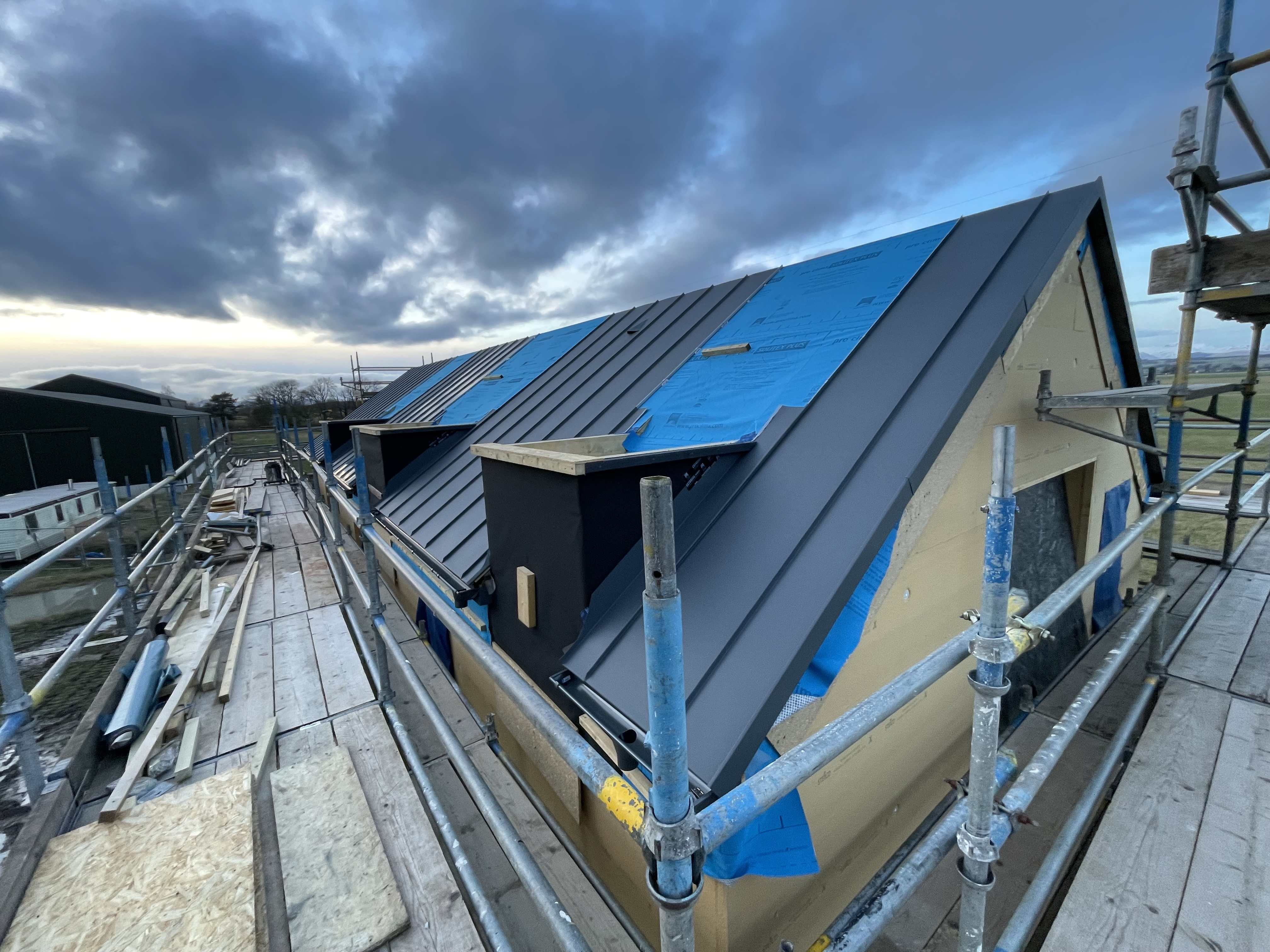

gavztheouch Posted December 1, 2024 Author Posted December 1, 2024 Looking for some opinions on my roof. I have a 18mm plywood ventilated deck for my standing seam roof. It sits on top of the basic roof joists and osb. the deck is 18mm plywood sitting on top of 50x50mm battens. Today we installed the 50x50mm battens. We used 100mm spax stainless steel screws to hold the battens down. I was worried about the 600mm centers not being accurate enough to make sure we were screwing into the joists ( I measured them drifting out with my 30m tape over the whole length of the roof. The joiner assured me not one screw will miss the rafters. Over the first ten joists this was mostly true as I didn’t spot many not hitting their target. I felt assured and went off and did something else. When I returned at night with my head torch I noticed a few screws that did not go into the joist. As I walked to the far end of the roof it got a lot worse, I counted 103 screws missing the rafters out of 300 so about 1/3. Not to mention the ones you can’t see that will be just under the surface with not much holding force. Some rafters have every screw on the batten missing the rafters. My intuition say the engineer will have over specked and this will most likely be ok as it is. However I am not very happy that things like this keep happening. The only way of fixing it would be to have someone inside spotting for someone on the roof to call out which screws to remove and rescrew. This will make a lot of hole in the membrane but I have come to relise this first membrane should hopefully never see water, however it is still annoying. I also don’t think they will fix it or I will need to pay them to fix it. I also don’t like all these screws poking out as it will make getting a good fit for my wood fibre insulation difficult. Should I be annoyed, what would you do?
saveasteading Posted December 1, 2024 Posted December 1, 2024 Yes be annoyed. If they miss at 600cc, then there is 1200 between fixing. That's too far. Regardless of anyone's hunch in it your Engineer has said 600, so that should be done. 2 hours ago, gavztheouch said: My intuition say the engineer will have over specked They may have gone to the next screw size up, but don't play with centres or miss any out.

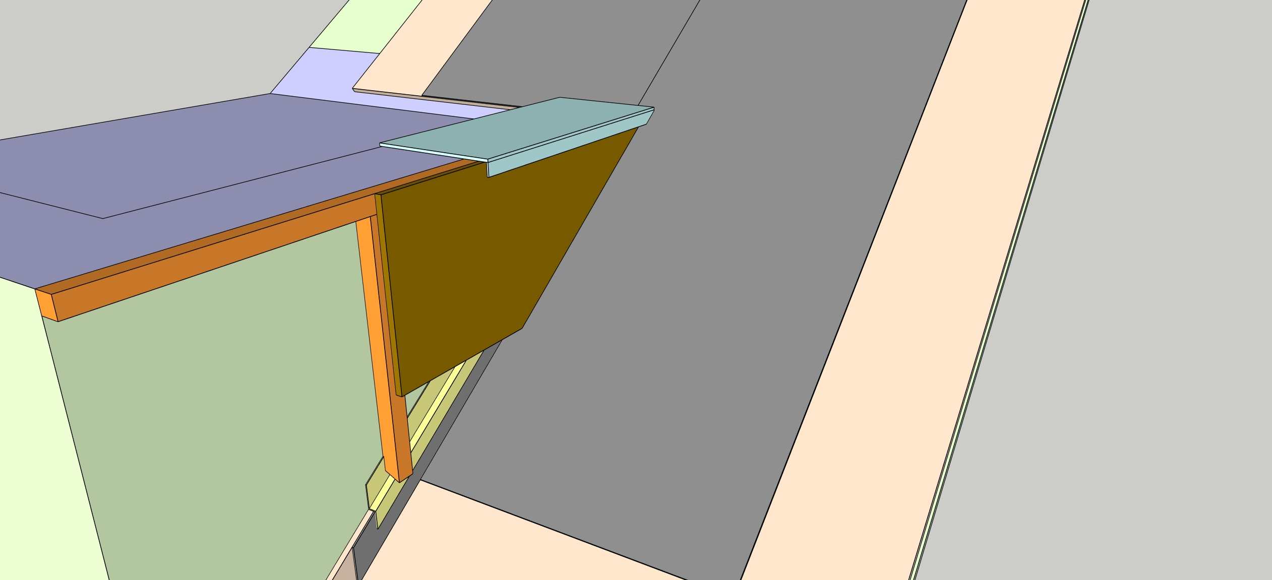

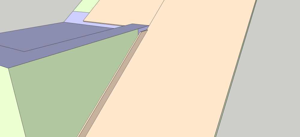

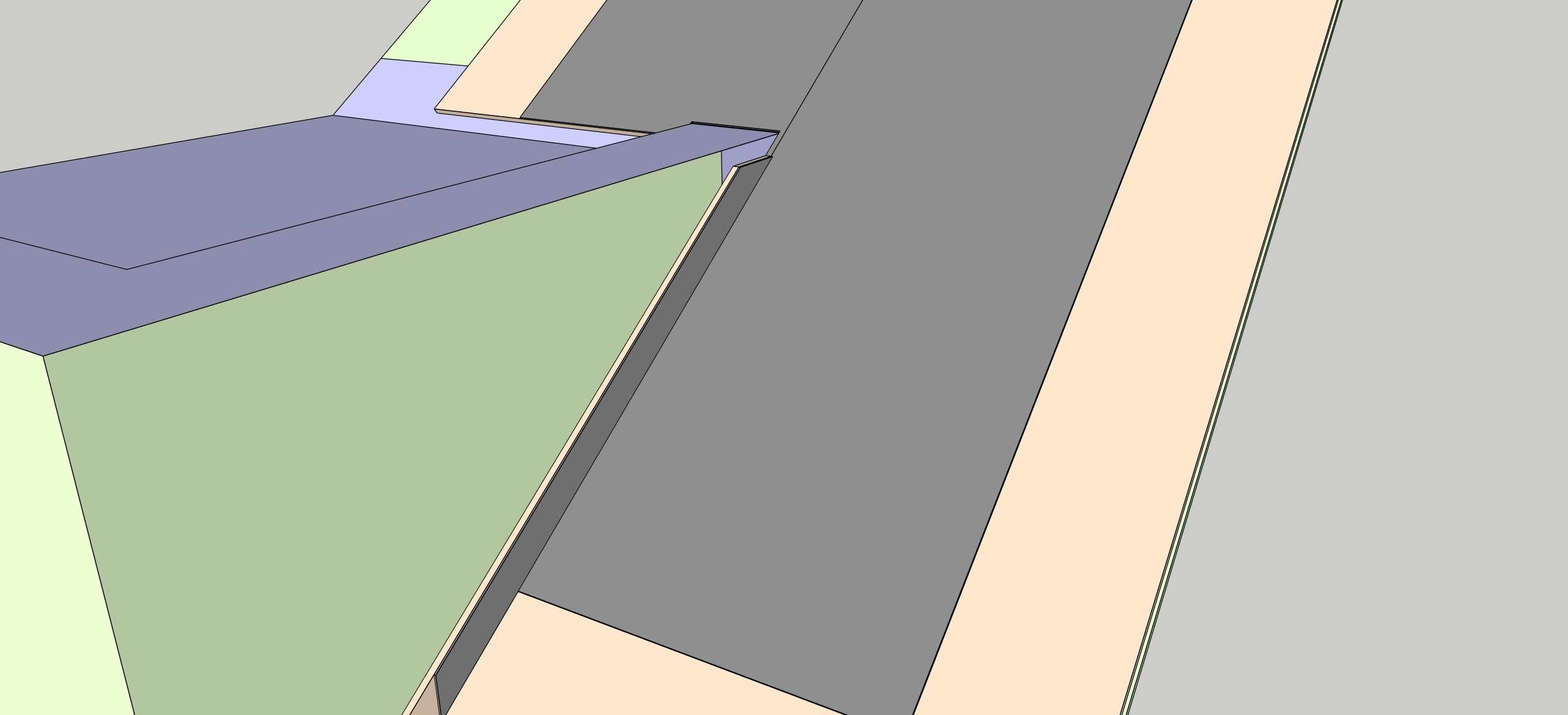

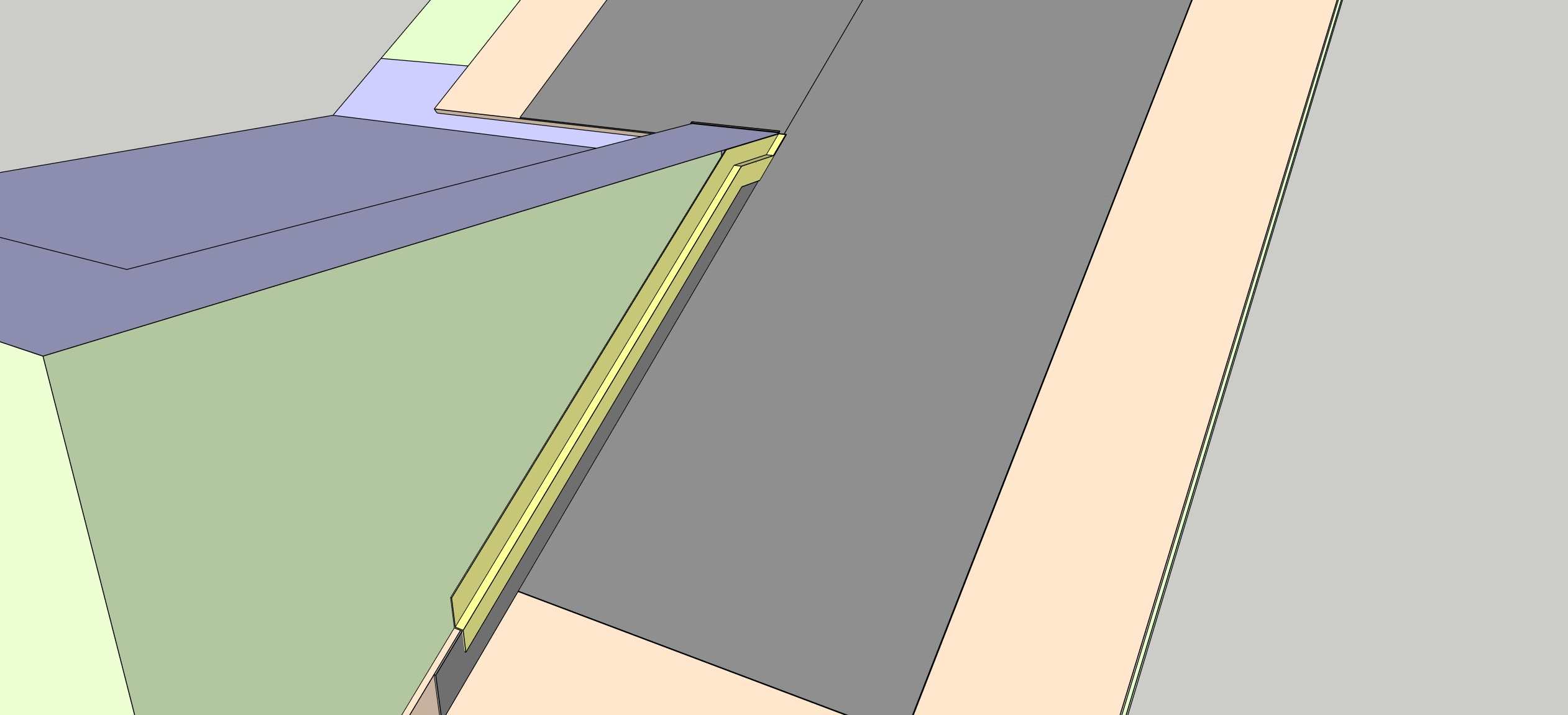

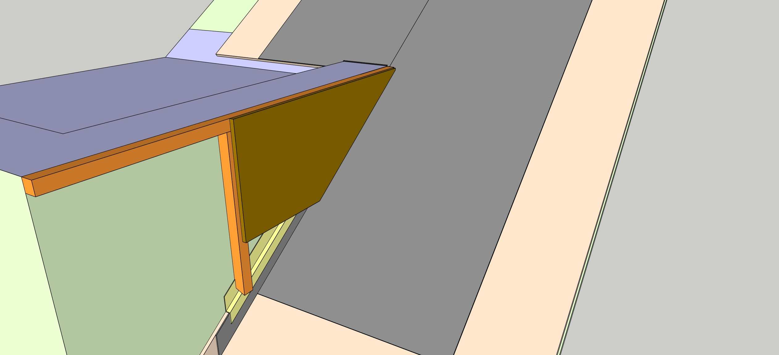

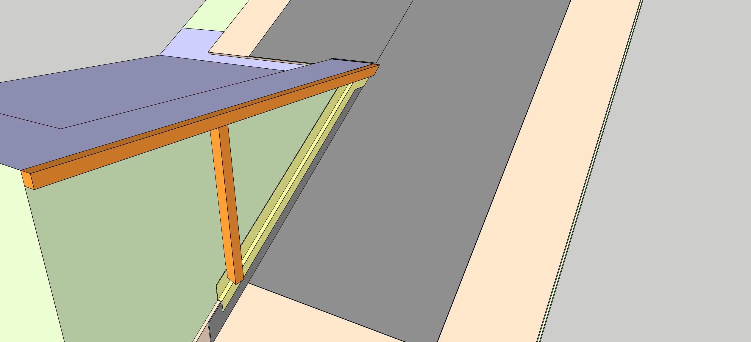

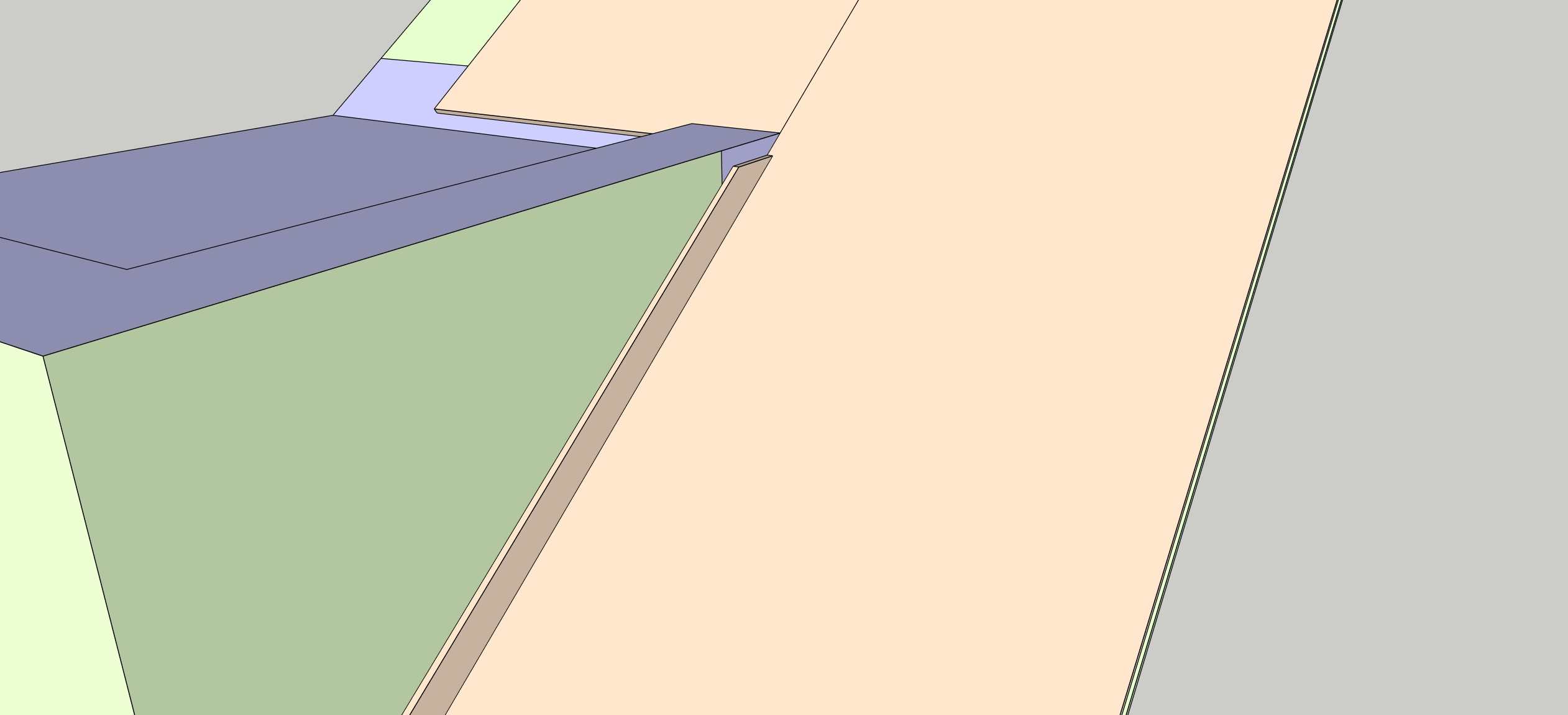

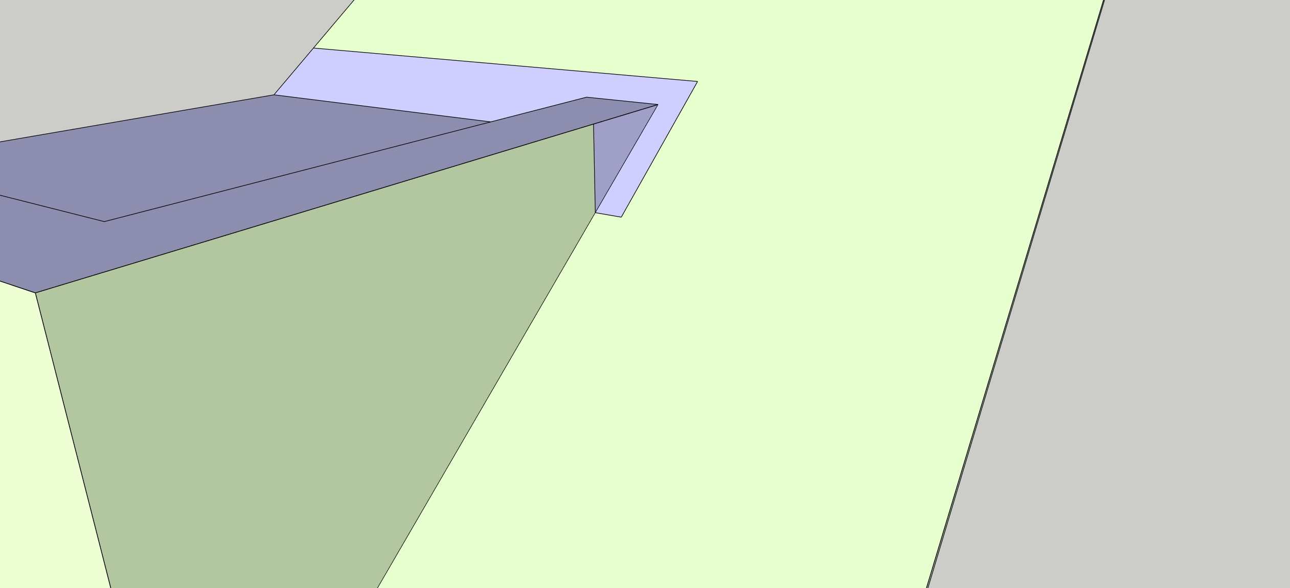

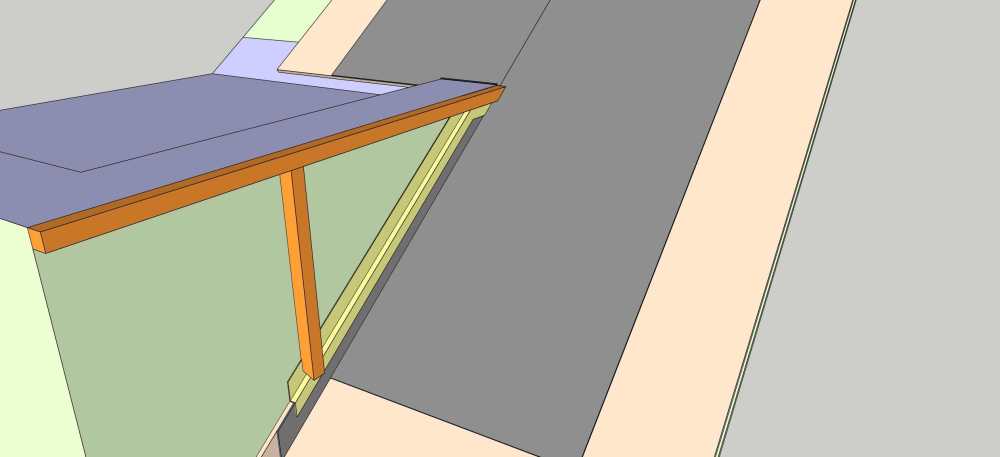

gavztheouch Posted December 26, 2024 Author Posted December 26, 2024 (edited) Hi everyone, Im looking for some ideas and opinions on my flat roof design by my architect. I am a bit worried about the use of sealant as a primary waterproofing layer on my new build roof. Here is a walkthrough of the design and how to build/sequence the detail. Step one: The green coloured roof in the image is a layer of osb attached to the rafters, it is covered in a breather membrane. The purple part is firestone epdm formed inside the parapet, up the walls and down the other side of the parapet to form a little triangle web. Step two: A ventilated deck is formed above the original osb roof and epdm. This layer is covered in another breather membrane. There is a plywood upstand running up the cheeks to form the standing seam upstand against. Step Three: Standing seam Greencoat metal roofing material is added, note the upstand against the dormer cheeks. Step four: A flash band tape is added to seal the standing seam metal roof against the dormer cheek membrane. The tape is called extoseal by proclima. Step five: Cladding battens are added. Step Six: Add wooden cladding Step Seven: Adding metal capping piece over parapet walls tight against metal roof Step eight: Add sealant where the capping piece meets the roof. My issue with the design is the reliance on sealant to waterproof the junction between the capping piece and metal roof. This will have the roof above pouring water onto this area and also wind driven rain will be blown back against it. I have 4 dormer windows so there will be 8 of these junctions. The architect did mention I could slip the capping piece under the standing seam. I think for that to be better it would need to be running up the roof with a suitable overlap to stop wind driven rain and capillary action. I think it would also need to flair out and become flat to be able to go under the roof which will be difficult with a steel capping piece. Also unless you lap the metal roof like slates in this area you will always need to seal certain edges with sealant. I have a few ideas on how to better the design but I wanted to get some opinions on the design as it stands today. Would you do this detail on your new roof? Cheers Gavin Edited December 26, 2024 by gavztheouch
saveasteading Posted December 26, 2024 Posted December 26, 2024 You are correct. Flashband and sealant is more for repairs than newbuild. You should be channeling the water away from the interface using metal flashings. These should underlap the cladding, say 100mm or more. You do need sealant. It should be a tape of silicon that is screwed tight at the joint. It should be a specific to cladding product that does not harden in time.

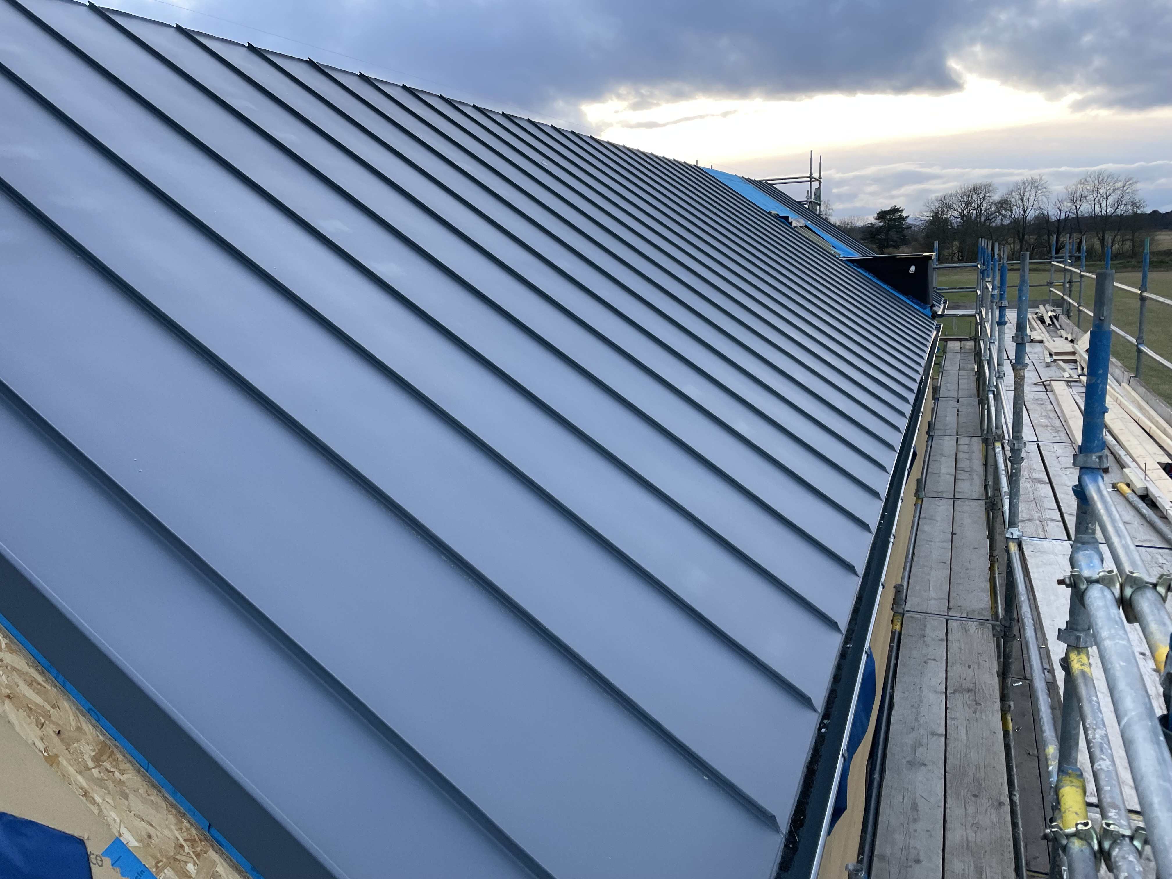

gavztheouch Posted February 16, 2025 Author Posted February 16, 2025 Still up at roof level but I see light at the end of the tunnel with the roof. A couple of weeks and I should be able to get rid of the hire scaffold and then switch over to my own. last week I installed my first window, 1 down 23 to go.. What this project needs is a one man band joiner. I need someone I can work with together. What I find is most companies work as a pair which leaves me redundant and paying twice as much. I would rather employ one person for a long time rather than multiple people for a short time. This is especially true with theses passive house style builds as a lot of time can be lost scratching heads with unfamiliar details. 3

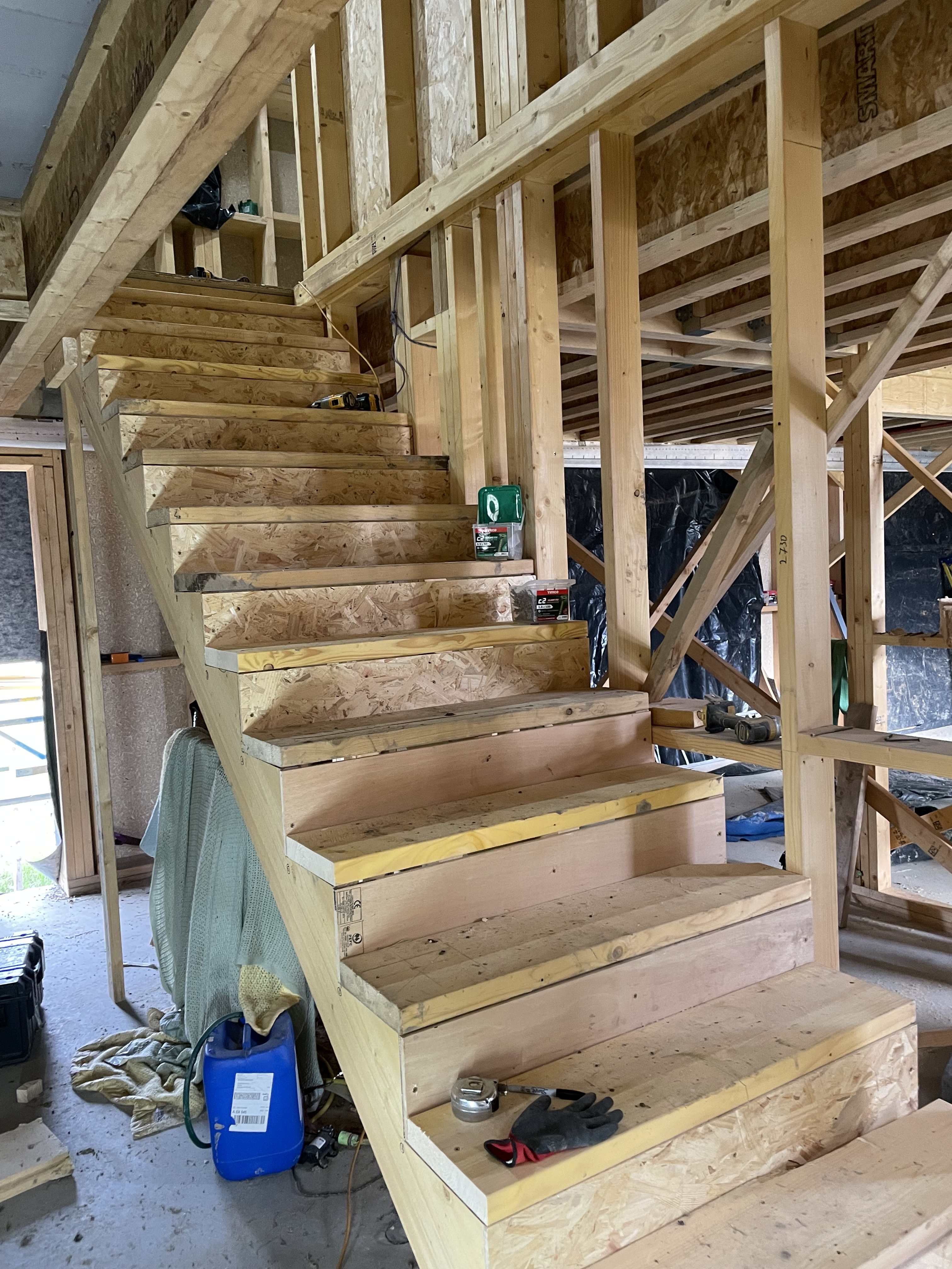

gavztheouch Posted February 16, 2025 Author Posted February 16, 2025 Built a rough staircase today. I needed a better way of getting materials upstairs. Next step is to take the windows upstairs ready for fitting. 6

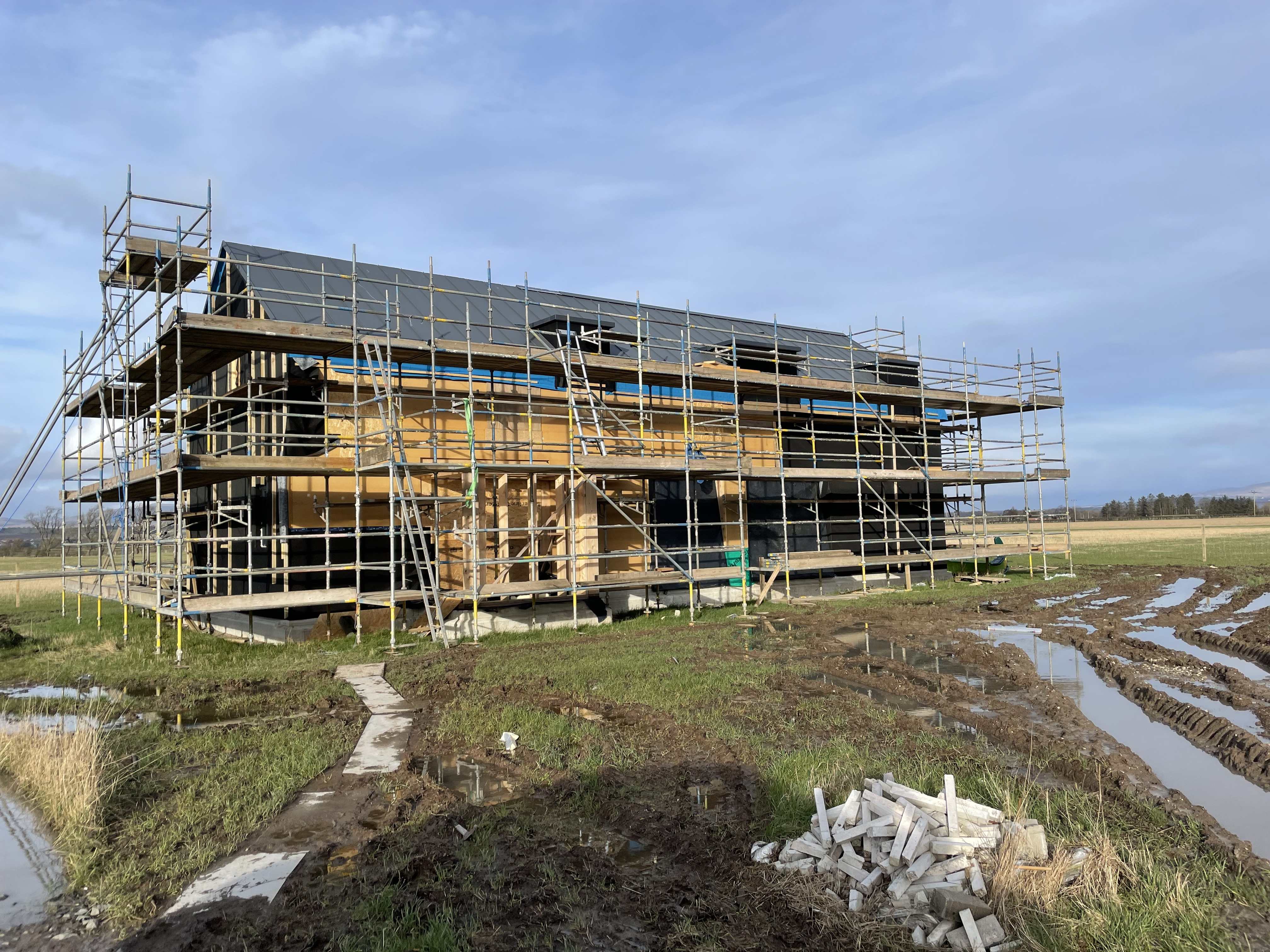

gavztheouch Posted March 14, 2025 Author Posted March 14, 2025 Roof complete! Major relief. Third baby is due on the 16th of March. Scaffold came down yesterday. Next job is to finish building the porch, install the rest of the windows and complete the outer membrane. we have been lucky with the weather low wind and not much rain. Need to wind proof the membrane in case we get another storm soon. 3
Nestor Posted March 14, 2025 Posted March 14, 2025 @gavztheouch Looks great, very enjoyable part of the build. What is the final wall build up, looks like 80mm (?) T&G Wood fibre over the whole building.
gavztheouch Posted March 14, 2025 Author Posted March 14, 2025 10 minutes ago, JamesP said: @gavztheouch Looks great, very enjoyable part of the build. What is the final wall build up, looks like 80mm (?) T&G Wood fibre over the whole building. @JamesP yes it’s 60mm wood fiber 12 mm Elka board 245mm stud filled with wood fiber, 12mm osb then 45mm service cavity and plasterboard 1
Nestor Posted March 14, 2025 Posted March 14, 2025 9 minutes ago, gavztheouch said: @JamesP yes it’s 60mm wood fiber 12 mm Elka board 245mm stud filled with wood fiber, 12mm osb then 45mm service cavity and plasterboard Similar build up,20mm Cedar, batten, counter batten, breather membrane, 40mm wood fibre, 260mm Rockwool, Vapour barrier, 11mm OSB, Batten, Plasterboard. And lots of airtight tape.
gavztheouch Posted March 14, 2025 Author Posted March 14, 2025 1 hour ago, JamesP said: Similar build up,20mm Cedar, batten, counter batten, breather membrane, 40mm wood fibre, 260mm Rockwool, Vapour barrier, 11mm OSB, Batten, Plasterboard. And lots of airtight tape. @JamesP oh yes I forgot I have an external membrane and internal vapour barrier. Do you have a closed cladding or is it open rain screen?
Iceverge Posted March 14, 2025 Posted March 14, 2025 1 hour ago, gavztheouch said: internal vapour barrier Osb will be fine as an airtight layer so long as you don't get rubbish stuff. Vapour barriers are only for drawings in my view . Airtighess is what really stops the moisture migrating into the wall.
Nestor Posted March 14, 2025 Posted March 14, 2025 5 hours ago, gavztheouch said: @JamesP oh yes I forgot I have an external membrane and internal vapour barrier. Do you have a closed cladding or is it open rain screen? Cedar is closed, I cut a half lap of 10mm on each edge to allow for some shrinkage (local cut boards). 1

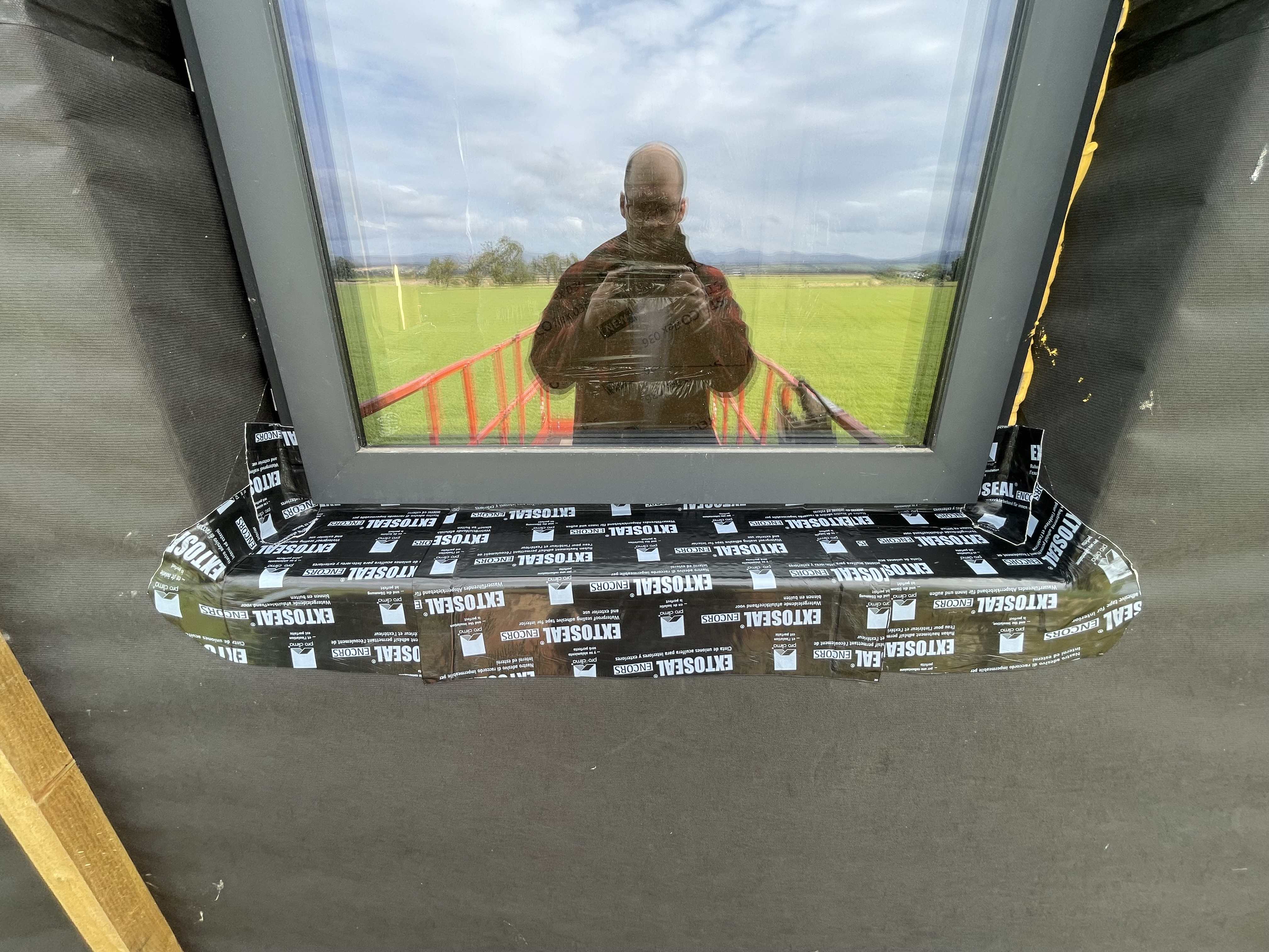

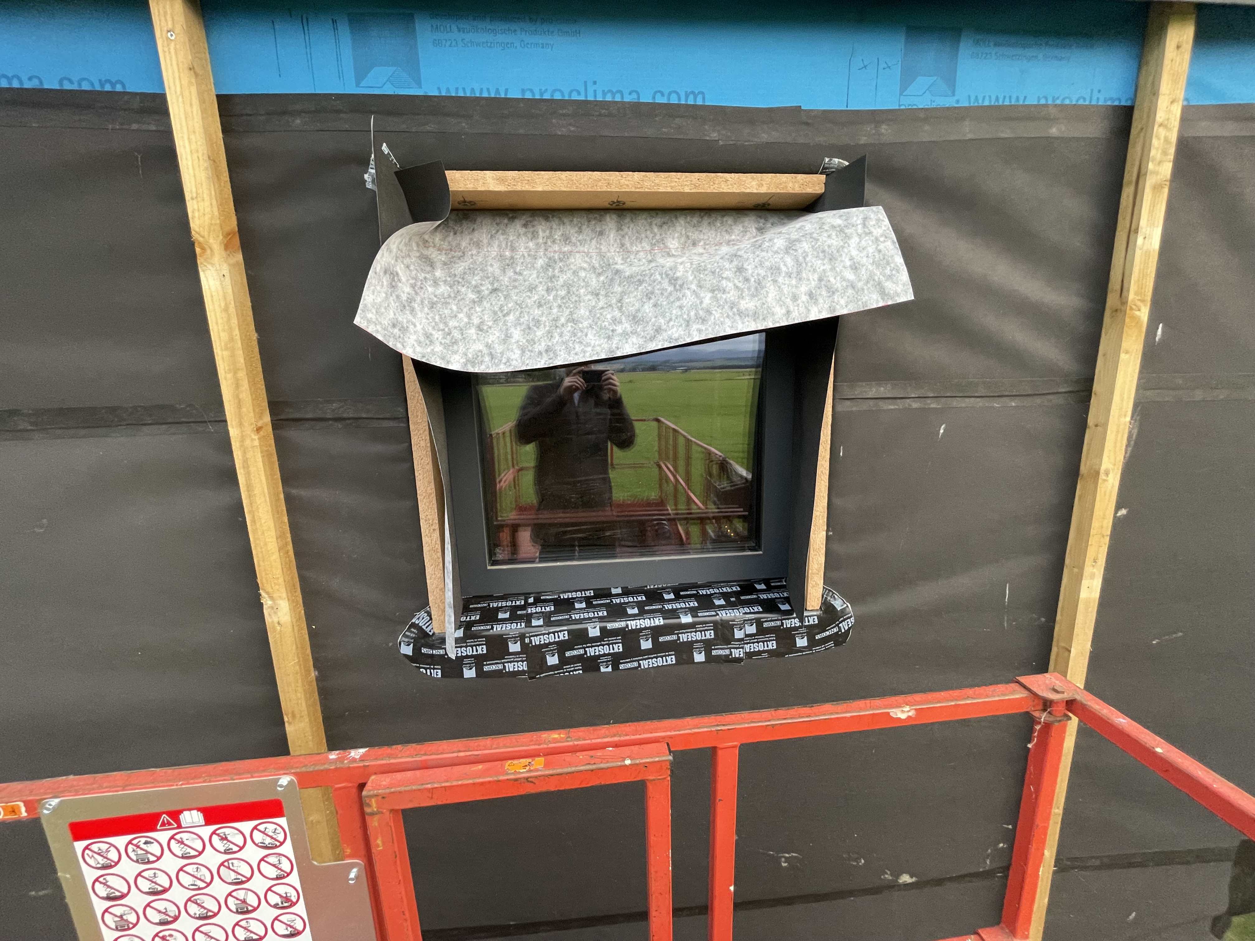

gavztheouch Posted August 20, 2025 Author Posted August 20, 2025 Started dressing in the windows on the outside ready for the cladding. I’m using extoseal for the sill and wood fibre insulation around the windows with a wrap of membrane around the insulation. Take ages per window 1
