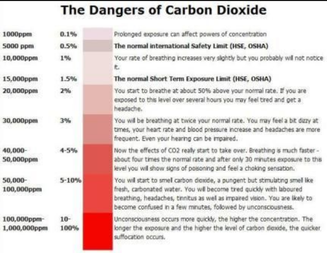

RobLe Posted December 22, 2023 Posted December 22, 2023 I don't think it should worry you. I notice rooms are stuffy around 1500ppm - there's still a long long way to go before it's acutely dangerous:

Adrian Walker Posted December 22, 2023 Posted December 22, 2023 I would suggest that you have a CO2 monitor to check that the air is good 24/7 as CO2 is very insipid. You’re very unlikely to die, just have a bad headache with high (2500+ ppm) CO2 levels.
SteamyTea Posted December 22, 2023 Posted December 22, 2023 (edited) If a person expels 0.7 kg of CO2 a day, and a house, 10m by 6 m by 5 m, has 300 m3 of air in it, that is 375 kg of air. After a day, one person would have increased by CO2 by 0.18%. So about 5 days to start noticing anything. Or a day for 5 people. Apollo 13 got back OK, and they had greater problems than just CO2. Edited December 22, 2023 by SteamyTea 1
