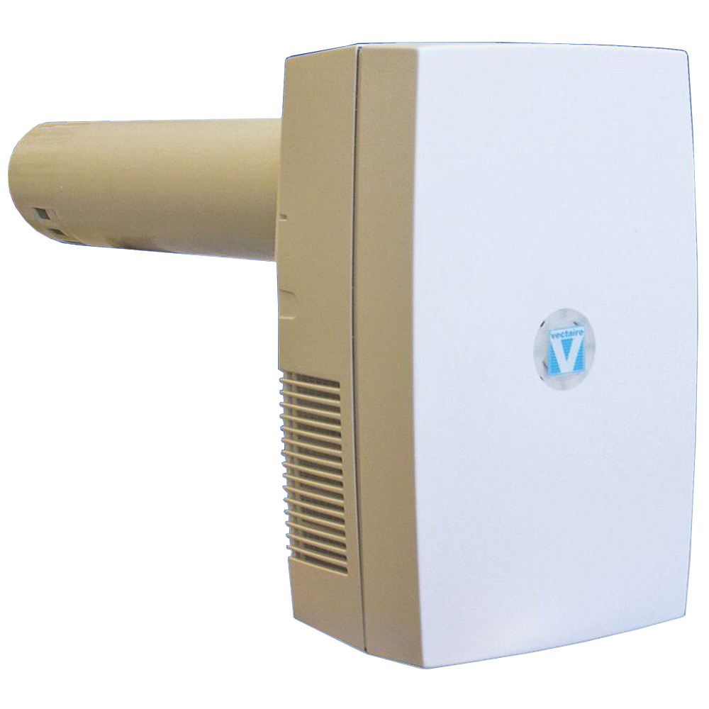

SteamyTea Posted December 5, 2023 Share Posted December 5, 2023 7 minutes ago, Beelbeebub said: I did think that something like that acting as a heatpump powered heat recovery ventilation unit might be good for damp properties. Would provide really good ventilation with a decent amount of heat. You can get them, our old mate @Jeremy Harris had one. Can't remember the make. Think it was only 2 kWp, which would me useful in my house, but for larger properties several may be needed. Link to comment Share on other sites More sharing options...
Iceverge Posted December 5, 2023 Share Posted December 5, 2023 2 hours ago, Beelbeebub said: I think getting the cop up is going to be hard as it's a function of the mass of air you can flow through the Heatpump. The less mass, the greater the temp drop (for a given power) and thus the colder the downside of the HP needs to be. Agreed, as the bulk of the air needs processed is external air then maybe having the unit outside and ducting hot air inside is the answer. Effectively a "monoblock" A2A. 2 hours ago, Beelbeebub said: Defrost might be an issue. Anymore so than another heat pump? 2 hours ago, SteamyTea said: Think it was only 2 kWp, which would me useful in my house, but for larger properties several may be needed. A Genvex unit from memory. 1 Link to comment Share on other sites More sharing options...
SteamyTea Posted December 5, 2023 Share Posted December 5, 2023 8 minutes ago, Iceverge said: Agreed, as the bulk of the air needs processed is external air then maybe having the unit outside and ducting hot air inside is the answer. Effectively a "monoblock" A2A. Anymore so than another heat pump? A Genvex unit from memory. Yes, you are right. Anyone else got one as it would be interesting to know how good, or bad, they are. Link to comment Share on other sites More sharing options...

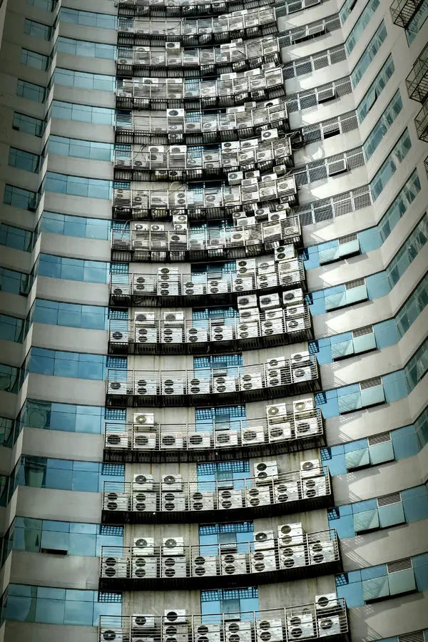

Iceverge Posted December 6, 2023 Share Posted December 6, 2023 I suppose ultimately it boils down to: 1. Drilling huge holes in the wall 2. Drillings lots of slightly smaller holes in the wall. 3. Accepting the install complexity of an A2A mini split. My impression is the world has already decided. Link to comment Share on other sites More sharing options...
Beelbeebub Posted December 6, 2023 Share Posted December 6, 2023 1 hour ago, Iceverge said: I suppose ultimately it boils down to: 1. Drilling huge holes in the wall 2. Drillings lots of slightly smaller holes in the wall. 3. Accepting the install complexity of an A2A mini split. My impression is the world has already decided. I think it's inevitable we are going to end up with boxes outside our homes One interesting concept I've seen for high-rise properties is a central brine (glycol) water network drawing heat either from ground source or from big air exchangers in central location. This brine is piped to each flat where a small water to water unit does the actual heat pumping using the communal external heat exchanger. Sort of a hybrid between a whole building heating system with heat meters and the individual units with multiple external boxes Link to comment Share on other sites More sharing options...
JamesPa Posted December 6, 2023 Share Posted December 6, 2023 3 hours ago, Iceverge said: I suppose ultimately it boils I think an architect could slightly modify this and declare it beautiful. Repeated patterns are a common theme in architecture and the natural world. It just needs a bit more symmetry and consistency. Link to comment Share on other sites More sharing options...
