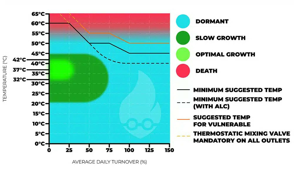

FarmerN Posted December 4, 2023 Posted December 4, 2023 (edited) 34 minutes ago, Beelbeebub said: If you are doing significant work on the heating system, then the answer is simply to make sure you design that new/upgraded system for low temperature operation. Iirc 55C is the current standard, but if you can size it for 45C then the efficiency of a HP starts to hit the break even with gas. Trying to do exactly that at the moment, I want to run DHW at 43-45 C but told its almost impossible to buy a thermostatic shower mixer valve that will give me a hot shower at that temperature. I want to stick to a thermostatic valve, not manual, to deal with the 55-60C temperature of the weekly sterilzation cylcle. Edited December 4, 2023 by FarmerN spelling
Conor Posted December 4, 2023 Posted December 4, 2023 3 minutes ago, FarmerN said: Trying to do exactly that at the moment, I want to run DHW at 43-45 C but told its almost impossible to buy a thermostatic shower mixer valve that will give me a hot shower at that temperature. I want to stick to a thermostatic valve, not manual, to deal with the 55-60C temperature of the weekly sterilzation cylcle. Most mixers work at those temps. All of ours do. Just the manufacturer's don't state this. And sterilisation not needed on a modern closed system. 1
JohnMo Posted December 4, 2023 Posted December 4, 2023 24 minutes ago, Conor said: And sterilisation not needed on a modern closed system. Even if it was needed; as long as the system volume is suitably sized to give a good turn over of water, a normal heating regime is good for sterilising anyway. If you are turning over most the volume of the cylinder each day looks like to store at any temp you want. But if you have a huge cylinder and low usage there could be issues.
Beelbeebub Posted December 4, 2023 Posted December 4, 2023 1 hour ago, FarmerN said: Trying to do exactly that at the moment, I want to run DHW at 43-45 C but told its almost impossible to buy a thermostatic shower mixer valve that will give me a hot shower at that temperature. I want to stick to a thermostatic valve, not manual, to deal with the 55-60C temperature of the weekly sterilzation cylcle. Our DHW is about 40-45C and our thermostatic mixer showers work fine. The only issue we have had, is our Mira unit makes a whining sound at certain combinations of temp and flow. I don't think that is directly caused by the lower DHW temp. Annoyingly one of those settings seems to be the one everyone likes! 1
Roger440 Posted December 4, 2023 Posted December 4, 2023 1 hour ago, Beelbeebub said: I think it will. If you are doing significant work on the heating system, then the answer is simply to make sure you design that new/upgraded system for low temperature operation. Iirc 55C is the current standard, but if you can size it for 45C then the efficiency of a HP starts to hit the break even with gas. Then, one day in the future when you need to change your boiler you have 5ge option of just dropping in a HP. I intend to do do exactly that. But thats because i have a resonable level of understanding. Were i an uninformed average customer, that wouldnt happen. They would get to pay twice. Ref oil cost, i dont think it will. Certainly not anytime soon. They either have to increase oil prices or decrease electricity. The latter clearly isnt going to happen. Will be a brave government who choose to increase, artifically, heating oil given the usage profile and low number of affected household. Worst case is, its the same price as road disel. If it was higher even, than that, id just use road diesel or red disel if that still exsists by then instead. As will most people pushed that far. Which at current prices would be circa 16p per kwh. So even if it does get to that, the difference wont pay for itself in my likely lifetime. Ill probably be dead before then. Of course, they may forcibly install one, as the new legislation gives them the right to do. Not much i can do about that.
