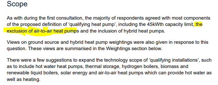

Iceverge Posted December 3, 2023 Share Posted December 3, 2023 13 hours ago, magnayn said: The government is so terribly good at solving things with targets. Ask them how their smart-meter rollout targets are doing.. As you say - simply address the price ratio between gas and electricity and the market will solve it itself. Like all these tinkerings, I expect massive unintended consequences. Completely agree. Targets are the "wish it and it'll come true" equivalent for politicians. Plain A2A heat pumps were excluded. They are the cheapest form of heat pump and can readily deliver a COP of 4 or 5 for £1500 installed or £37B for the UK. You could just bolt one into the hallway or living room or every house and let them accommodate the "base load" of house heating with exiting gas to top the heating. At a grid CO2 of about 200gCO2/kWh and a gas boiler CO2 of about 300g/kWh with a COP of 4 you could would have heat in your house with an A2A HP at 50g/CO2. Even if you shifted half of your energy use to the A2A you would take your CO2/kWh from 300g/Kwh to 175g/kWh of CO2. A 42% reduction in household CO2 emissions for less than the cost of Hinkley point C. Yeah, lets exclude that. 🤪 1 Link to comment Share on other sites More sharing options...
magnayn Posted December 3, 2023 Share Posted December 3, 2023 16 minutes ago, Iceverge said: Plain A2A heat pumps were excluded. They are the cheapest form of heat pump and can readily deliver a COP of 4 or 5 for £1500 installed or £37B for the UK. I know. Completely maddening. We should be gunning for A2A in the places where it's obviously the simplest option - such as many flats. But. IMO, we have an industry shilling for complexity. Experts such as, umm, ahem, geat heek, continue to make bizarre claims like "oh the SCOP on A2A is not as good and it's hard to calculate". It seems completely self-evident that a system exchanging heat into water, then exchanging that again into air is going to be more lossy than one that skips out the middle man. I look at these 'highly efficient heat pump hot water tanks" that cost £1,600 for the tank alone, and my ears prick up when they debug bad installations and just side-mention "oh, of course these things need annual maintenance" and can't help but conclude that for many, an electric shower is like £100 from screwfix, and they could replace it every single year and /still/ end up ahead, and not have to find space they may not have to put a giant tank. We seem completely trapped. On one end we've the zealots, making wild claims about the universal suitability of heat pumps in retrofit because you'll "definitely save money" (who variously ignore installation costs, or maintenance costs, or the gas/electric price ratio, or the fact that low temperature systems tend to run 24/7 and end up emitting about 7% more heat, or that A2W installs seem to be supremely sensitive to very narrow design parameters). We've the grant-harvesters and training industry, who _like_ it complicated so they can sell their services and won't recommend anything that doesn't line their pockets. And at the other end we have the "heat pumps don't work" crazies with their "don't work in cold climates" nonsense -- of course unfortunately they don't have to go too far to find horror stories. I think many are just angry about net zero, and it's all just a proxy fight for them. Here on planet earth, the majority simply want warm homes and hot water at the lowest cost over the medium term, and frankly everything else comes a distant second. They are not interested in having to tweak weather compensation curves to avoid crazy bills, or constantly tinkering with their system, or endless costs in maintenance. They also don't really want ugly, possibly noisy fan units and large water tanks - but will likely put up with them if it achieves Job #1. There's a complete dearth of honest brokers. The government could, say, pay for home surveys that gathered up all the information to act as an entry-point into system design for the various options - A2W, A2A, (which could include "not worth it _yet_"). You could then have a tender process where suppliers could bid for the work. You could even use a scheme to underwrite the running costs -- effectively guarantee to the householder that they will come out no worse off. Or, really, just make gas pricier. Taxing boilers in this way just strikes me will lead to bad outcomes -- like: old, non-condensing units being patched up because it being too expensive to swap; boiler imports (boiler gangs across the NI/ROI border anyone?); a healthy "buy all the components of a boiler as parts" and who knows what inventive circumventions will materialise. But I doubt it will move the retrofit market one iota. Link to comment Share on other sites More sharing options...

Beelbeebub Posted December 3, 2023 Share Posted December 3, 2023 1 hour ago, Iceverge said: Completely agree. Targets are the "wish it and it'll come true" equivalent for politicians. Plain A2A heat pumps were excluded. They are the cheapest form of heat pump and can readily deliver a COP of 4 or 5 for £1500 installed or £37B for the UK. You could just bolt one into the hallway or living room or every house and let them accommodate the "base load" of house heating with exiting gas to top the heating. At a grid CO2 of about 200gCO2/kWh and a gas boiler CO2 of about 300g/kWh with a COP of 4 you could would have heat in your house with an A2A HP at 50g/CO2. Even if you shifted half of your energy use to the A2A you would take your CO2/kWh from 300g/Kwh to 175g/kWh of CO2. A 42% reduction in household CO2 emissions for less than the cost of Hinkley point C. Yeah, lets exclude that. 🤪 Yeah, government targes and subsidy schemes do distort markets. Whilst I agree that A2A units are being unfairly marginalised given their potential, I can see the reasoning as to why they were excluded - at least when the system was set up (basically it would have been used to install summer cooling and make co2 emissions worse). Of course now, the situation is different - summer cooling might be useful for brief periods, and newer technologies like low GWP refidgerant mean installing lots of A2A units.mught not be such a bad thing now. Link to comment Share on other sites More sharing options...
Beelbeebub Posted December 3, 2023 Share Posted December 3, 2023 5 minutes ago, magnayn said: It seems completely self-evident that a system exchanging heat into water, then exchanging that again into air is going to be more lossy than one that skips out the middle man. I would say it's not quite that simple. The efficiency is governed by the temperature lift. Th heat output a given emitter is (crudely) the effective area x the temperature. A2A units use fan coils. If the refidgerant temp to get a given heat output is higher fornthr fancoil than it would be for the refidgerant in a plate heat exchanger feeding a UFH system, then the fan coil will be less efficient. Though the complexity will be less. But then you have to deal with high pressure refidgerant lines through the house which may be more problematic Vs low-pressure water. All that said, a2a is an avenue we should be using more, especially for flats (though it does mean lots of boxes on buildings) Link to comment Share on other sites More sharing options...
