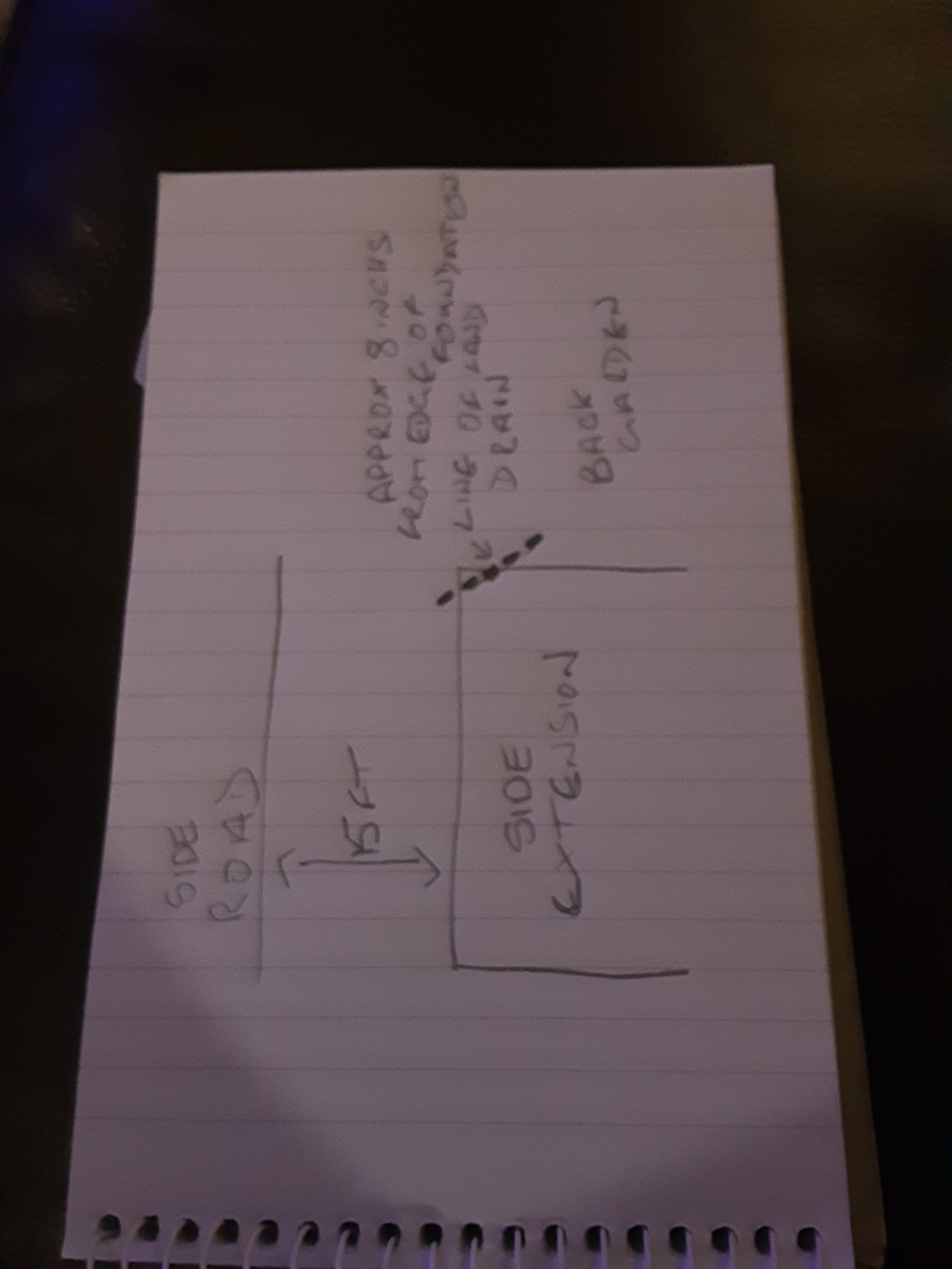

iant63 Posted November 18, 2023 Share Posted November 18, 2023 Saltglazed pipe,land drain ,3 inches below newly poured foundation concrete. In the corner of the trench. Not sure what to do ,can't leave as is Thanks for any advice Link to comment Share on other sites More sharing options...

iant63 Posted November 18, 2023 Author Share Posted November 18, 2023 I'm pretty sure it's live it was clean when the clay came off . The collar was clear and had never been mortared up .no photo as I didn't femember until everything was up to dpc. It was only when the inlaws started going on about aco drains and where they could go that I remembered . This I might dig down ,take a short length of pipe out and put a camera up and down it to see where it starts and finishes. I've only been trying to help out ,I'm on a site miles away . Worrying times .I don't want finish it , just for there to be problems later .also the pipe doesn't run under the super structure ,but that's beside the point I've got the spread on the concrete,and worry about anything washing into the pipe.thanks for replying Link to comment Share on other sites More sharing options...
iant63 Posted November 18, 2023 Author Share Posted November 18, 2023 Thanks for your replies. One end of the pipe points to the road and one end points to the back of the garden. Doesn't point to any houses. The original house is a spread footing, 2 course of brick dip and sat on a thin course foundation. The house drains are just below this. Any Ideas? Link to comment Share on other sites More sharing options...
ProDave Posted November 18, 2023 Share Posted November 18, 2023 Perhaps a sketch of the site layout showing where you think the pipe goes under your footings and where it would continue to in both directions if it maintained a straight line. Link to comment Share on other sites More sharing options...
iant63 Posted November 18, 2023 Author Share Posted November 18, 2023 Thanks ProDave. House is on corner plot. Back garden backs on to another back garden. Link to comment Share on other sites More sharing options...
ProDave Posted November 18, 2023 Share Posted November 18, 2023 If it really is only just passing under the extreme corner I would probably say nothing, stop worrying and carry on. It would be easy to divert at a later date if you ever did find something had blocked. 1 Link to comment Share on other sites More sharing options...

Redbeard Posted November 18, 2023 Share Posted November 18, 2023 @iant63, are you most concerned about potentially blocking (and restricting future access to) the drain, or weakening the footing? If you want 100% peace of mind can you dig down, re-route the drain on that corner with swept bends to sit outside the line of the footing, and ram the old drain full of concrete? Of course I know nothing else of the job but that would seem to perhaps to sort things, even if leaving you with a slightly 'bendy' drain run. Link to comment Share on other sites More sharing options...
Conor Posted November 18, 2023 Share Posted November 18, 2023 If the pipe is just going under the footing, then should be easy enough to divert it a metre or so. But first trace it both ways and see what it does! Link to comment Share on other sites More sharing options...
iant63 Posted November 18, 2023 Author Share Posted November 18, 2023 Thanks Redbeard. Yes more worried about weakening the footing. Suppose it doesn't matter how bent the pipe is as its a land drain. Reckon I should take out the old drain and mass fill it if I'm bending pipe round the corner? Link to comment Share on other sites More sharing options...

Conor Posted November 19, 2023 Share Posted November 19, 2023 10 hours ago, iant63 said: Thanks Redbeard. Yes more worried about weakening the footing. Suppose it doesn't matter how bent the pipe is as its a land drain. Reckon I should take out the old drain and mass fill it if I'm bending pipe round the corner? Footings work by spreading load over a large surface area. This pipe will only be a relatively small surface area. It'll make no difference to the structure of the house. I do think that BC will ask you to lay a new land drain away from the house and cut this one off. The risk is the pipe fails, water starts escaping and flowing, erodes away the earth and creates a major weak point in the earth below the footing. 1 Link to comment Share on other sites More sharing options...
iant63 Posted November 19, 2023 Author Share Posted November 19, 2023 Thanks Conor , thatis what's worrying me ,I'll definitely divert the drain and then take the old one out , I think I'll drill some stainless steel rods into the concrete and fill in the corner . Thanks for your help. 1 Link to comment Share on other sites More sharing options...
