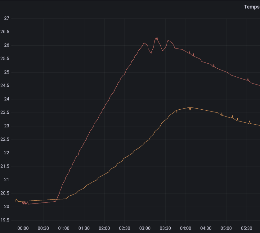

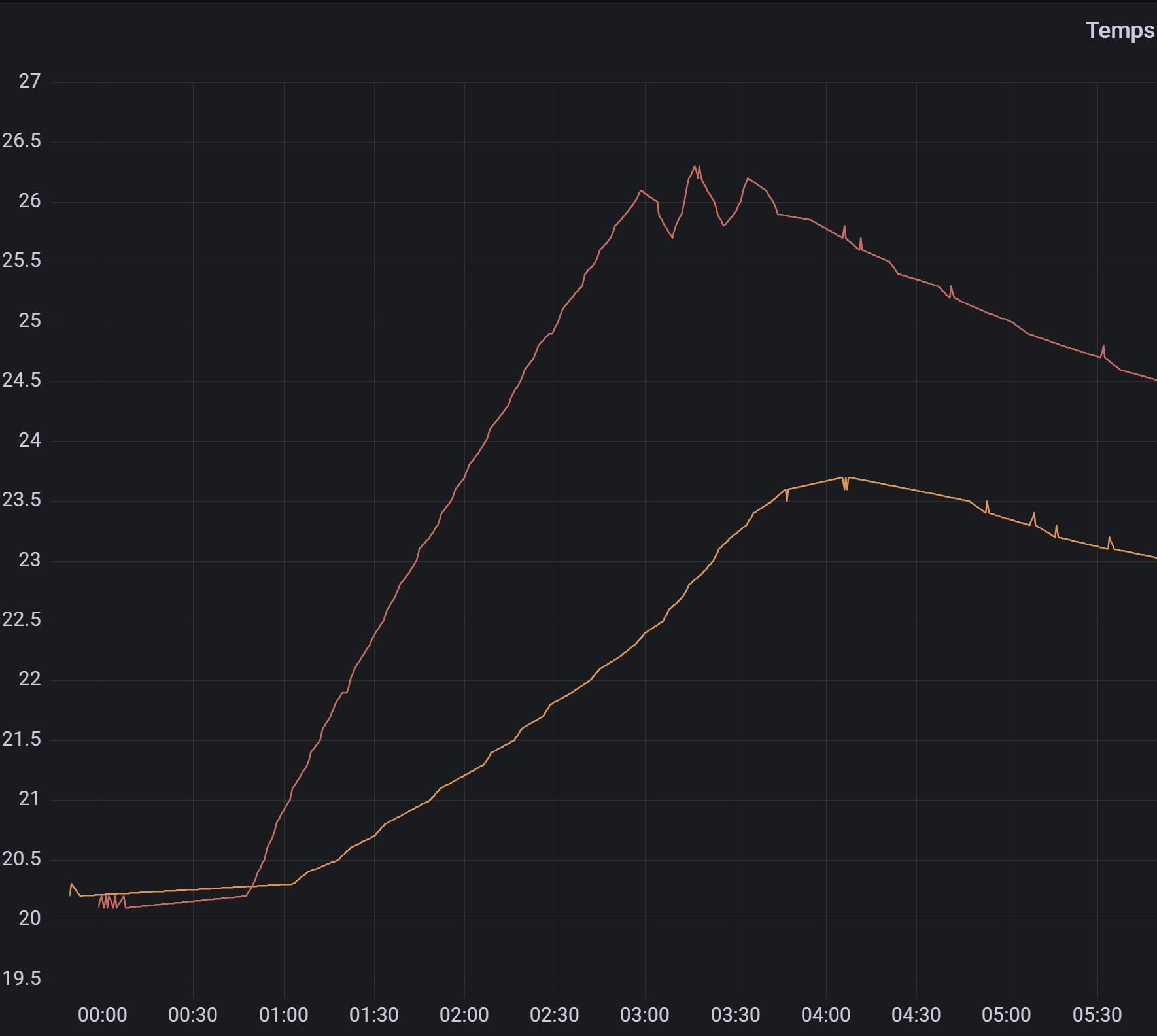

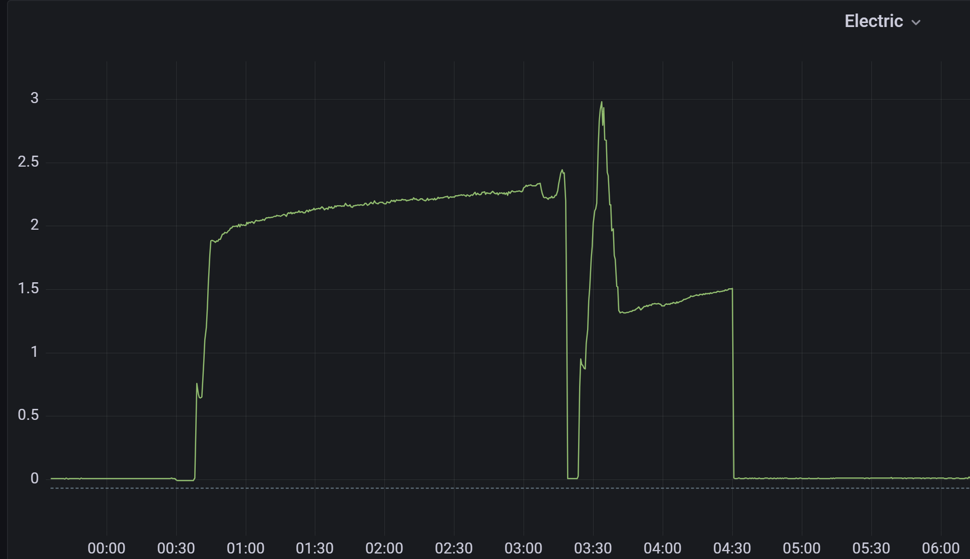

Gary68 Posted November 17, 2023 Share Posted November 17, 2023 Its probably the same as you are achieving through HA but for those who don't use automation and have an Ecodan with Melcloud who want to boost heating at a cheap fixed time it is possible through the app. If you go through to the orange heating screen in the app and press actions then timer you can can create a schedule that turns on the heatpump at the fixed flow temp your controller is set to for a certain period then reverts to weather comp at the end of that period. Link to comment Share on other sites More sharing options...
jack Posted November 17, 2023 Share Posted November 17, 2023 4 hours ago, joth said: PAW-AW-MBS-H supports H generation onwards, via the CN-CNT port. Thanks. I did look into the modbus module when buying the ASHP, but it was several hundred quid + the prospect of me having the figure out how it all interfaced with Loxone. Seemed like too much effort at the time - I may revisit at some stage, but I already have too many projects on the go! 4 hours ago, Johnnyire said: Is it not a simple solution to just increase the temperature on the loxone schedule during this period of low cost tariffs? Unfortunately (well, unfortunately for this approach), the time constant on our slab is too long for this to work. At the current flow temp settings in mild winter weather, it I turn the heating on, it takes just under three hours to show any change in temperature (+0.1 degrees). The temperature will continue to slowly rise for another three or more hours after the heating is turned off. I think the solution is just to bump of the flow temp across the weather compensation curve and experiment with how the house reacts. 3 hours ago, joth said: Just to riff on this a bit more, what I've effectively done now is create a WC curve that allows my heatpump to put in a day's worth of energy requirement in about 4 or so hours runtime. I have octopus go so having Loxone boost the room target temp between midnight to 4am pretty much ensures the ASHP just runs during cheap rate, and again a bit sometime during the day if solar gains are low. This works well enough I'm not so motivated to mess with direct control of the UFH flow temperature Thanks. If I understand you correctly, that's what I was proposing above when I said: 20 hours ago, jack said: Depending on the rate at which my slab can absorb energy, the solution may be to just increase the flow temperature across the weather compensation curve. That might be enough to get me over the line. The problem I have is modelling all of this. I may just need to try it out when it gets colder. There'll be some experimentation involved, but it's an interesting project, plus I can start working on it now even before I'm back on the cheap overnight rate. Link to comment Share on other sites More sharing options...
joth Posted November 17, 2023 Share Posted November 17, 2023 @jack got it that all makes sense. Sorry you've ended up explaining each point 5 times lol. Our UFH is in just 75mm screed which is pretty good to freewheel a constant temperature through the day, but also fairly fast responding when we do heat it so boosting the room setpoint does work ok for cheap rate. It's a fairly simple regression analysis to work out the daily kWh input needed for a given outdoor temperature, so sooner or later ASHP will have learning thermostats that solve this in a nicer way. 1 Link to comment Share on other sites More sharing options...
joth Posted November 17, 2023 Share Posted November 17, 2023 4 hours ago, Gary68 said: Its probably the same as you are achieving through HA but for those who don't use automation and have an Ecodan with Melcloud who want to boost heating at a cheap fixed time it is possible through the app. If you go through to the orange heating screen in the app and press actions then timer you can can create a schedule that turns on the heatpump at the fixed flow temp your controller is set to for a certain period then reverts to weather comp at the end of that period. interesting point. I've always been put off playing with this on the basis the schedule is entirely driven from the cloud so an outage will leave it in an odd state. (And, it's in competition with the FTC6 built in schedule function and the schedule in my HA). you're right though this is the easiest way to set variable flow temp. (The other would be to abuse the zone 1 vs zone 2 settings, have them both plumbed to a single set of emitters but switch between which one calls for heat based on time of day. No good for me though as I need the dual zones for its intended purpose, as i have different zones for UFH vs FCU) Link to comment Share on other sites More sharing options...
Adrian Walker Posted November 17, 2023 Share Posted November 17, 2023 29 minutes ago, joth said: interesting point. I've always been put off playing with this on the basis the schedule is entirely driven from the cloud so an outage will leave it in an odd state. (And, it's in competition with the FTC6 built in schedule function and the schedule in my HA). you're right though this is the easiest way to set variable flow temp. (The other would be to abuse the zone 1 vs zone 2 settings, have them both plumbed to a single set of emitters but switch between which one calls for heat based on time of day. No good for me though as I need the dual zones for its intended purpose, as i have different zones for UFH vs FCU) Have a look at what @TerryE is doing with regards to Octopus and planning his heating and hot water based on the very cheap rates that they publish 24 hours in advance. Link to comment Share on other sites More sharing options...
