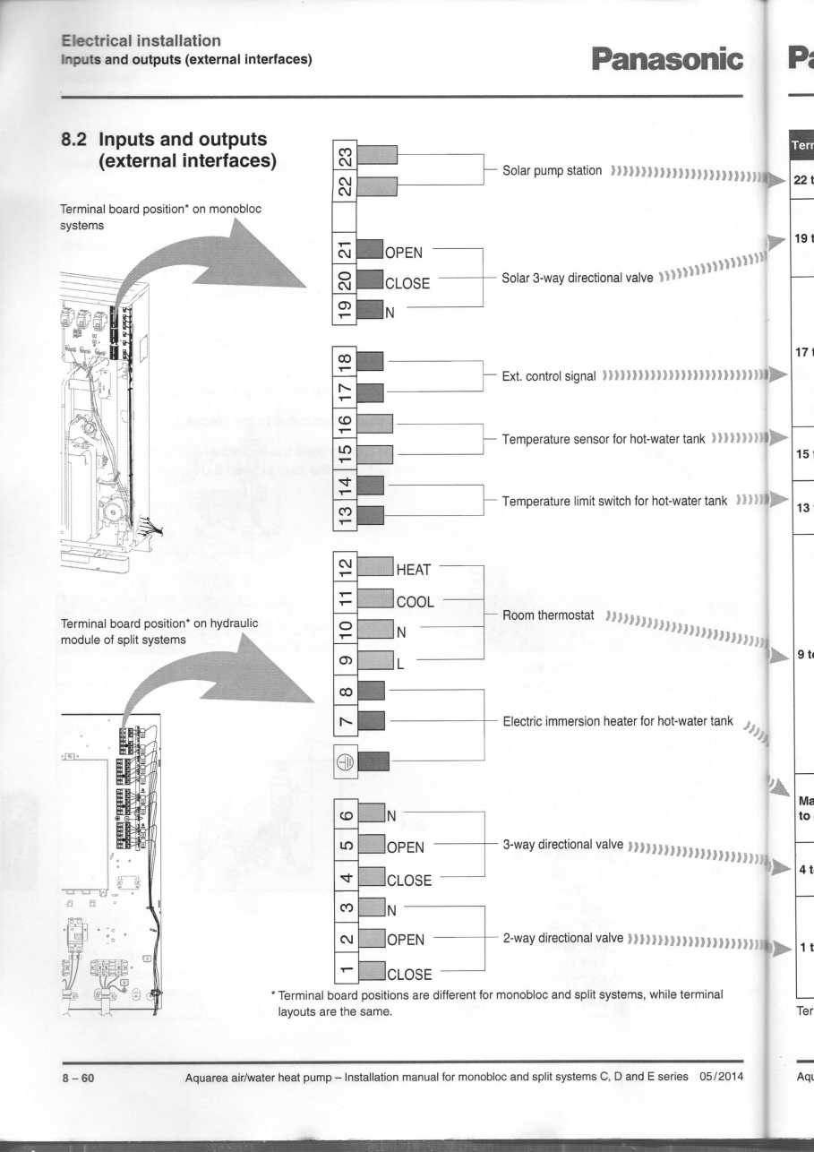

JohnMo Posted November 16, 2023 Posted November 16, 2023 1 hour ago, siletto said: main question is, does a modern, well-built and commissioned heat pump system need high-priced control equipment to run with good comfort, or stick with a good weather compensation setting I have a thermostat, but could just as easily be a time switch as it does little or no temperature control. That's it a 3 way diverter to the cylinder or UFH, no buffer. Any cooling is done via UFH circuits. All done via WC. ASHP modulates it's output based on return temperature without any interference from me. Are you sure you need 9kW with a 155m2 house?

jack Posted November 16, 2023 Posted November 16, 2023 4 minutes ago, JohnMo said: Heat pumps even quite basic ones, normally have a dual set point option, that is selected via an open/closed zero volt switch. Dual, or double set point have seen in lots of manuals. Normally need an external switch or relay to operate. If you have a simple time switch or smart relay - done. I wish it were so, but here're all the inputs and outputs for my unit: There is an offset function that moves the weather compensation curve up or down by up to 5 degrees, but that's something you set manually via the controller.

JohnMo Posted November 16, 2023 Posted November 16, 2023 14 minutes ago, joth said: What am I missing? He is wanting the heat pump to output a higher temperature that it's currently programmed to do. So instead of flow say 30 degs, increasing to 32 during cheap rate. Lexone will manage house temp, not flow temperature.
jack Posted November 16, 2023 Posted November 16, 2023 Just now, JohnMo said: He is wanting the heat pump to output a higher temperature that it's currently programmed to do. So instead of flow say 30 degs, increasing to 32 during cheap rate. Lexone will manage house temp, not flow temperature. Correct. Loxone calls for heat, and there's some (programmed) flexibility about how that happens, but flow temperature (including weather compensation) is set by the ASHP controller. Ideally I'd have Loxone control the flow temperature too, based on various current and predicted temperatures and the availabilty of cheap power (overnight) or free power (occasional excess PV during winter), but that isn't possible with my current setup. Depending on the rate at which my slab can absorb energy, the solution may be to just increase the flow temperature across the weather compensation curve. That might be enough to get me over the line. The problem I have is modelling all of this. I may just need to try it out when it gets colder. 23 minutes ago, joth said: Or, use the Excess Heating input on a Climate Controller loxone block I've thought about using this in the past, mainly for when there's excess PV but the house is already up to temperature. The main issue is the very long time constant of my slab. I'm sure there's a way to program in some guardrails to make it work though.
