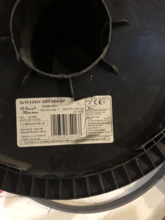

Pocster Posted November 16, 2023 Author Share Posted November 16, 2023 Finally managed to get hold of my sparky ! He wants 3 separate 10mm to each appliance Link to comment Share on other sites More sharing options...
Mattg4321 Posted November 16, 2023 Share Posted November 16, 2023 1 minute ago, Pocster said: Finally managed to get hold of my sparky ! He wants 3 separate 10mm to each appliance 10mm is overkill unless run through a shedload of insulation. 6mm is enough when you use the diversity calculation for every domestic cooking appliance I’ve ever fitted (a lot!) 1 Link to comment Share on other sites More sharing options...
Pocster Posted November 16, 2023 Author Share Posted November 16, 2023 (edited) 3 minutes ago, Mattg4321 said: 10mm is overkill unless run through a shedload of insulation. 6mm is enough when you use the diversity calculation for every domestic cooking appliance I’ve ever fitted (a lot!) In his voicemail he said 6mm is ok - but would want to know the loading of each appliance. I have no 6mm but I do have plenty of 10mm so might as well use it . He also preferred 10mm for “ future expansion “ Edited November 16, 2023 by Pocster Link to comment Share on other sites More sharing options...

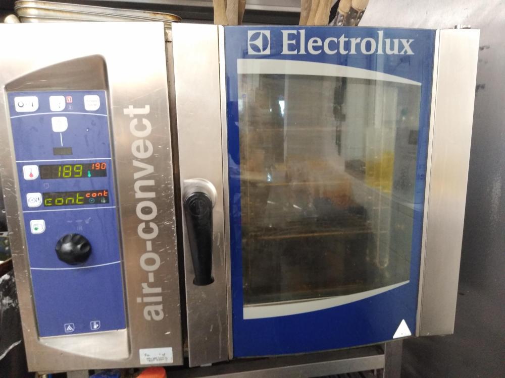

SteamyTea Posted November 16, 2023 Share Posted November 16, 2023 6 hours ago, Thorfun said: 2 x ovens for cooking meals in. also one child has an allergy so for some foods we need to cook separately Here is my oven. Can easily do 250 meals in a day, including the fussy eaters and the genuine allergy people. Link to comment Share on other sites More sharing options...
Mattg4321 Posted November 16, 2023 Share Posted November 16, 2023 2 hours ago, Pocster said: In his voicemail he said 6mm is ok - but would want to know the loading of each appliance. I have no 6mm but I do have plenty of 10mm so might as well use it . He also preferred 10mm for “ future expansion “ Nothing wrong with 10mm, but I prefer not to as it’s awkward to work with and costs more! As you have it though and it’s what your sparks wants it’s a no brainer! Electric showers on the other hand I always always fit 10mm 1 Link to comment Share on other sites More sharing options...
Thorfun Posted November 16, 2023 Share Posted November 16, 2023 1 hour ago, Pocster said: In his voicemail he said 6mm is ok - but would want to know the loading of each appliance. I have no 6mm but I do have plenty of 10mm so might as well use it . He also preferred 10mm for “ future expansion “ you've really gotta go with what your sparky wants tbh. but take a look at https://www.tlc-direct.co.uk/Technical/Charts/VoltageDrop.html and you can calculate the minimum cable size for the distance of cable. Link to comment Share on other sites More sharing options...
Thorfun Posted November 16, 2023 Share Posted November 16, 2023 44 minutes ago, SteamyTea said: Here is my oven. Can easily do 250 meals in a day, including the fussy eaters and the genuine allergy people. not really very wife friendly on appearance though Link to comment Share on other sites More sharing options...
SteamyTea Posted November 16, 2023 Share Posted November 16, 2023 13 minutes ago, Thorfun said: not really very wife friendly on appearance though There are married women that work in catering. Though all the ones I have worked with recently are divorcees. Link to comment Share on other sites More sharing options...

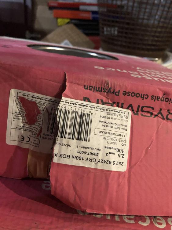

Pocster Posted November 17, 2023 Author Share Posted November 17, 2023 Got the 3 10mm cables through one at a time . They are buggers ! . Still got the 2.5mm kitchen socket ring to do - but that should be easy enough I think . Link to comment Share on other sites More sharing options...
