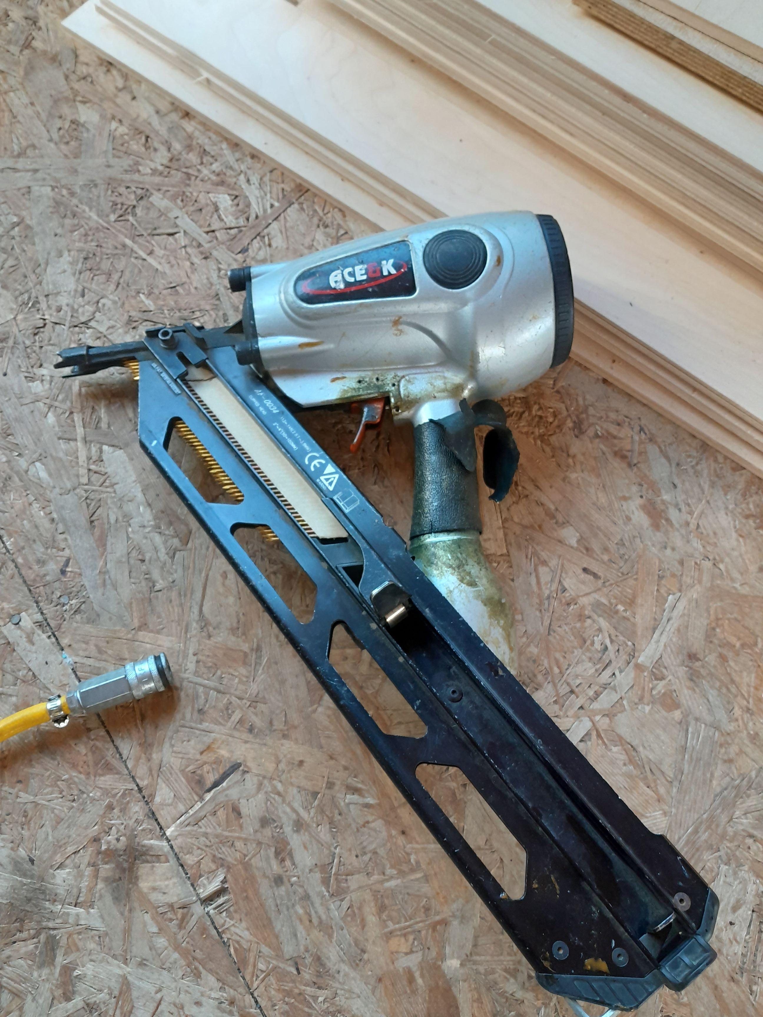

SimonD Posted April 18 Share Posted April 18 22 minutes ago, SteamyTea said: But then I learnt about them and they are fantastic fixings for timber. My absolute favourite tool of the build, one of a growing collection. Does everything from 90mm ring shank framing nails to full head stainless for cladding. Still need a hammer, mind you.: 1 Link to comment Share on other sites More sharing options...
Iceverge Posted April 18 Share Posted April 18 I love hammering nails. As I understand it they are less prone to sudden sheer failure than screws. You can get special screws now that are fit to replace nails in joist hangers for example. These might be the "high" quality space screws mentioned above. As for the BCO disregarding the SEs design, they will probably become believers after the screwed joint is still in place in 50 years. Frustrating for you but that's the way most knowledge on building seems to become accepted. 1 Link to comment Share on other sites More sharing options...
