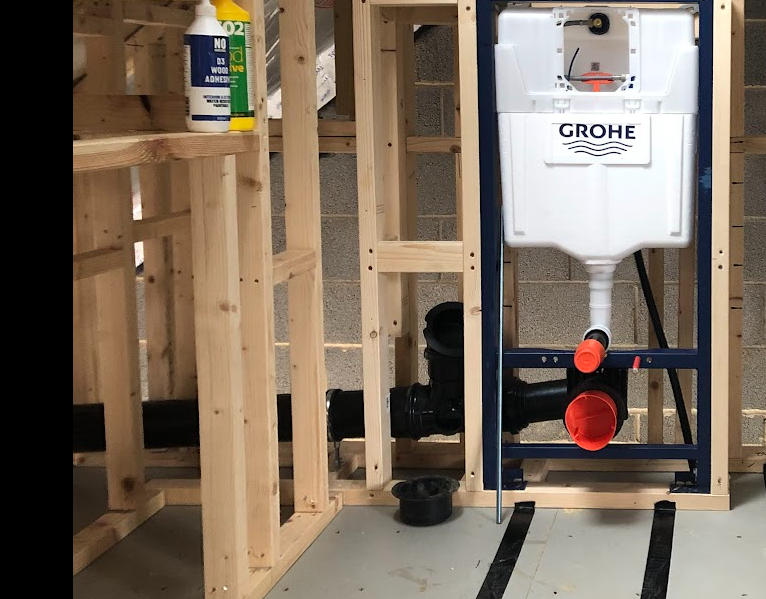

crispy_wafer Posted October 30, 2023 Share Posted October 30, 2023 38*63 (2*3) would be fine. What i used for this 2 Link to comment Share on other sites More sharing options...

johnhenstock83 Posted October 31, 2023 Author Share Posted October 31, 2023 ah, I see. thanks for explaining how it works, I thought CLS was your typical international standard. so yes, it's a 3 x 2 then, and I'm planning to use it for a frame much simpler than the one posted above. I trust it will be strong enough. do I lay the flooring first (tiles) or build the frame directly on the solid concrete floor? if the latter, do I need a DPC under the timbers? there's no damp in the house. thanks Link to comment Share on other sites More sharing options...
