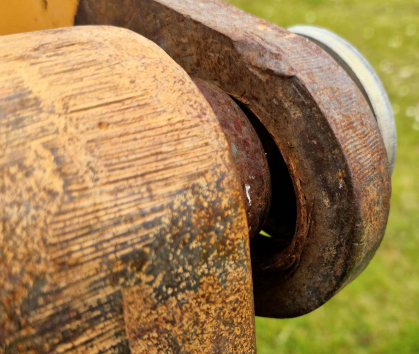

Duncan62 Posted October 25, 2023 Author Posted October 25, 2023 Day light in the pins... this is what worn pins look like presumably?!
markc Posted October 25, 2023 Posted October 25, 2023 1 minute ago, Duncan62 said: Day light in the pins... this is what worn pins look like presumably?! That’s either a very worn pin or the pin has moved and come out of the boss (hole). Excavators take some hammer so pins do wear and holes elongate, link rods and bars are easy to change, pins are pretty low cost but stretched, oval holes in boom or arms are an expensive repair if needed 1
Alan Ambrose Posted October 25, 2023 Posted October 25, 2023 >>> pins are pretty low cost but stretched, oval holes in boom or arms are an expensive repair if needed Your local machine shop may be able to fix these btw. For some diversion, watch Cutting Edge Engineering on YT to see how the Aussies do it .

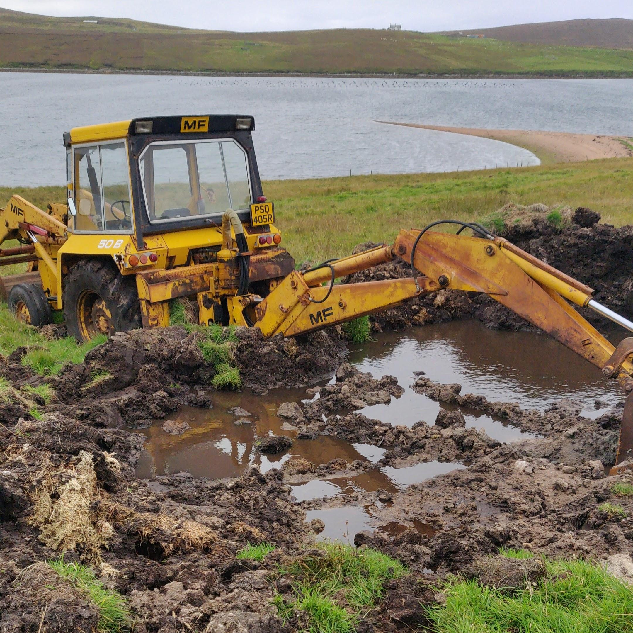

Galileo Posted October 30, 2023 Posted October 30, 2023 On 22/10/2023 at 16:15, joe90 said: Well it was a gamble but it paid off for me, yes it leaked hydraulic oil and all joints were worn but I got used to it. I think I paid about £6k plus VAT (about 8 years ago) and sold it for £4k after about 4 years work 🤷♂️ local engineers supplied parts and mended it when a few things (diesel pump) got clogged. , it’s certainly a man’s toy (tin hat on). Did I mention it turned up the ground? And ours was very wet at times….. (I did get it out) They do that up here very well too, damp soggy peat bog and 6t of Manchester's finest from 1976 was not a good mix! Maintenance costs have been 20l of ISO 32 (one front ram leaks a bit when hot and holding up a few tonnes in the bucket), steering track rod ends replaced as they were a bit loosey goosey and a new exhaust. It's not perfect though by any stretch, things to fix are that one ram needs resealing, the king pin bushings on the back actor boom have gone a bit oval like above, local engineer suggests it's no drama, they'll just bush it. When I say no drama, it has to come off of course. Incidental items like rear wind screen wiper motor not working, heater stuck on heat (not such an issue at this time of the year), one mirror missing, some rusting under the side windows and it's done enough hours for an oil and filter change all around. Cost me £5k including all the shipping costs to get it up here, drove it 25 miles from the port including one ferry, and it then set to work digging a 200 metre track through peat down to the hard, then moving 400 tonnes of stone that was dumped at the top. My only regret was not checking that it came with a grading bucket. I've had a few people up here ask me for first refusal if I ever come to sell it.
