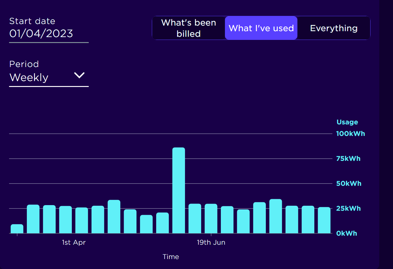

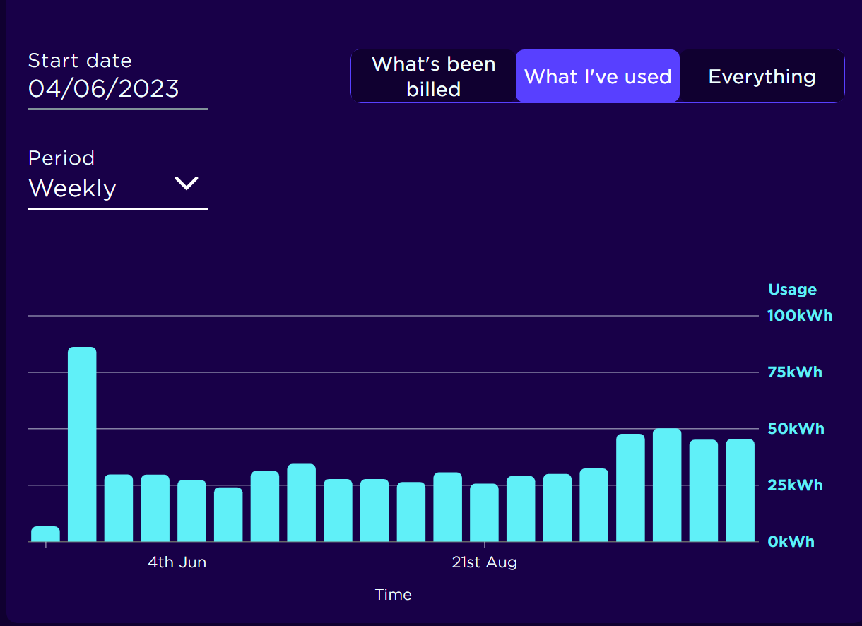

JohnMo Posted October 17, 2023 Posted October 17, 2023 On 16/10/2023 at 21:46, Paene Finitur said: Hmm, I kind of agree with you there. There's still too many places where we don't yet have curtains up to keep some of the heat in. But that can't be the full story. During the period over the summer this year, our consumption according to Octopus has never really gone below 150kWh per week. That's at a time when all the stats were switched to freeze protection i.e. the heating was effectively off. It seems that the ASHP is the culprit but I'm at a loss to know how it's taking up so much power for effectively just heating the hot water. Expand @joth was quoting for heating only, you need to compare apples with apples. I take it you're is total electric usage. Your 151kWh in summer is your house usage and DHW which is 21kWh per day, which is high. But is high normal(ish) house. Our average electric last your without a heat pump was 13kWh. Have since been around the house understood where the energy was going and fix it, that what you need to do also.

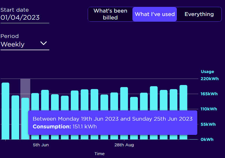

Conor Posted October 17, 2023 Posted October 17, 2023 What other electrical appliances do you have that could maybe be faulty and consuming large amounts of electric? Tho with that consumption there would be a lot of waste heat generated and fairly noticeable in the summer. You could completely isolate your ashp and DHWC for 24hrs and monitor the house consumption.
ReedRichards Posted October 17, 2023 Posted October 17, 2023 Do you have any of: Swimming pool? Hot tub? Electric Aga? I would have thought that just using an immersion heater you would be hard-pressed to use 150 kWh per week heating your hot water. If you were heating water from 10 C to 60 C using an immersion heater you would be using over 2500 l of hot water per week to consume 150 kWh. That's possible but your household would need to be taking several baths per day, in which case you would have had a big fuel bill in your previous property however it was heated.
joth Posted October 17, 2023 Posted October 17, 2023 If you have the indoor display unit, you can look at the live power draw on it, and slowly turn all the circuits off in the consumer unit one by one noting how much the power draw drops by when each is isolated. Probably you'll find some background power hog on a ring main so repeat the process turning off each device on that ring one by one. If it's a lively house with lots of people and change expected, investing in a multi circuit monitor maybe we'll worth it. E.g. https://www.amazon.co.uk/3-Phase-Emporia-Electricity-Metering-Conserve/dp/B08CJ3VC79/ Even so, we're talking about the 150kWh summer base load, that 500kWh heating load in winter far outweighs it.
JohnMo Posted October 17, 2023 Posted October 17, 2023 You will be amazed at standby losses add up. Our TV, set top box when in standby mode are using 17W, so multiply by 24hrs and 7 days, gets you to 3kWh. If you have the same in a 3 bedrooms and the lounge, that 12kWh just on that. If your DHW isn't set correctly your immersion could be kicking on for an hour a day, that another 21kWh for the week etc..1
Ferdinand Posted October 17, 2023 Posted October 17, 2023 On 16/10/2023 at 21:46, Paene Finitur said: Hmm, I kind of agree with you there. There's still too many places where we don't yet have curtains up to keep some of the heat in. But that can't be the full story. During the period over the summer this year, our consumption according to Octopus has never really gone below 150kWh per week. That's at a time when all the stats were switched to freeze protection i.e. the heating was effectively off. It seems that the ASHP is the culprit but I'm at a loss to know how it's taking up so much power for effectively just heating the hot water. Expand We could have some fun with these. This is mine for the same period. Single occupancy in a 205sqm house. My heating is gas, but I hardly used any in the period, and I use a heat pump for cooling. Solar generating about 5MWh per annum, exporting about 3MWh. What do you think happened 5-11th June? And the air fryer arrived 4 weeks ago...
Paene Finitur Posted October 21, 2023 Author Posted October 21, 2023 Thanks for all the amazing feedback. To answer some of the points: @SteamyTea I'm not sure that I can separate out the heating from the hot water in terms of energy use. There's a separate meter for the ASHP and one from the immersion for the header tank. We had a big spike last Christmas because the thermostat for the header tank got slightly dislodged resulting in the ASHP having to work much harder and the immersion kicking in to make up. Thankfully, that got solved. @JohnMo Yeah fair point, and you're absolutely right; when I was checking last winter, the non-heating/HW electric usage was around 22KWh/day so probably mainly not the ASHP over summer. @Conor I suspect that was mostly washing machine, and also the tumble drier, which Mrs Paene Finitur insists on using. There are 6/7 of us living here though, with two of us working from home regularly so I suspect it's probably not that unreasonable, though I will look at the stand-by issue. Thinking of getting this or something like it round the back of the TV. @ReedRichards I don't have a swimming pool, hot tub or electric Aga. We have a dual rangemaster and the oven will take a chunk but is infrequently used. I guess it's the washing and drying that will take up most of it. @joth I wish I'd known about this last year when they were setting the electrics up. I have 25 MCBs on my board so slightly too many and now the trunking is in, it might make it a bit difficult but what a great device! @Ferdinand I'm guessing you had visitors in June? 😁
ReedRichards Posted October 22, 2023 Posted October 22, 2023 This device lets you monitor the energy used by any appliance and can also be used as an on/off timer https://www.amazon.co.uk/dp/B0B831STBX?ref=ppx_yo2ov_dt_b_product_details&th=1 (the pack of 2 is currently priced as only £1 more than the single). 1
Ferdinand Posted October 22, 2023 Posted October 22, 2023 On 21/10/2023 at 23:23, Paene Finitur said: Thanks for all the amazing feedback. To answer some of the points: @Ferdinand I'm guessing you had visitors in June? 😁 Expand Actually no - I had 3 weeks in hospital which started very suddenly around 19 May - straight from the GP so no time to turn anything off. For some reason my Smart Dehumidifier went beserk at the start of week 3 and stayed on until I got home. Why? I know nothing.
Paene Finitur Posted October 22, 2023 Author Posted October 22, 2023 On 22/10/2023 at 15:42, Ferdinand said: Actually no - I had 3 weeks in hospital which started very suddenly around 19 May - straight from the GP so no time to turn anything off. For some reason my Smart Dehumidifier went beserk at the start of week 3 and stayed on until I got home. Expand Ouch!! Hope you're better now. Certainly not what you want to come home to. I suppose at least you weren't bothered by humidity on you return. My de-humidifier has recently taken to tripping the MCB, which saves me quite a bit! 😁
